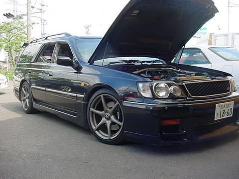

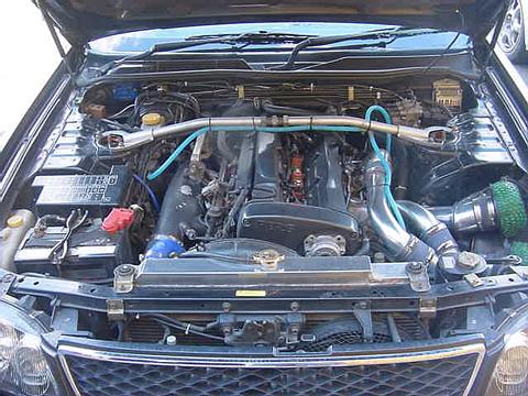

An SR20 engine having as much power as an RB26DETT (from Nissan GTR or Nissan Stagea 260RS) well.....
