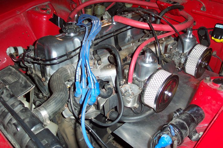

Yep, fuel system recirculates. That only keeps fresh fuel in the main lines though, not the lines to the carbs, or in the carb bowls. After 5 minutes of turning it off the carbs are that hot you can't touch them. Go for a 10min drive and they are cold again, whereas without the heatshield they'd remain hot.
I can get a small thermo fan for nothing, so I might gave that a whirl, see how it goes.
An aditional heat shield to give some more protection around the top of the carbs would help for sure. The fuel bowl is pretty well protected as is though. You can see how high it comes a bit better in the attached pic. An additional layer of some sort of insulating material on the heat shield should also help.
One thing I have noticed is that when I get this vapour lock problem, I get some overflow from the fuel bowls. Would that point to the fuel boiling in the fuel bowl?

Yes the heat would expand the petrol in the bowl and may cause the engine to flood. Hard to hot start? Flattening the accelerator when its cranking over could help.

I had similar probs. Although mine don't seem as bad as datto-zeds, mine would never die, just hesitate. Also wasn't as severe on hot restart. I have electric RX7 fuel pump, recirculating fuel line, etc. I have a non-vented hood and round top SUs. I was experiencing a hesitation only after engine got to working temperature and was a hot day 35C+, and only after car had been at idle (set of lights etc).
Fuel pump - didnt fix
Ceramic coating - helped but didnt completely solve.
Insulated fuel float bowl - helped
Insulated rubber fuel line from rail to carb - Huge difference
With all these, the problem is gone in normal driving condidtions. (Yeah even in our summer). I'm currently looking at ways to insulate the fuel rail without having it look pig ugly (a la foil wrap etc).
I'll post pics of the bay when I get them back. The only visible insulation is the pipe around the fuel line. But looks suprisingly good! :classic:
A thing to note is that I do not have a heat-shield of any type! (Only a 6mm closed-cell foam with aluminium foil backed insulation on float bowl.)

Hmmm never thought of that, but it makes sense.....I'll try insulating those lines tomorrow. I did notice it gets rather hot. Being black and with a much larger surface area than the metal lines would make them significantly hotter. What material did you use to insulate them?
The lines were the last thing i did. I used a expanded nitrile rubber pipe insulation. Commonly used round hot water systems. Usually called Armaflex or Superlon. I got mine thru work cheap, but you should be able to pick it up for bout $6-7/mtr. Fire retardant, good resistance to fuels/oils, I'm trying to find it in the right size for the fuel rails, to cover them indervidually, rather than slap a big one over it all.
