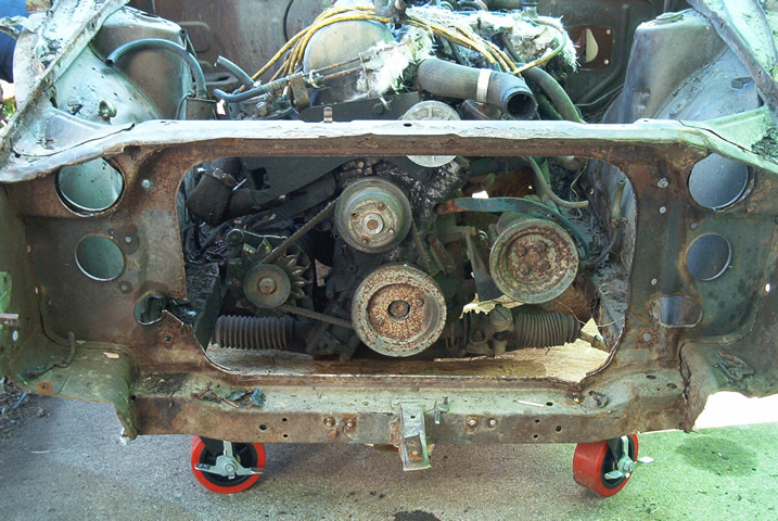

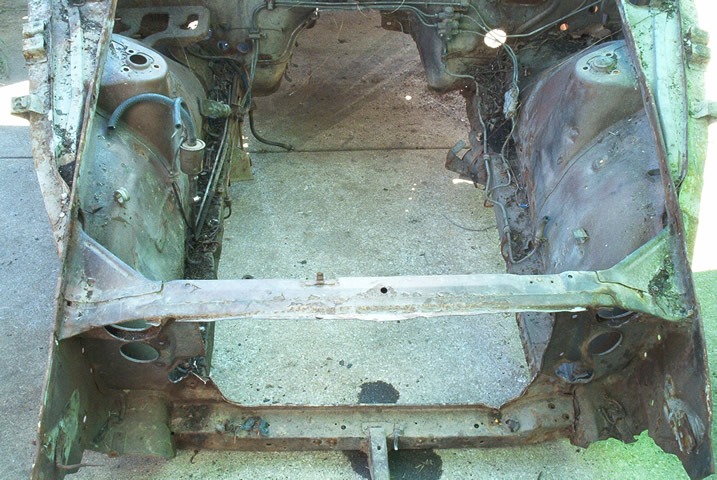

This is probably not the wisest advise (official disclaimer :nervous: ), but if you are talking about a parts car and you have an extra pair of hands, the engine/tranny can come out through the bottom rather than the top. I guess you would need something suitable to put them on underneath to wheel them out (like in the photo).
Hopefully the picture is attached...
And it's out...

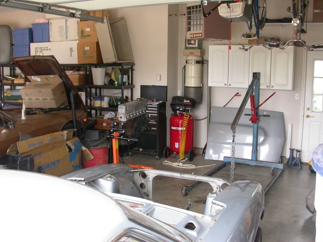

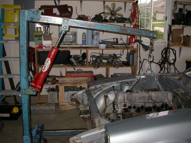

Can't let Chloe beat me with pictures! :geek: Here's my engine hooked up to the hoist. When you lift it, the weight of the transmission pulls the back end down and allows you to angle the transmission down at the back and the front of the engine up. I left the transmission mount attached to the car and detatched it from the transmission. That was probably the hardest part - dragging the rear of the transmission off the mount as it came forward. Probably a better way to do that.

Not only does Mark have good advice, but his car looks A LOT better than mine, eh? LOL
I think the one in my photos almost competes with the yellow one St. Stephen posted pics of last week...not much metal left.:cry:
