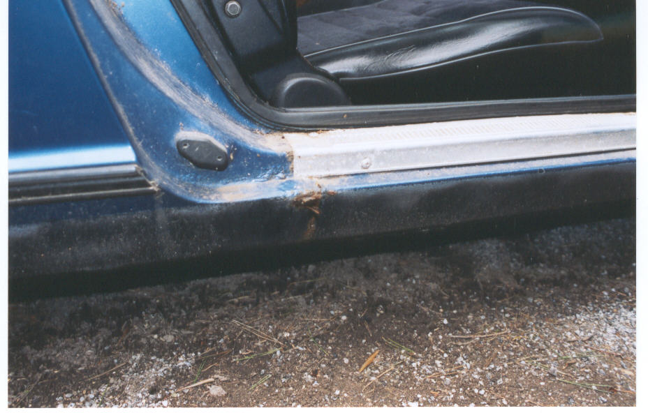

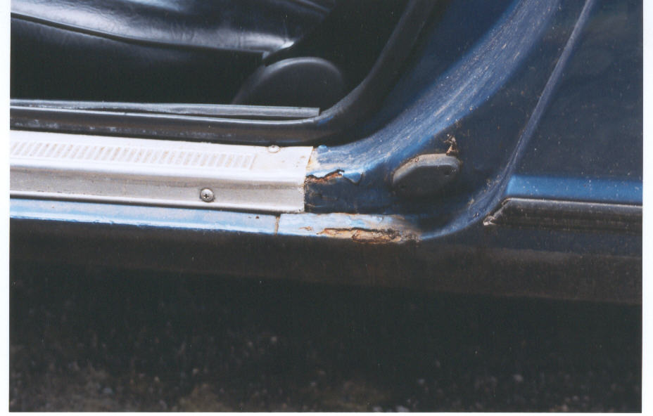

Originally posted by Bpaccaud
what did you thinks about this pictures???? could i found the same things behind????
Any rust along the bottom curves of your rockers? Mine rusted out along the bottom sides, back near the wheel well, and under the front fender where the stupid drains pour out. If you don't have any bubbling of the paint on the rockers as they curve down toward the bottom of the car, then you are likely to be in better shape than me. I'd at least poke at your rust areas with something, though. If you can go through them with a screwdriver, then you'll have similar problems. I had an actual hole from the rear wheelwell into the rear rocker too, which would have been letting water get inside there for who knows how long.
Good luck.
the right side is baddest because the rust down under the rocker panel and is more deep...
but i thinks this car will give me more surprises when i will begin the big works... we will see
