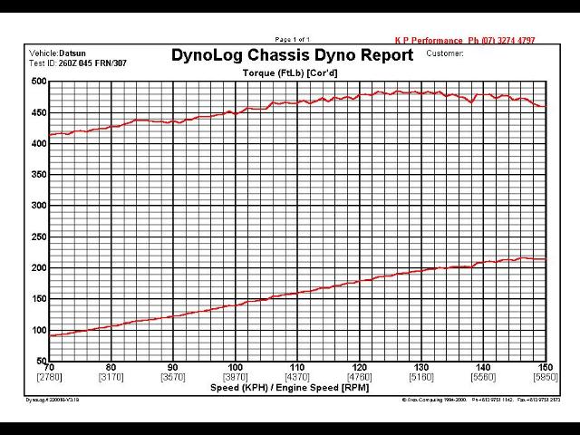

3.0 quad cam turbo from a Leopard, R200 3.9 LSD, 300Z front disks and calipers, Skyline rear disks and calipers, Intercooler, 11p.s.i. boost, 209kw (271 hp) at the back wheels, 3 inch exhaust, Howe leather interior, 300z electric seats, electric windows, lots of soundproofing, koni adjustable coil overs with lowered selby springs, thicker front sway bar and removed rear sway bar, willwood adjustable brake bias bar, Speco Thomas silver face guages, Simmons B45's, 235/60 rear tyres, 225/60 front tyres, all the RUST cut out of it and replaced with new metal.

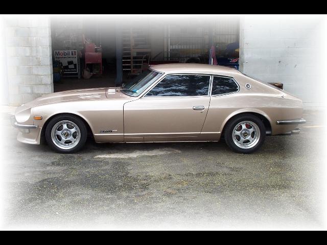

Just reiterating on what Mike's said she is amazing!!
The rear of the 2+2's make the car look a bit like a Jaguar XJS at the rear, well from the angle of your pic Big Mac it does a bit.
Thank you for the comments, it is good to see that the 2+2 is still appreciated even by the 240z crew.
