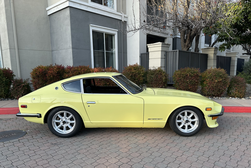

Mike R sent us his 1971 Datsun 240Z from North Carolina for mechanical sorting, Z Car Garage-style. Our Z Car Garage CV AxlesZ Car Garage Big-Brakes, Z Car Garage KW V3 coil-overs and CD009a Six-Speed transmission transformed this S30.

He purchased an RB25-powered 240Z and called us asking ‘hey do you think we could kinda do what you guys typically do to these cars?’ and I said absolutely. The Z was shipped to San Jose, Ca and we installed our ZCG Big-Brakes (Stoptech), our private label KW V3 coil-over setup and ZCG CV Axles. We just did as much as possible to correct things with the install of his RB25 and it was a fun project.
