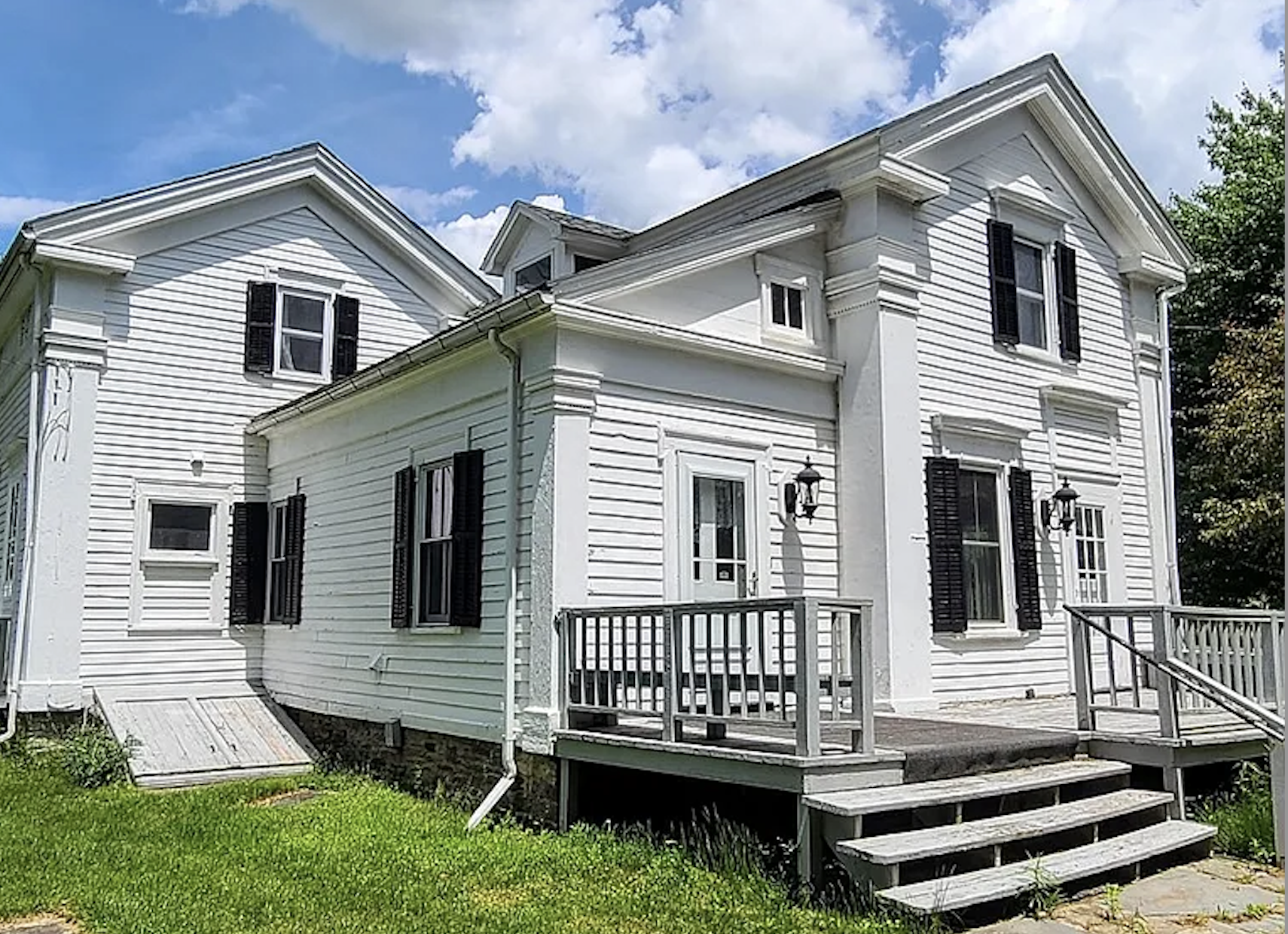

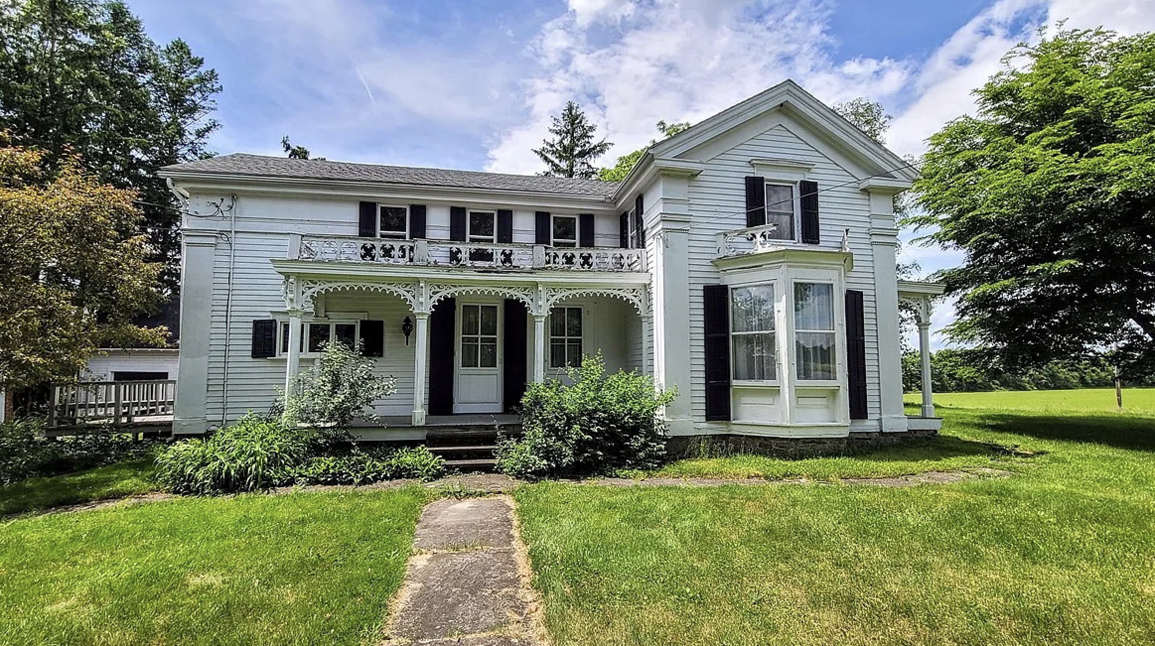

September 3, 2024Sep 3 Author comment_668888 Looking at houses around Ithaca, NY. Saw a bunch yesterday & today, one we thought was the most hopeful turned out to have too many structural issues. So far, the one that we like the most is a little on the outskirts of the distance from downtown that we wanted. 1860's, has enough rooms for us & my Mum, but would need some internal re-arranging to give her her own space, which has to be the ground floor. Garage is big enough for me to work with for starters. needs some work on the outside, but nothing crazy. Sits on 4 acres. Still have to look this one over inside, didn't have time for this one today. small building on the left is a smokehouse.   Edited September 3, 2024Sep 3 by HusseinHolland Link to comment https://www.classiczcars.com/forums/topic/68659-475-datsun-280z-leaf-green-ca-market-250k-miles-long-term-project-032023/?&page=20#findComment-668888 Share on other sites More sharing options...
September 3, 2024Sep 3 comment_668890 Lots of exterior trim, rot could be an issue. Looks like it's had several additions Electrical could need updating Pretty ginger bread work. My wife has always wanted one like that Link to comment https://www.classiczcars.com/forums/topic/68659-475-datsun-280z-leaf-green-ca-market-250k-miles-long-term-project-032023/?&page=20#findComment-668890 Share on other sites More sharing options...
September 3, 2024Sep 3 Author comment_668891 3 hours ago, Patcon said: Lots of exterior trim, rot could be an issue. Looks like it's had several additions Electrical could need updating Pretty ginger bread work. My wife has always wanted one like that Yeah - at least the upper balustrade(?) has rotted away, probably more. We are going back in about month to look it over. Link to comment https://www.classiczcars.com/forums/topic/68659-475-datsun-280z-leaf-green-ca-market-250k-miles-long-term-project-032023/?&page=20#findComment-668891 Share on other sites More sharing options...

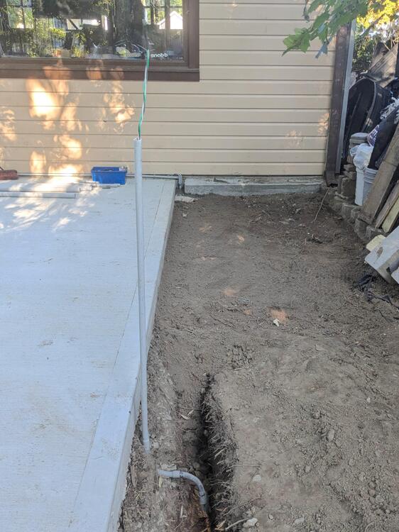

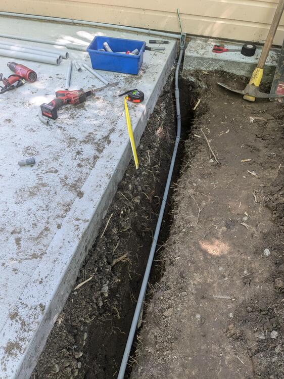

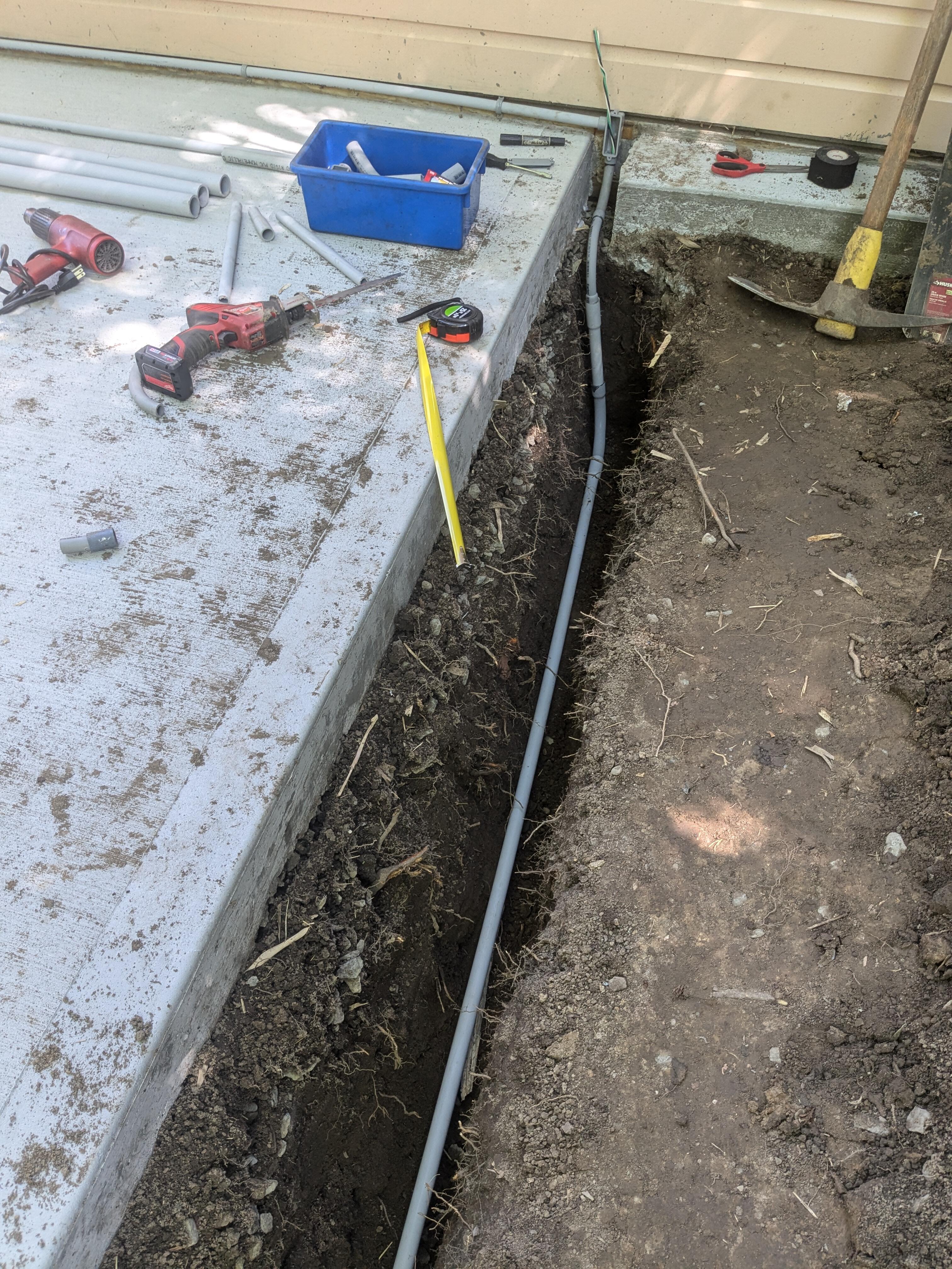

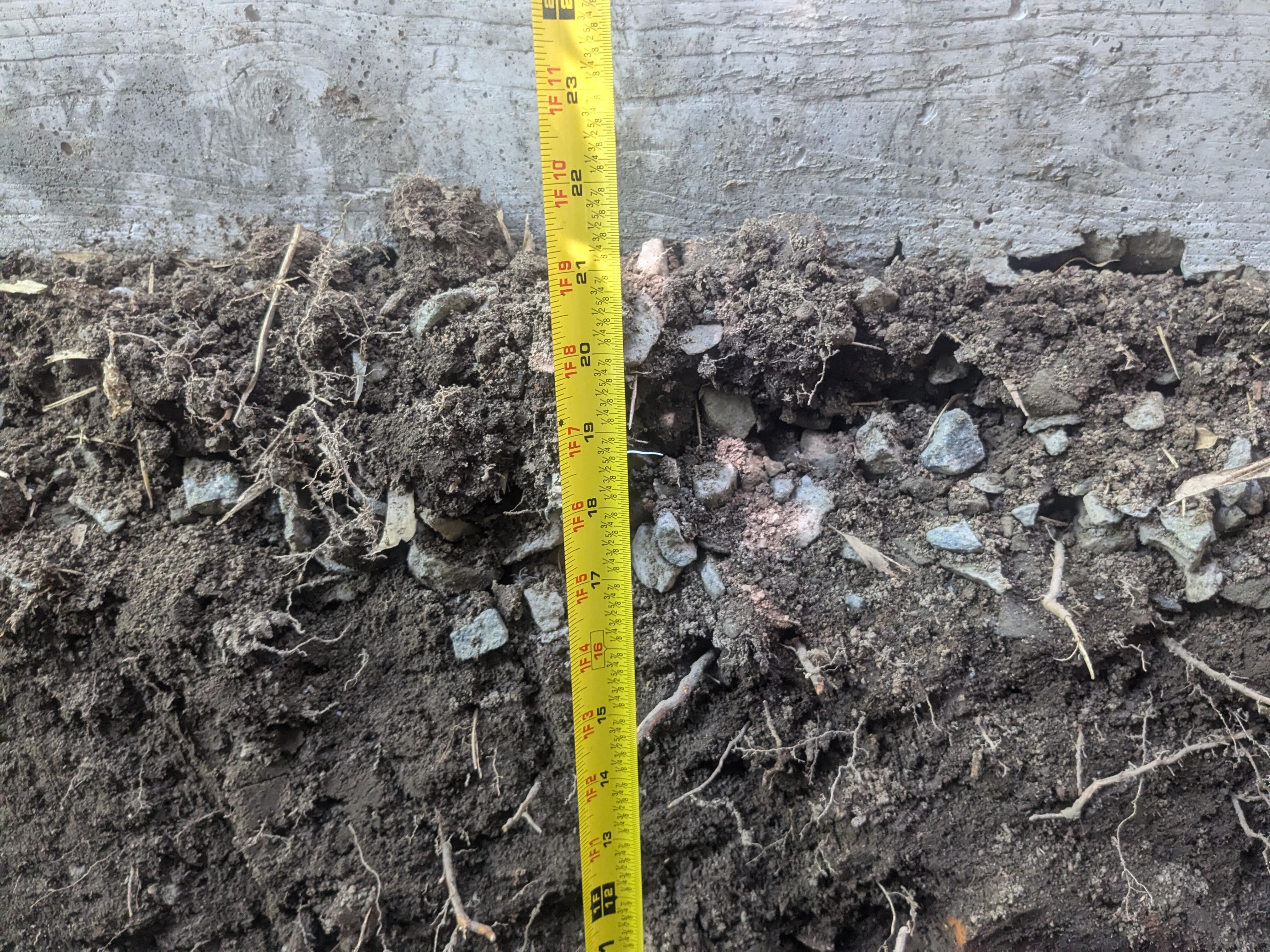

September 4, 2024Sep 4 Author comment_668920 Worked on running conduit & 12/2 for the receptacles. Dug a 18" deep 20'  trench along the South side for it. Still have to dig a trench along the West side  Edited September 4, 2024Sep 4 by HusseinHolland Link to comment https://www.classiczcars.com/forums/topic/68659-475-datsun-280z-leaf-green-ca-market-250k-miles-long-term-project-032023/?&page=20#findComment-668920 Share on other sites More sharing options...

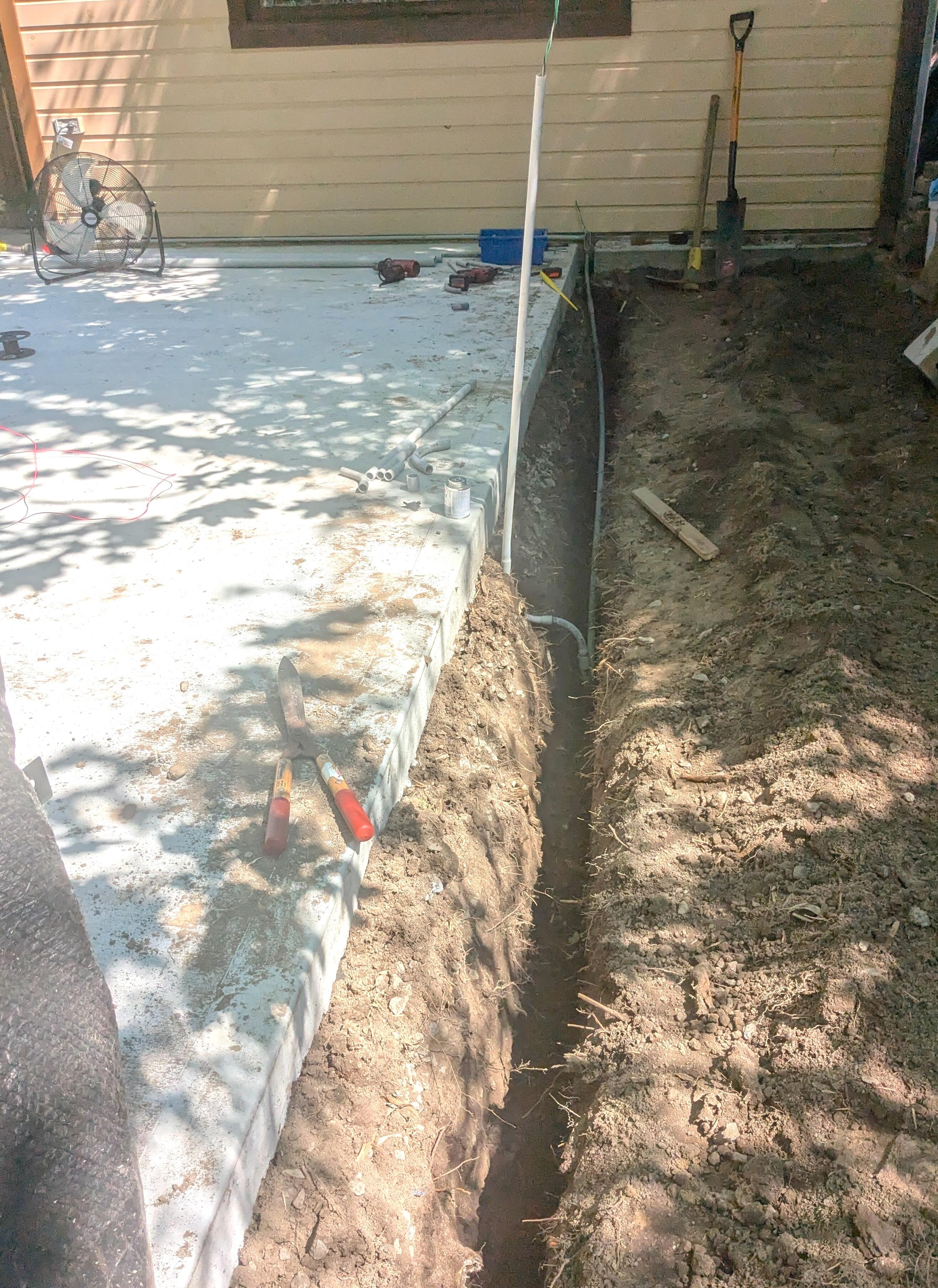

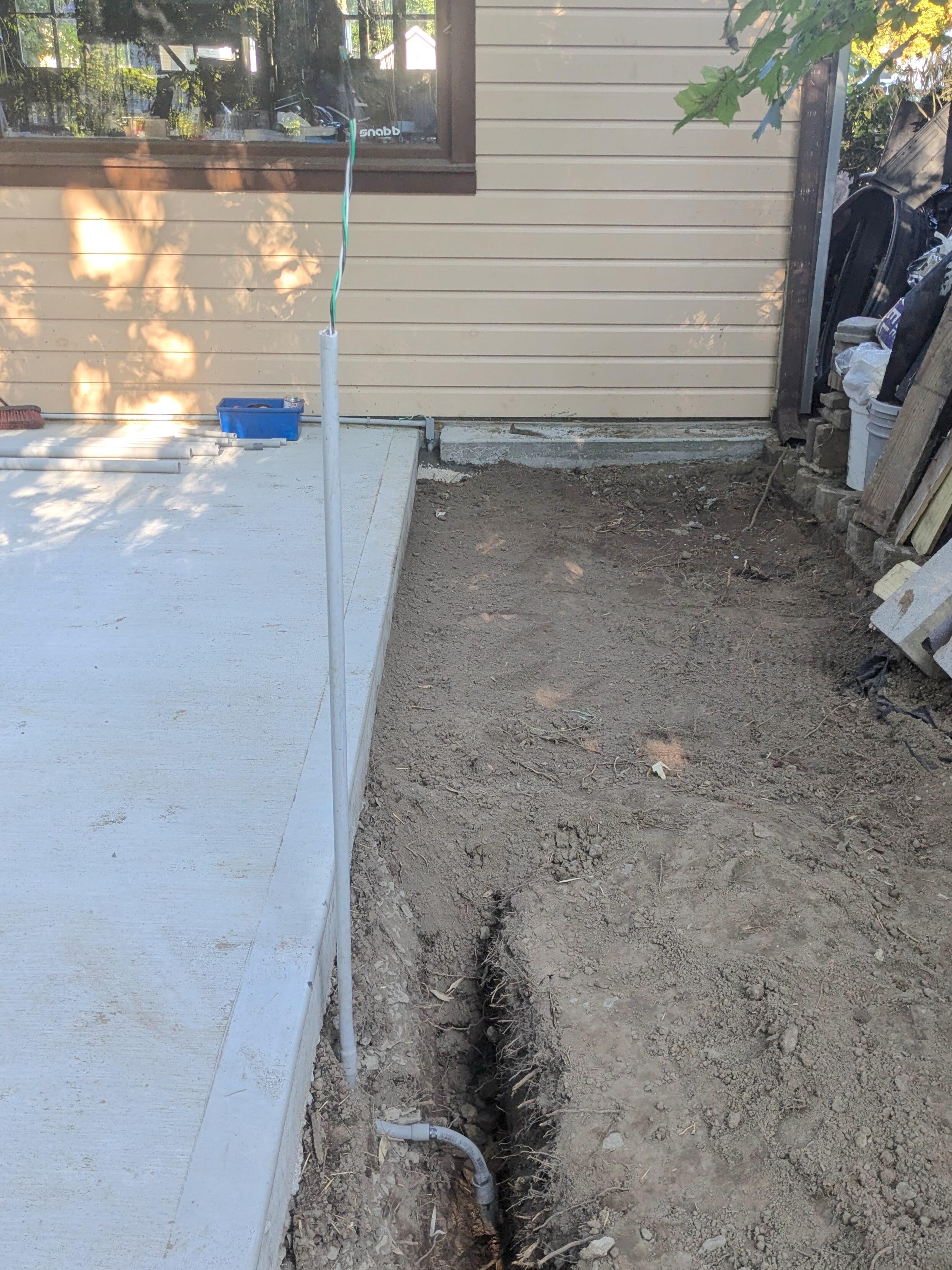

September 5, 2024Sep 5 Author comment_668951 Dug the rest of the trench around the West side, and run the conduit. I had forgotten to order more 12/3 solid THHN, so I ran a snake so I can pull through the wire through tomorrow. connected the first leg to the feed off the receptacle 1st post in place, I'll remove the cap to feed the second run through Started packing the trench & grading the ground away from the patio - this area has always held water. Link to comment https://www.classiczcars.com/forums/topic/68659-475-datsun-280z-leaf-green-ca-market-250k-miles-long-term-project-032023/?&page=20#findComment-668951 Share on other sites More sharing options...
