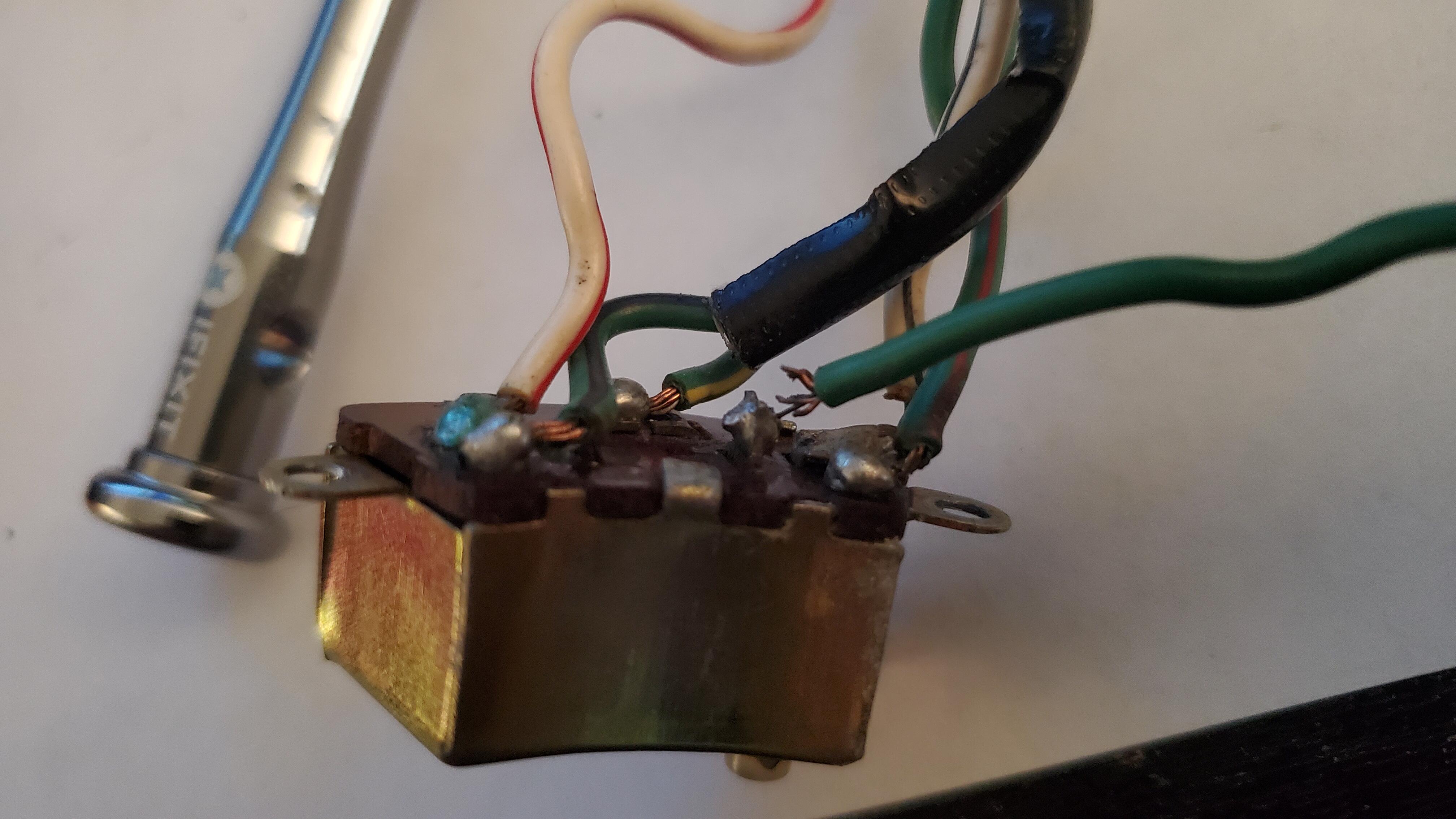

I got the stock on the bench and first thing I noticed was the 12v supply had a terrible contact (you can see it hanging on by a literal thread here). That's the 12v supply so I wonder if that impacted the relay at all
A simple way to test this is hook something up to that 12v source wire (the solid green wire there) and as you move the switch at the bottom you should have continuity between the left and right signals.

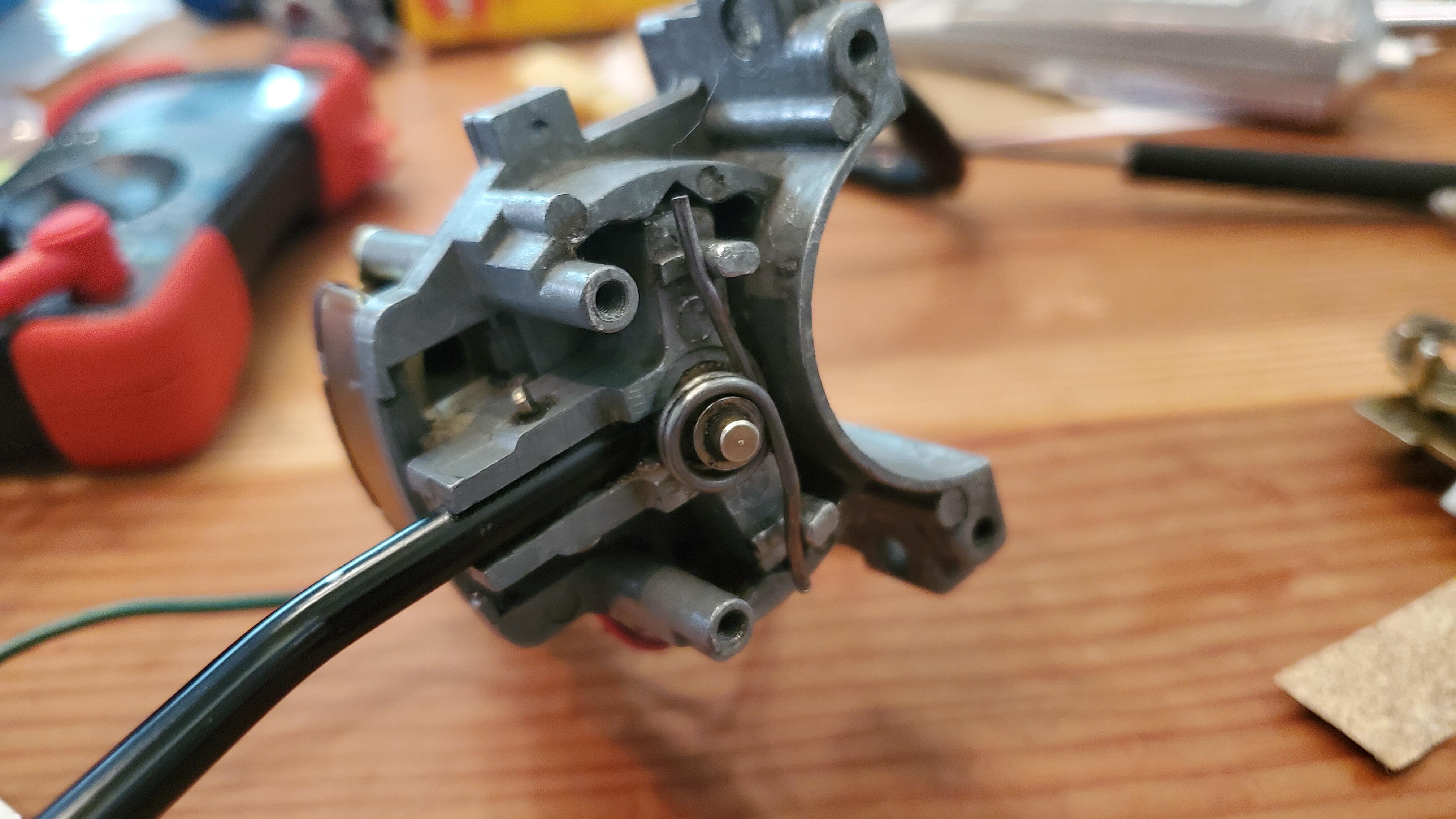

I eventually noticed that this spring, which butts up against the turn signal reset mechanism (the gold ratcheting bits you see in turn signal assembly but they are removed and to the right here), was what was limiting how much travel the switch could make. I initially started by grinding the bottom pin a bit to give it a bit more space which helped a bit, but it was still intermittent. Eventually I just took the spring off and bent it to loosen the tension and that resolved the issue!
The switch is now super easy to activate and all the signals are working.
