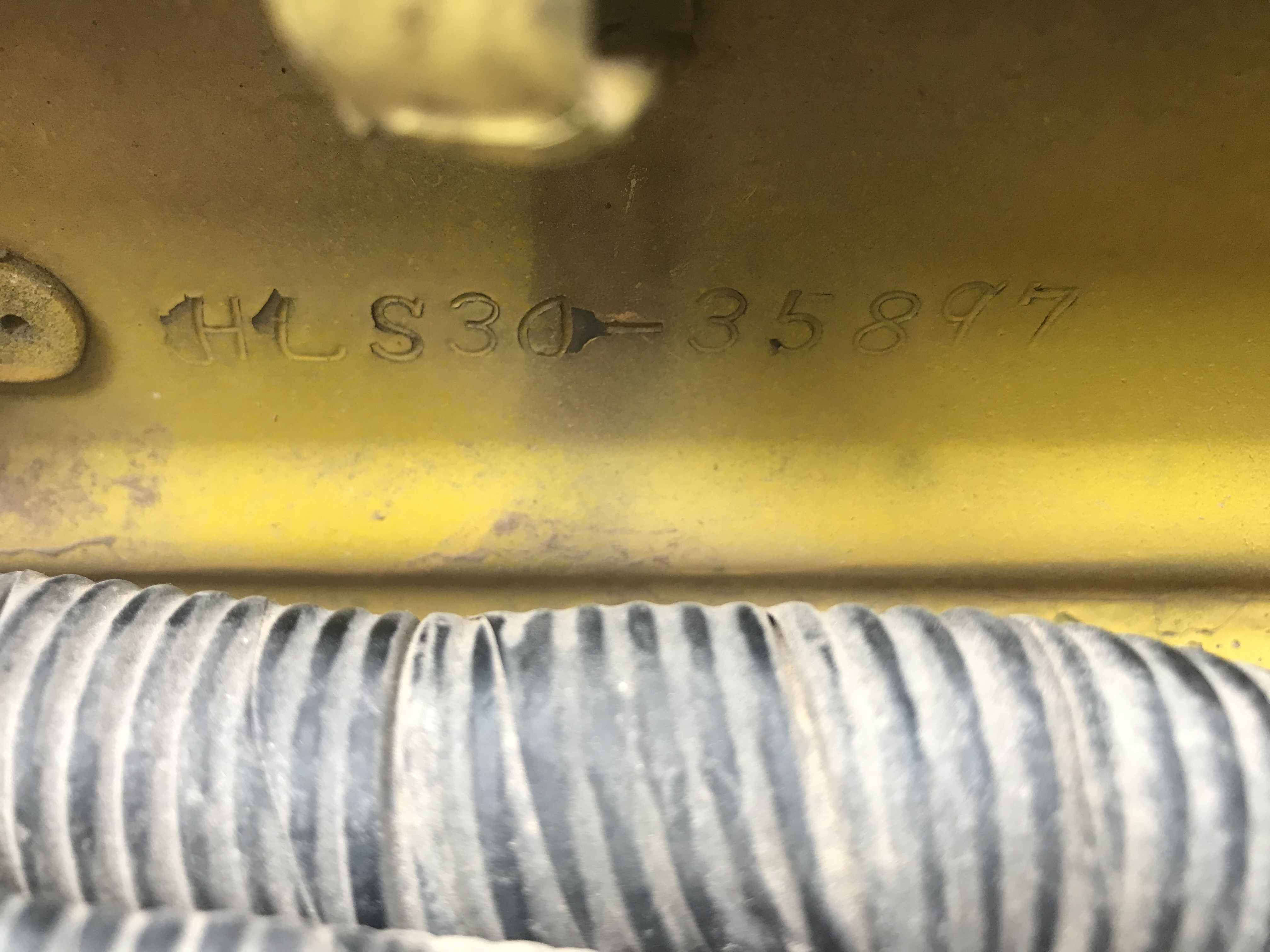

Here's the problem. The wiring harness you show in your picture and the headlight switch are from a 73 or later. Post a photo of the hazard light and post the VIN on the firewall. Something is not lining up here. It could be that someone really bastardized the car.

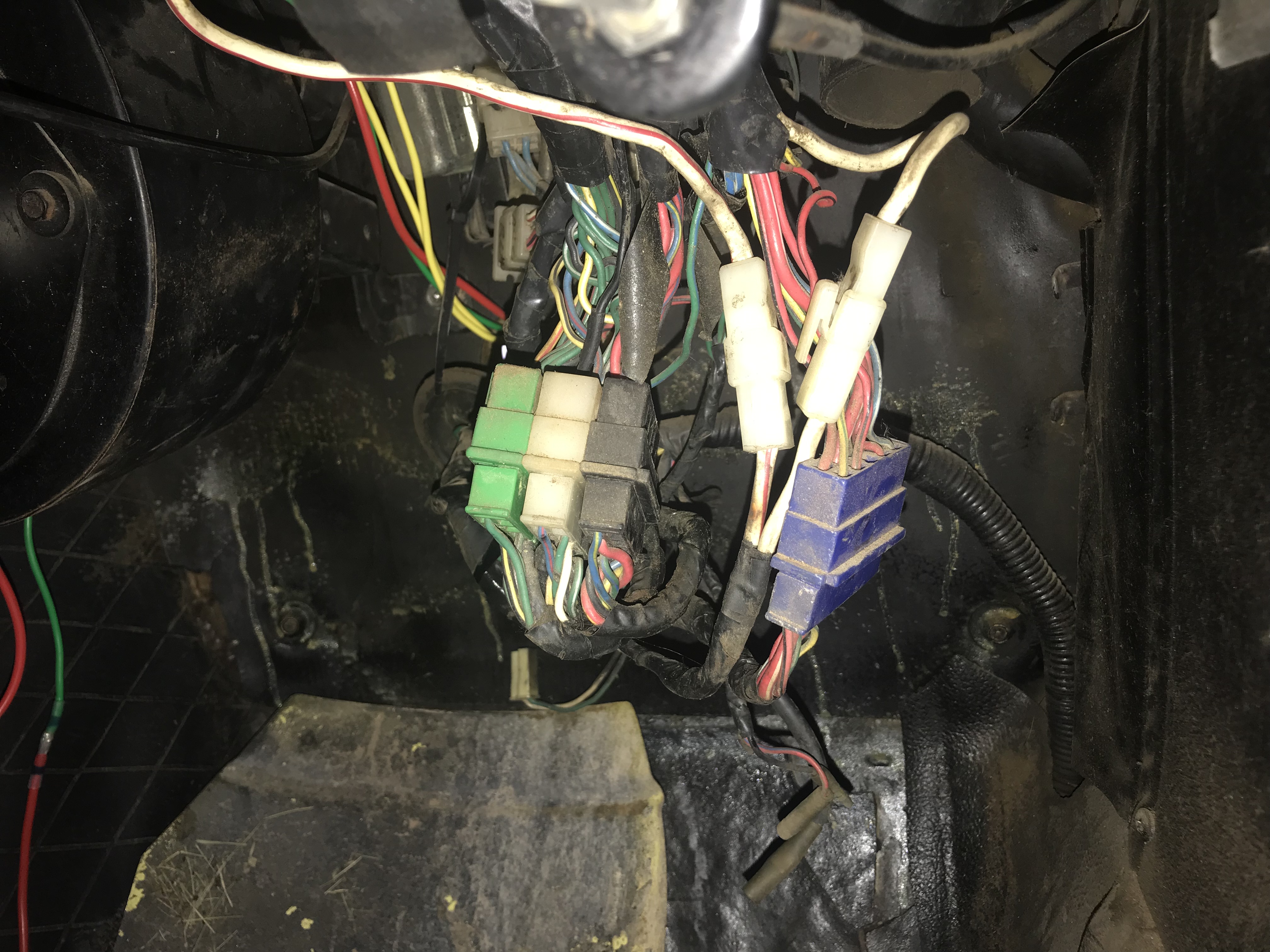

So that's the 73 Hazard switch. While you're taking photos, take some in the passenger footwell where the dash harness and engine harness come together. I want to see the connectors between the two harnesses. If they have different colors, that's all from 73.

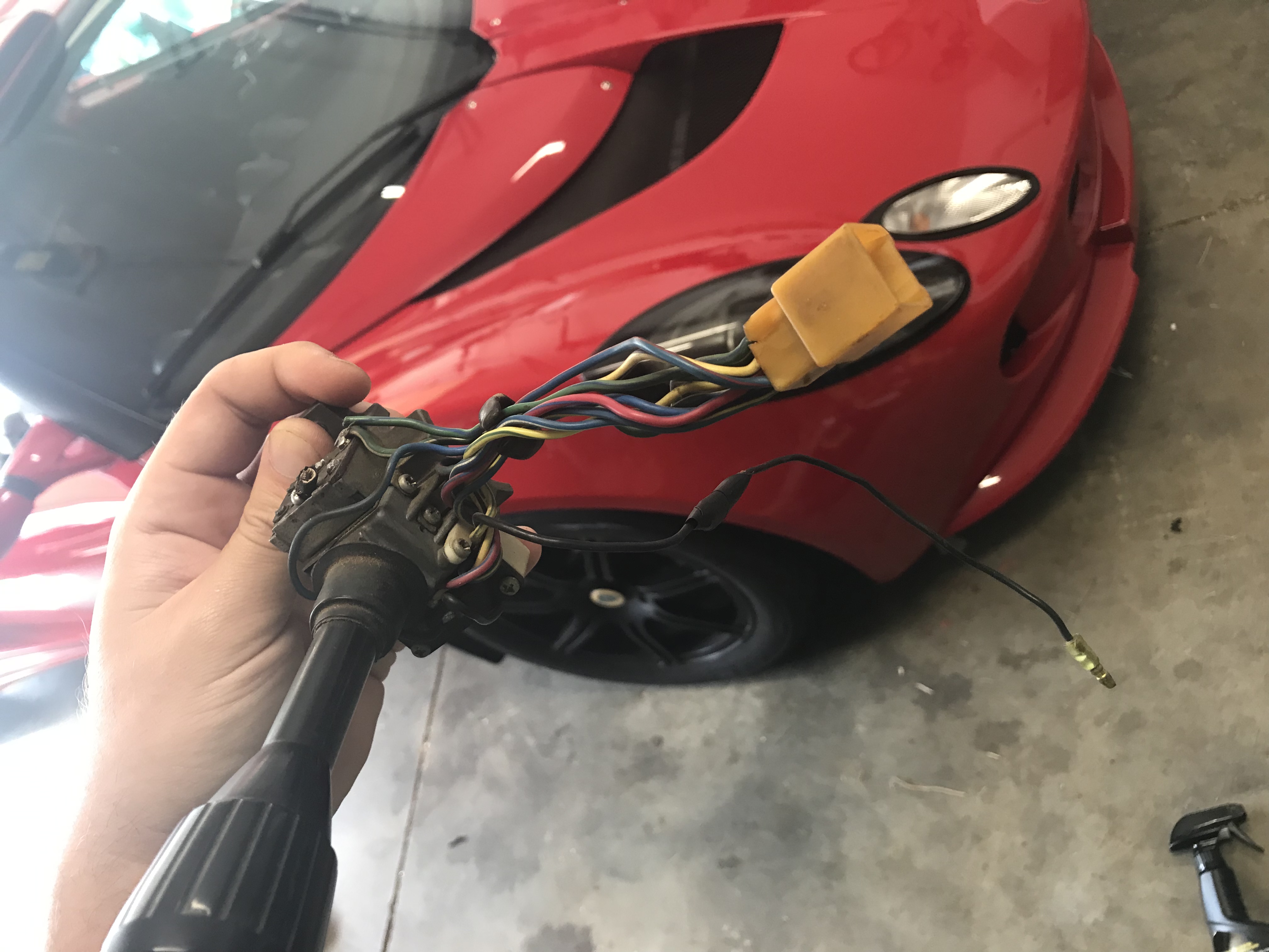

And pictures of what I have for both switches. Just for reference
Well, the VIN looks to be from a 71, but that wiring is definitely from a 73. I wonder if the person who did this also swapped over the wiper amplifier.
I suggest you download the 73 FSM for the wiring diagram. That should help you some.

Okay, will do. Could you help me figure out the headlight switch though? Haha. Sorry….. I’m trying to get the car ready for a silly inspection to get it transferred to my name. Kentucky requires a sheriff to look at the car to make sure the lights, blinkers, horn etc work.
