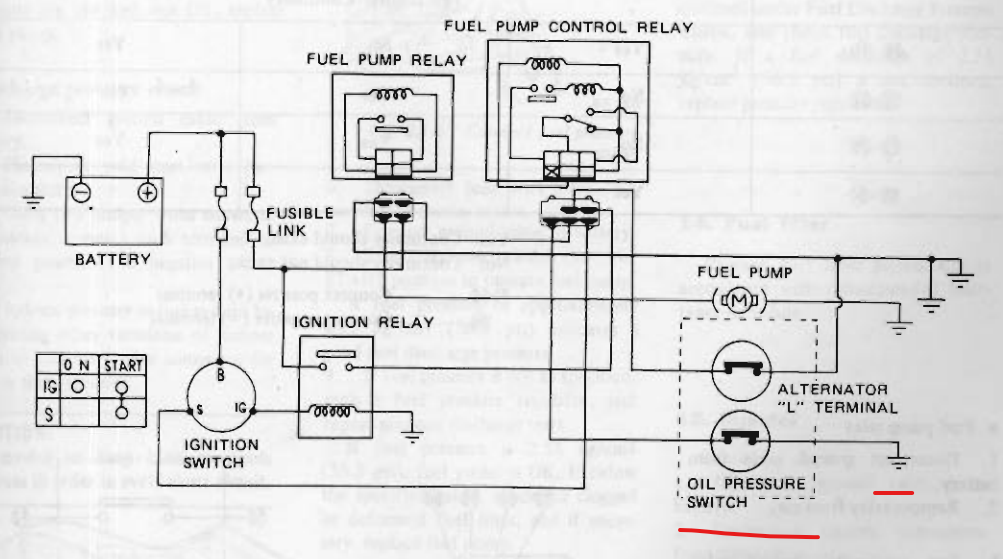

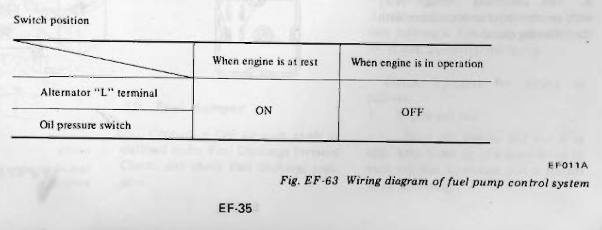

June 13, 20214 yr comment_623397 The oil pressure switch is only used on the 78 280Z and 280ZX's to control the fuel pump relay. Look at the 1978 Engine Electrical chapter is you want to see how the pressure switch is used. Your diagram is odd. Looks like somebody created their own safety system. The only wire that should be connected to the starter solenoid is the wire from the ignition switch. Link to comment https://www.classiczcars.com/forums/topic/65500-starter-motor-question/?&page=2#findComment-623397 Share on other sites More sharing options...
June 13, 20214 yr comment_623398 I think I see what the diagram is trying to do. But "ignition switch" doesn't tell if it's Run or Start. I screwed up and misread the diagram. Edit mode... The problem is probably in the pressure switch. The Nissan pressure switch passes current to ground. Your diagram shows it as passing current to a pin on the switch. http://www.texasindustrialelectric.com/relays_0332002155.asp Edited June 13, 20214 yr by Zed Head Link to comment https://www.classiczcars.com/forums/topic/65500-starter-motor-question/?&page=2#findComment-623398 Share on other sites More sharing options...
June 13, 20214 yr comment_623399 And, the switch is normally closed. It opens when pressurized. Link to comment https://www.classiczcars.com/forums/topic/65500-starter-motor-question/?&page=2#findComment-623399 Share on other sites More sharing options...
June 13, 20214 yr comment_623400 One last thing, in case you didn't know. The oil pressure switch is actually a combination switch and sensor. One pin supplies the pressure resistance for the gauge, the other pin supplies the ground signal to the fuel pump control relay. If you're thinking that the "switch" is between the two pins, it's not. Link to comment https://www.classiczcars.com/forums/topic/65500-starter-motor-question/?&page=2#findComment-623400 Share on other sites More sharing options...

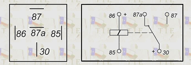

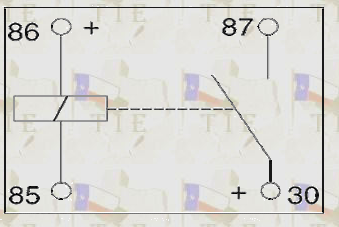

June 14, 20214 yr comment_623421 I think that you could use this 5 pin relay to open when powered through the pressure switch but close when oil pressure is present (removing the ground path), supplying fuel pump power. There would be a delay until oil pressure built up. Might have to wire in a branch from the starter solenoid so that the pump gets power during Start. You're probably done already but I felt like exercising (hurting) my brain a little bit more. There is some neat stuff on that web site. http://www.texasindustrialelectric.com/relays_0332209150.asp Edited June 14, 20214 yr by Zed Head Link to comment https://www.classiczcars.com/forums/topic/65500-starter-motor-question/?&page=2#findComment-623421 Share on other sites More sharing options...
