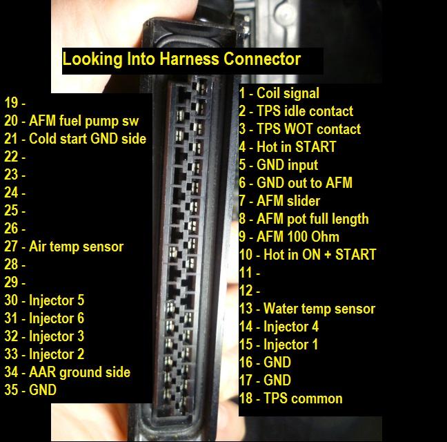

Ok guys, I printed out the EFI bible and checked all the pins. I did have trouble getting a reading from the air temp sensor(pins 6 and 27) and the water temp sensor(13 and Ground). I finally borrowed a good fluke ohm meter and got some good numbers. The air temp sensor registered 2.624 at garage temp of around 65 degrees. I'm assuming where the ( . ) is doesn't matter. The water temp sensor registered 2.471 at the sensor but only 83.0 to 87.0 at pin 13 and ground. The values at the sensor aren't carrying to the 35 pin connector. Ill follow the wire next time I work on the car to look for an issue.

Just to make sure you're numbering the pins on the 35 pin connector, here's a pic looking into the harness.
You can use this to double check your results:

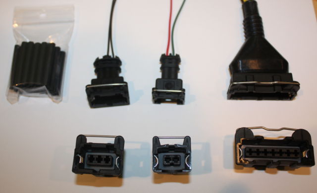

One of the most common areas for issues with the fuel injection system is the electrical connectors going to the injectors and the sensors up in the thermostat housing. The original ones are likely corroded, cracked, and unreliable. And even if they are in good shape, the way the retainer clip works makes them a PITA.
Here's a pic of a common style of connector people use to replace the original Bosch connectors. The retainer clip works different. With these, you just squeeze the retainer wire and it releases from whatever it's connected to. Much more convenient than the original design.
Looks like this:
