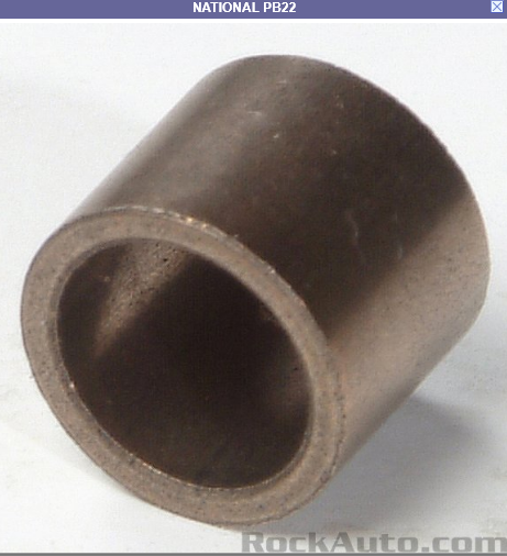

So, they replace the pilot bushing recently and now getting the shift lever in first when you are at a dead stop is extremely stiff. If it is cold it is fine but it only takes about 10 minutes of driving for the issue to start presenting itself. I am wondering if they compressed the I.D. of the bushing when they installed it and obviously when it gets hot and the metal expands that one or two thousands of clearance gets taken away.

I'd guess that it might wear/break in.  It looks like the Frontier uses a bushing and not a needle bearing like some do.  So it will either wear down to the perfect fit, or heat up and seize.  But, usually, holes get bigger as things heat up so it's odd that the problem gets worse with heat.  Maybe they didn't seat it far enough and as the shafts expand the input shaft is actually pushing on the bushing.  It might also be that it's not the bushing, maybe the clutch disc or pressure plate instead.

Regarding your point about the hole getting bigger with heat it seems like the fact that the bushing is press fit into a confined space (i.e., the tail of the crankshaft) would restrict the ability of the outside of the bushing to expand, thus only allowing it expand inward. Of course the crankshaft itself must expand somewhat but its expansion coefficient would be different because it is made of a different kind of metal. Well, that's getting into the weeds a bit. I'm with you in the sense that I think the master tech at the dealer wasn't careful with the press fit. Maybe it is like you suggest and not in all the way, maybe it is ever so slightly crooked, maybe when he seated the transmission to the engine the input shaft struck the bushing and scarred it. I've read that people suggest put the bushing in a freezer so that it will contract and slide in just a touch easier.
