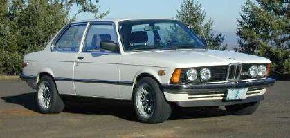

My other long-term project was an '81 BMW 323i. That car needed less work up front but was still fun to research and work on, and fun to drive as well.
Since I sold the 323i about 3 years ago, I haven't had any project cars. And as time progressed, I got more and more bored and fidgety. My wife and I finally decided that to maintain sanity (both mine, and especially hers), I needed to have something to tear apart, and hopefully put back together as well.

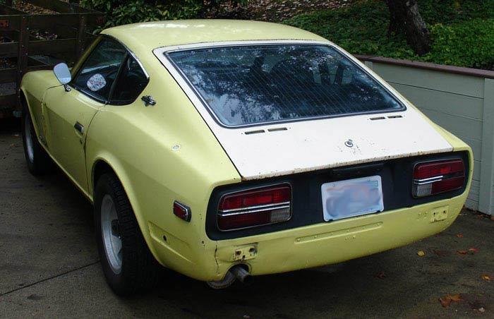

The pictures showed a car that probably had potential, if it wasn't too rusty. (I had learned by now to take all rust assessments from sellers with a grain of salt.) It would be a long day's drive to go look at it, so I made plans to go there on a Sunday a couple of weeks from then when I had to get up really early anyway. (Taking our son to the airport to go back to college.)
While waiting for the day to go visit the yellow car, I saw another local 240Z on eBay. Turns out this car was in walking distance of my office. So I went to look. This one was a '73 240 with a four speed, and carbs off an earlier 240. It had originally been yellow, but was now an odd dark blue. Bits of yellow stuck out here and there, and the interior was not too good. It had been hit in the rear at some time, and the repair was of pretty poor quality. It had the normal rust in the lower front fenders, too. The seller told me he'd sell it to me locally for $3000. I decided to pass. (The auction never met his reserve, last I saw he still had it.)

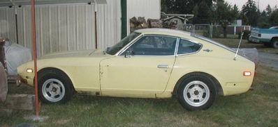

So in late August we drove 260+ miles to look at the injected yellow car. Inspection in person showed a car that had been fairly accurately described by the seller. Quite straight, other than the driver's door. Amazingly, the nose was not all dented up. The car was an early model that originally came with a hatch with the small vents, but it had a later non-vented hatch on it. No bumpers on the car, but there was a rear bumper to be included. The interior was intact and much better than average. The dash had only one very small crack. The brakes were not so good, with a very low and soft pedal. The engine was out of an '83 280ZX, complete with the injection. It would run, although it was only firing on five cylinders. The sellers had done a compression test, which came out good, so they figured it had a clogged or bad injector. A set of original SU carbs and manifolds were to be included as well.
My only hesitation was - of course - rust. This car wasn't too bad on that score, but after looking it over I decided that the passenger floorpan, lower part of both front fenders, rear doglegs and both rockers would need to be replaced. We told the sellers we'd be in touch later and drove back home.

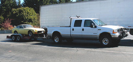

I had verbally committed to buying the yellow '71 in early September. Now I had to arrange to go get it. The car wasn't drivable, so I needed to trailer it. Problem being, not only do I not have a car trailer, I don't own a vehicle suitable for towing one either.
Since I didn't want to have to rent a truck as well as a trailer, I arranged to borrow my brother-in-law's Ford F350. A bit of overkill, perhaps, but easily available. The truck was being used for the next couple weekends, but we arranged to borrow it for the day on Sept. 24.
I called one of the local U-Haul locations and reserved a car trailer for pickup at 7:00 PM the night before the trip. Got the truck, went to pick up the trailer. Note to self - Some U-Haul locations are less competent than others. First they couldn't find any reservation. Seems the person I talked to early in the week was busy, and so didn't bother to actually reserve anything. No name, no notes, nothing. It turned out not to be a big issue, as they still had a couple of trailers available. Got it hooked up, checked the lights (most of which worked), signed the papers and came home.
Then I decided to look the trailer over before dragging it 500 miles round trip. Three of the four tires were 15 PSI low, the fourth was mostly flat. A couple of the wheel bearings had more play than I would have liked, but not so much that I was worried about them. So I drug the trailer down to a nearby station to air up all the tires.
Since we had to get the trailer back to U-Haul by 7:00 PM, we were on the road before dawn, and had an uneventful trip up. The trailer behaved it self just fine. Met the seller, loaded the spare transmission in the bed of the truck, and found the included rear bumper. The bumper was pretty rusty, probably only a few salvagable parts on it. But the rear overriders are straight and could be re-chromed, and those can be hard to come by. Did the paperwork, and proceeded to start the car to drive it onto the trailer.
The battery was dead. No real surprise, we had to jump it when I looked at it weeks before, and it had only been moved once since then. It cranked over just fine on the jumper battery, but didn't start as easily as I had remembered. Once we got it running, it still felt sluggish, and would make a horrible howling noise when revved. Didn't do that last time. I didn't worry too much about it, I just wanted to get it loaded, and get on the road. Which we did.
So far so good. Trailer is still behaving, the big Ford hardly notices the extra load. Stopped at a rest area a little over an hour into the return trip.
Ate lunch there and got back on the road. About halfway home Deanna suddenly says, "We forgot the carbs!" True story. Forgot to load the carbs and manifold assembly the seller had said would go with the car. Too late to go back, so I was going to have to see if he would pack them up and ship them to me. Grrr.
Stopped for diesel for the Ford. Gulp! Diesel is expensive this weekend (just after hurricanes Katrina and Rita), and the Ford uses a lot of it. Oh, well.
Got back home around 5:30. Made decent time, considering. Had to jumpstart the car again to get it off the trailer. Started easier this time, but still doesn't want to rev, and when it does it makes that horrible loud howl. No matter, the trailer must be returned by 7:00. Got the car off the trailer and backed into the garage. Got the trailer returned with 45 minutes to spare. Yay! It's done!
Took the Ford back to its home, found the transmission and bumper still in the bed. Had to load those in the trunk of our main car, and came home to have dinner. While waiting for Deanna to prepare dinner, I (of course) had to go into the garage to look it over. Deanna pops the door open and snaps the picture below, laughing about, "It hasn't been 10 minutes and you're already working on it."

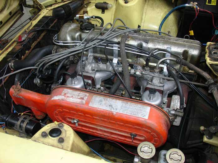

So of course, now I want to go drive it to test the brakes. But the car still makes that horrible howling noise, and had no power to boot. Got to do something about that. So I start it up, get out of the car and get ready to make it howl and see if I can hear where the noise is coming from.
So as I rev it the first time, I have my head cocked to try to listen better for direction. And my eye is on the air flow meter in the front left of the engine compartment. And as I rev it, the rubber bellows between the AFM and the throttle body half collapses, like a vacuum cleaner hose with your hand over the end.
As part of the injection installation, the car has a home-made cold air intake on it. There is a rubber duct that runs from the AFM through the radiator support, where a large 3" diameter exhaust pipe elbow is connected. The elbow comes through the radiator support and bends 90 degrees towards the center of the car in front of the radiator. A large paper filter element is press fit onto the pipe.
So I reach down and remove the elbow and filter from the rubber duct. Suddenly the idle speed increases. I rev it. No noise, and the engine revs eagerly, even with number 6 not firing. I look at the filter element on the elbow, and find that it had been pushed so far onto the pipe that the rubber cap on the closed end was plugging the pipe. The engine couldn't breathe at all! The howling noise was the sound of the air forcing its way past the rubber seal, which was also being sucked even tighter by the engine vacuum!
Took it for a test drive. Totally different now. Even with one dead cylinder, the car revs and pulls responsively. It's much happier now. The automatic shifts well, and makes no bad noises. I did find that the car pulls hard to the left when braking though, so back to the garage to check the front brakes over.

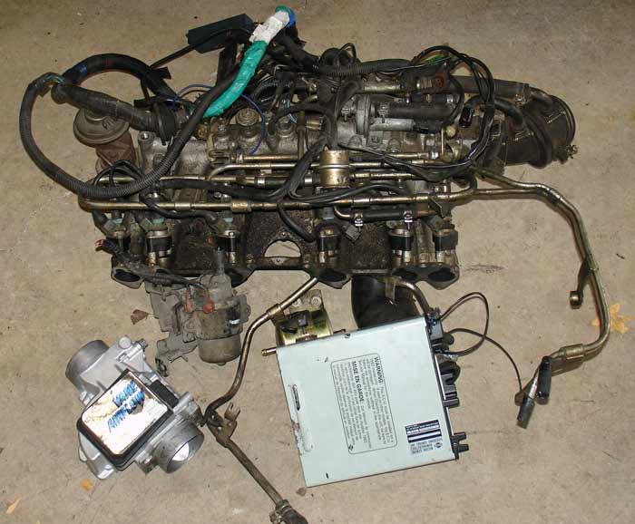

The carbs came on a pair of E88 manifolds, with all linkage parts and an original fuel rail. I still need to find a heat shield, two return springs, choke cable/lever assembly and an air cleaner. I will also need a different (lower pressure) fuel pump, and a whole pile of little odds and ends. Since the injection isn't working well, and has some electrical problems as well, I really want to get the carbs back on the car soon.

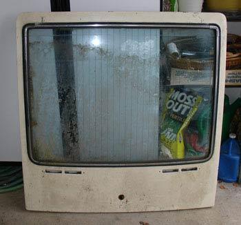

15 Nov 2005 - Carbs and Hatch
The news started early this past week. On Tuesday a box full of parts from Danny's Datsuns arrived. I had ordered a few parts for the upcoming carb installation from him - an air cleaner, heat shield, return springs and choke cable assembly. At first glance, it all looked good.

Saturday morning found me moving the Z into the garage for the carb install. I was pretty sure that I had most everything I needed. Shouldn't be more than a "one or two trip" project (meaning trips in the middle of the job to get unforeseen parts).
BEFORE
Started by pulling the FI fuel pump and restoring the fuel lines near the tank to factory configuration. I had decided that while mounting the new pump up front isn't ideal, would be far cleaner, easier to work with, and much easier to wire. Then I capped off the coolant fittings to the injection manifold, as I won't be using that on the carbs. Stripped out all the wiring and the brain, then finally pulled the whole mess out of the car.
THE MESS
Started installing new stuff after lunch. Installation went fairly smoothly, only a couple of small bugs. After getting it all physically in place, the last three tasks were: mounting and plumbing the fuel pump; wiring the pump; and rewiring the ignition. Those tasks went well also. It turned out to be a "two trip" job, I finished late Saturday afternoon.
AFTER
It started rather easily, and runs surprisingly well, considering that the carbs are unchanged from however they were when I unpacked them from the shipping box. It is running rich, but it runs. A short drive showed that yes, it can run smoothly and not miss, so the results are encouraging. There is still much tuning to be done, but the main pieces are in place.

Lastly, today I swapped the new-old hatch onto the car. It actually fits much better than the one that it had before. I suspect the other one had bent hinge mounts. Plus the color (cream now, originally orange) is much closer to yellow than the blue was. I think the glass will need to be replaced, but this hatch is actually in much better shape than the last one, and is "correct" as well.
