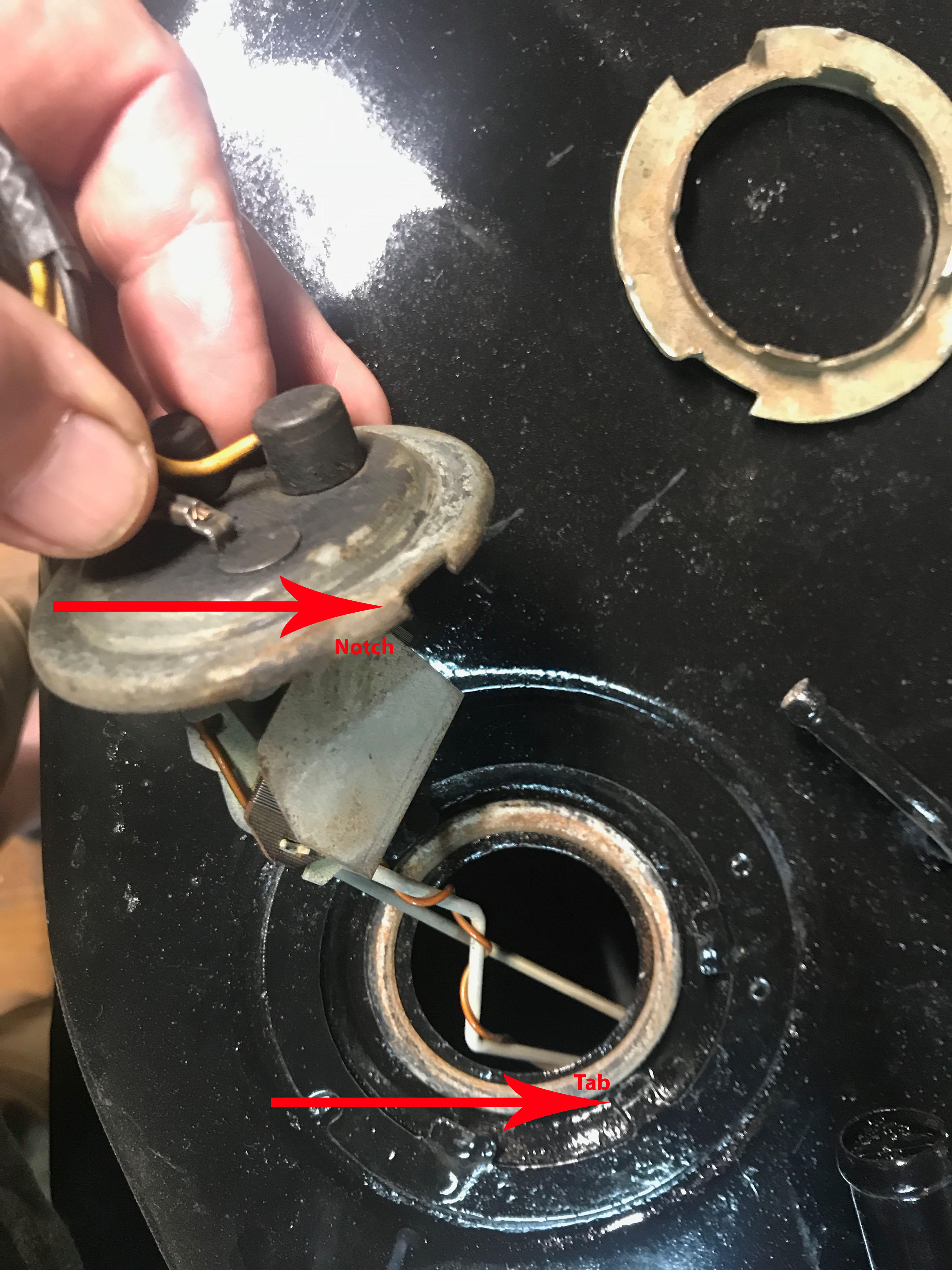

This is from a 77' which should be the same. Just match tab on the tank with the notch on the sender.
Edited by gwri8
I'd the wrong location of the tab in the original photo
Awesome.  This is a huge help - case closed
