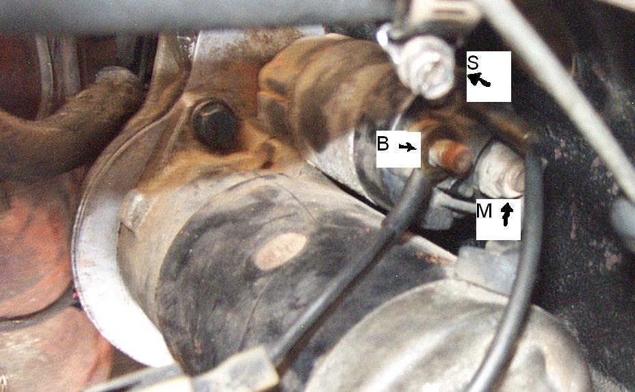

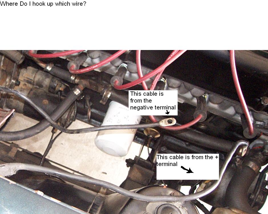

I'm confused on how to hook my batter up. Maybe someone could give me some pointers. I have a photo attached.
Which wire goes to which terminal. And what do I do with the extra wire coming from the battery that is not hooked up to the solenoid. Is that bellhousing bolt on the left a good place to put it?
Hook the negitive cable to the top bolt the holds the starter to the bellhousing. hook the positive cable up to the positive terminal on the starter solinoid.

Thanks Jeff!
I got it all hooked up and it cranks over just fine. I can't wait to start it. I have to torque the drife shaft flange bolts and then put in some transmission fluid.
