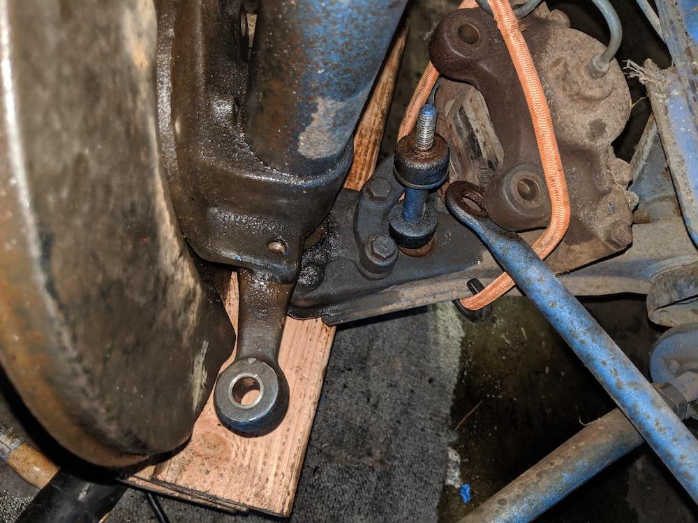

Can you post up a couple of pictures of what you have and the bolts you have removed
Thanks @Patcon,
Attached is what I've got.  As you can see, I've taken off the tie rod from the steering knuckle.
The bolt I'm talking about is already taken out in this picture.  I've taken out the corresponding bolt on the other side.
The knuckles have a milled area that fits up into the bottom of the strut
They can be really difficult to separate. There is also a small O-ring that goes in there to keep water out of that joint. If you are just replacing the strut insert, it can be done without removing the strut from the car. If you really want to separate them, then it will have to be driven down with some force, which is going to stress the ball joints or you could try to drive a painters 5-way in between the parts.
