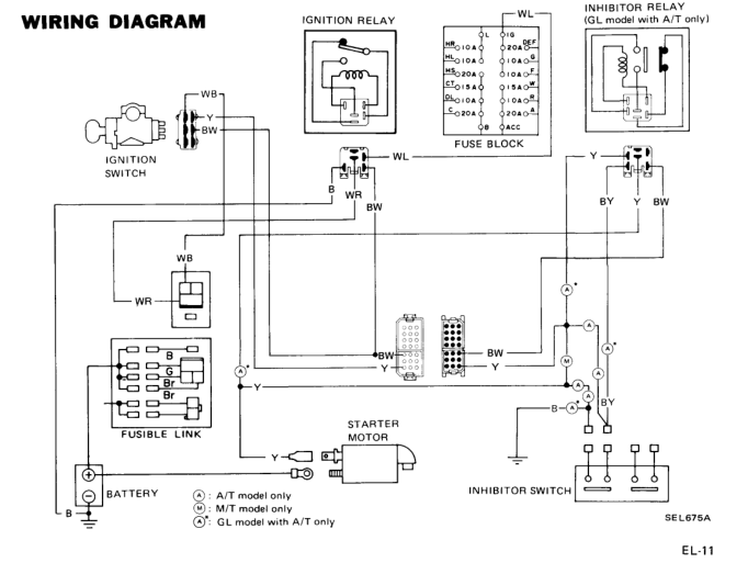

See if the little yellow wire to the starter solenoid has voltage when you turn the key to Start.
Some of the cars have an inhibitor switch.  GL model with automatic transmission.  Otherwise it's just a yellow wire from the ignition switch all the way to the starter solenoid, with one connection along the way.  The connector would look exactly like the picture, with 21 pins.
