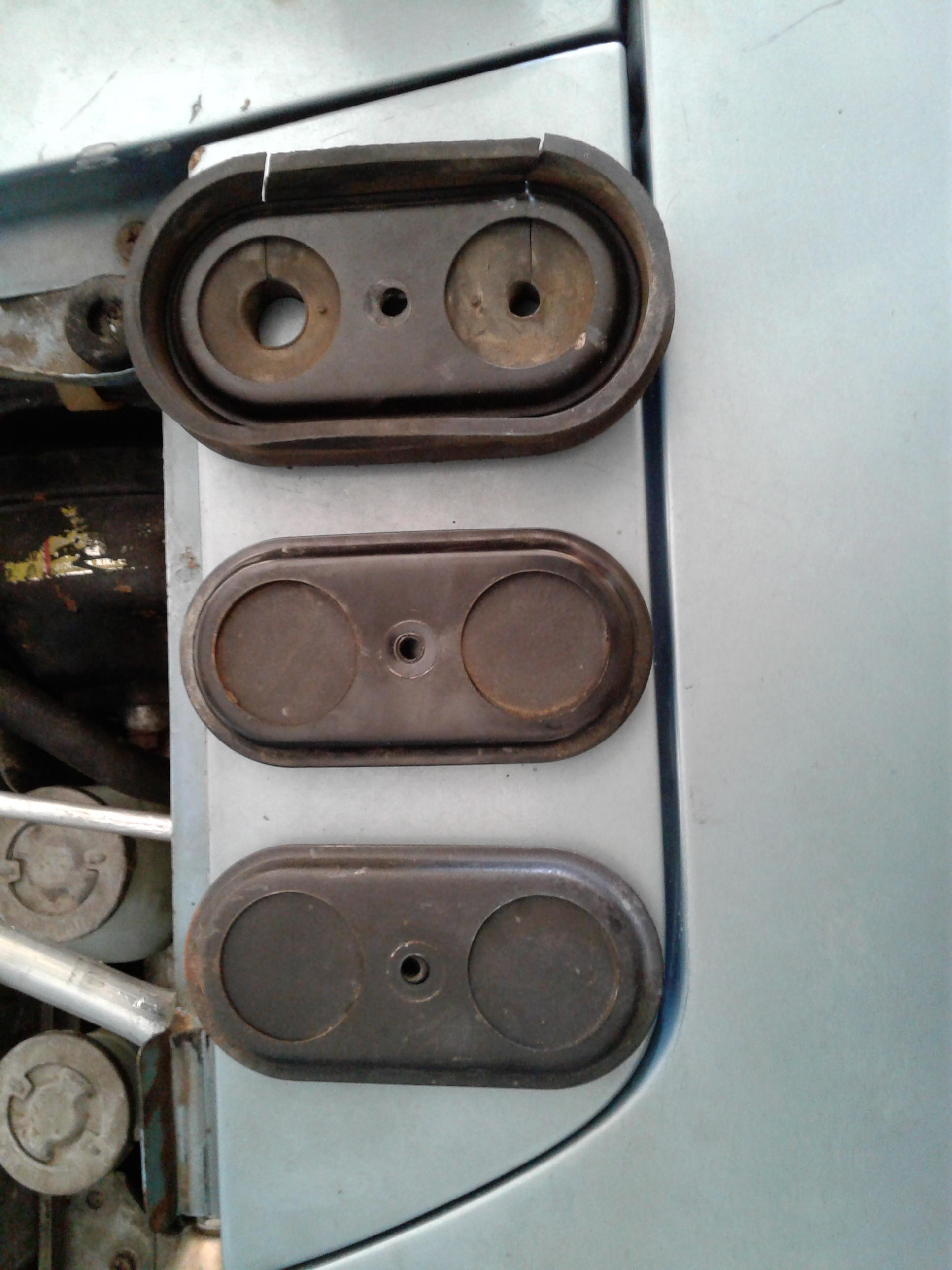

In the picture below, the top-most AC feed through bulkhead gasket came off a 1995 Pathfinder. Still very much pliable. Now this gasket does have a 'dust-shield' that wasn't original to the Z, but that could be easily removed with a razor blade.
The middle blank off bulkhead gasket came off a 1993 D21 series pickup
The bottom blank off bulkhead gasket is original to the 280Z
I was looking at the Pathfinder as it was the newest model with a V-belt, rather than a serpentine belt.
I didn't have a tape measure while I was there, but the condenser looked very close to the type and size, and would need to be investigated if anyone wanted to research that.
