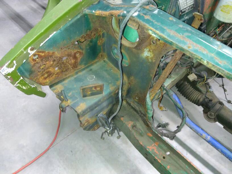

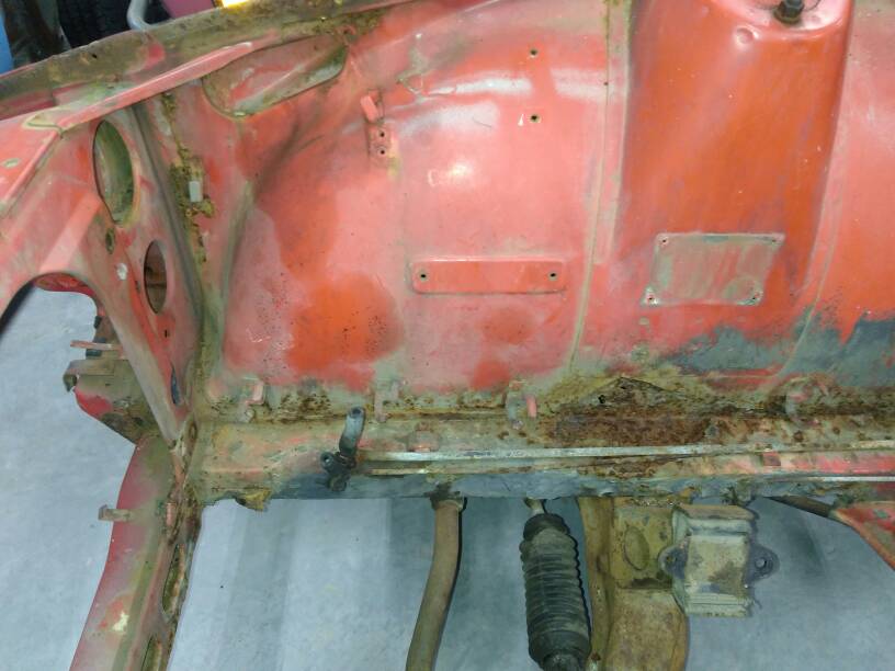

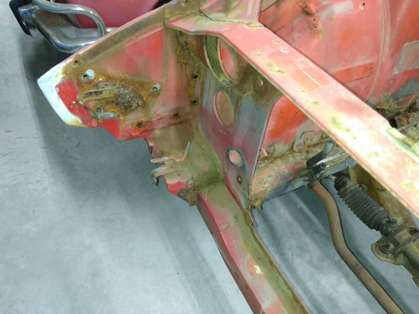

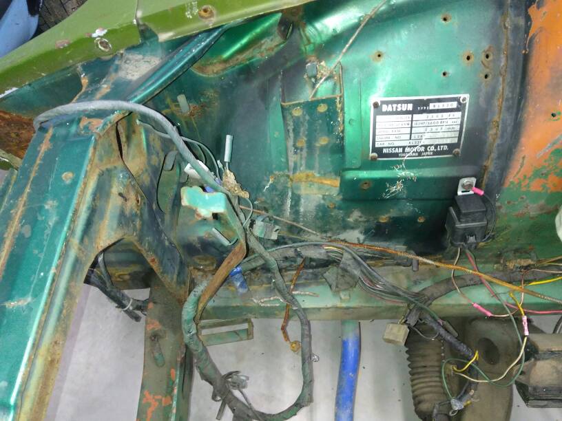

You can see the difference in how the bumpers mount. Red is a 72 and green is a 74. There's a gusset on the inner fender by the radiator support on the green 74. The green car is a 72 with a 74 nose spliced in at the front of the shock towers.
