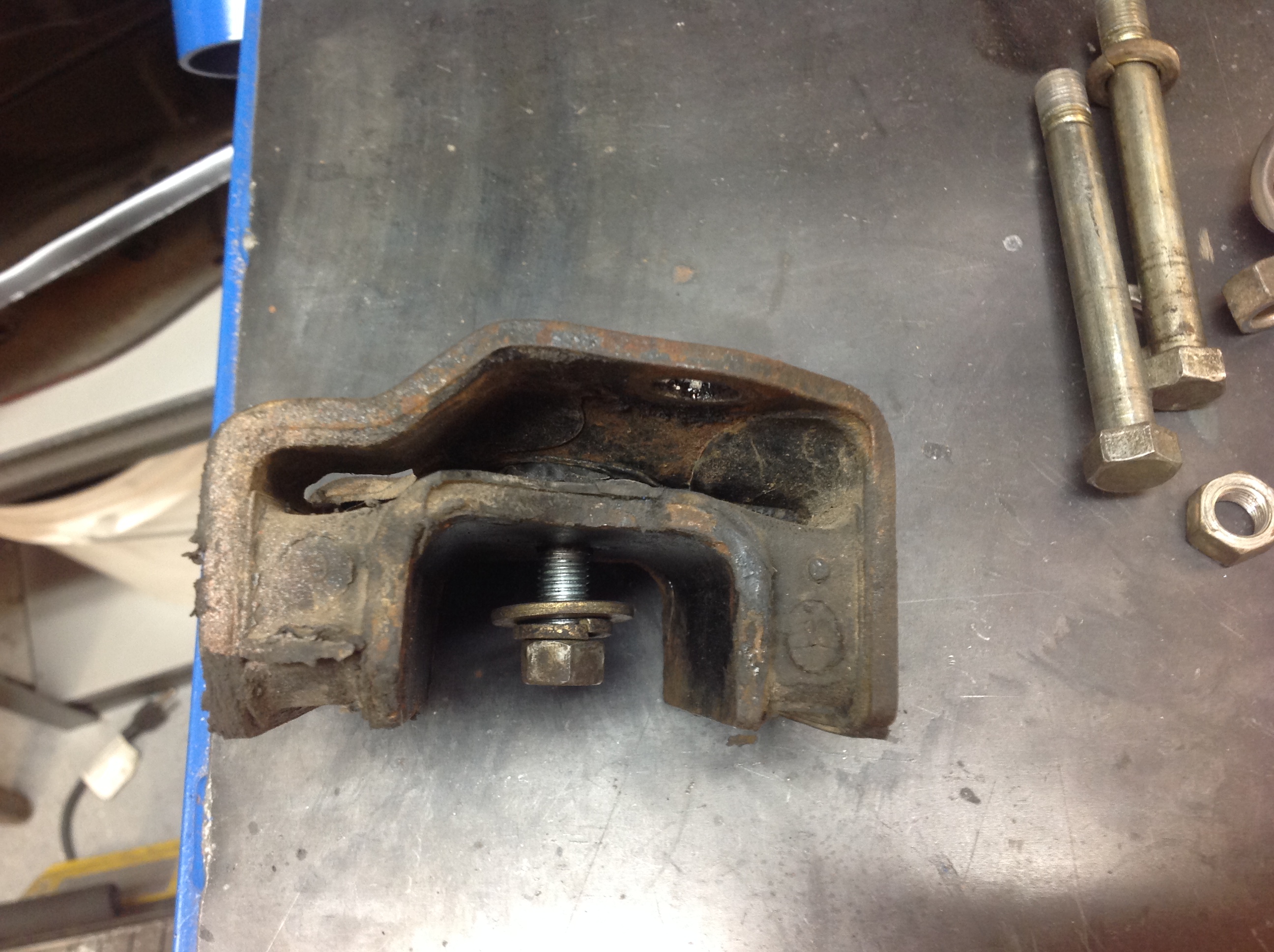

Got it! Thanks for the tip Zed head, I was able to get a wrench in the nuts in top and turned the bolt from below with a crowfoot wrench end on a short extension. Worked like a charm.
The insulator is in better shape than I expected. I think it must have been replaced at some time in its life.
