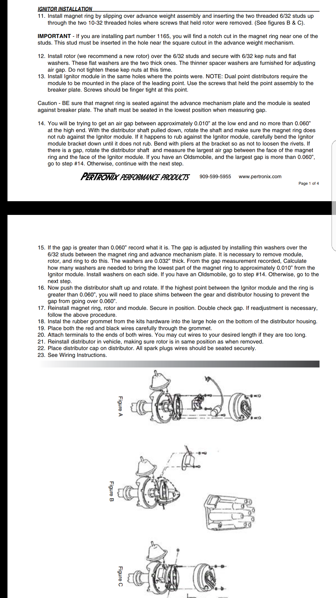

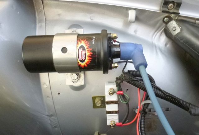

April 10, 20187 yr comment_547053 On 1/2/2016 at 1:16 PM, Lumens said: I installed this same Pertronix last year using the the ballast resistor and 1.5 ohm Pertronix coil. Ran perfect all Summer. Maybe I should get a spare to carry in the car. I think i should check the gap between the magnet and reader. Link to comment https://www.classiczcars.com/forums/topic/53218-ongoing-issues-with-pertronix-ignitor-fixed/?&page=2#findComment-547053 Share on other sites More sharing options...
