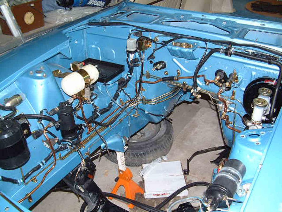

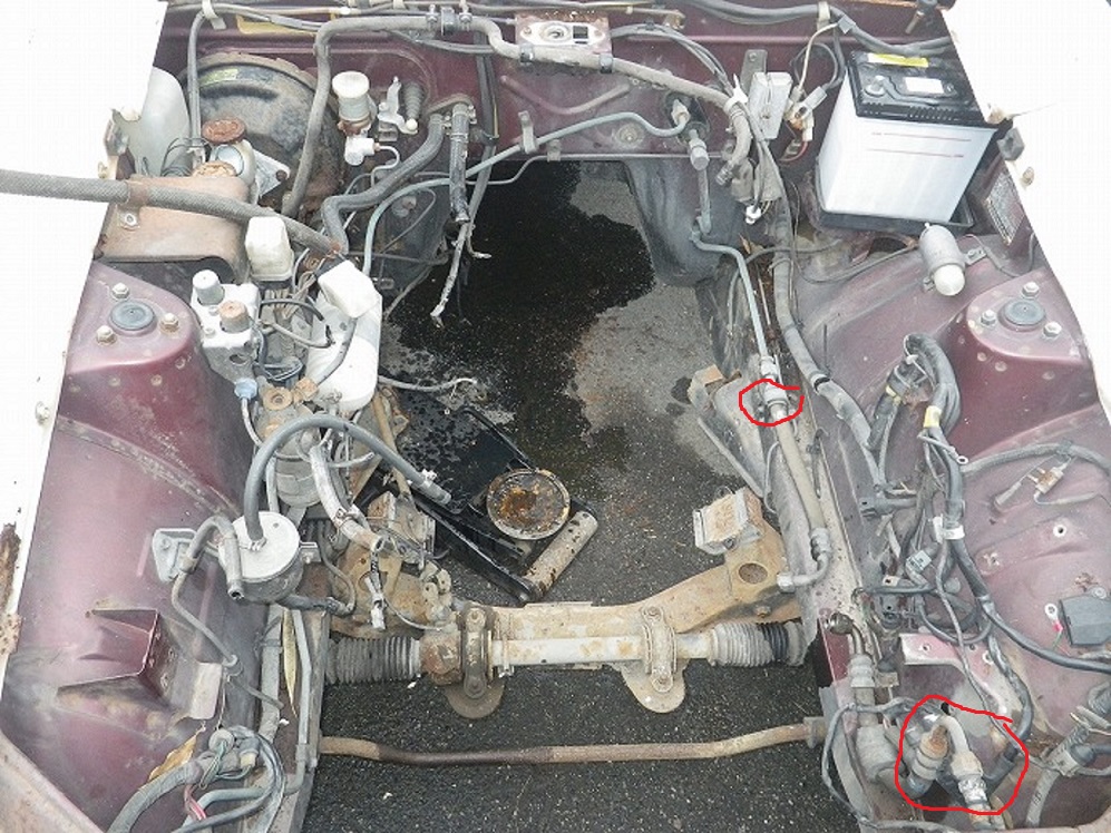

What happened to the factory copper lines that connected up to the lines coming out of the firewall?
Using the factory lines is the cleanest and it keeps your rubber hose lengths short.
This guy over on hybridz has the whole line set for a bargain price of $30
http://forums.hybridz.org/topic/123291-fs-n42-intake240mm-flywheel280z-ac-lines/
That barrier hose isn't cheap. Did you already make long hoses?  or some kind of kit?
These are pictures of all the copper lines that the z has. You can see how nicely they fit around
the engine compartment.
I just had some barrier hoses made by username Texasrick on ebay.  He does outstanding work and is reasonable.
BTW.. those are 1/2" flare
