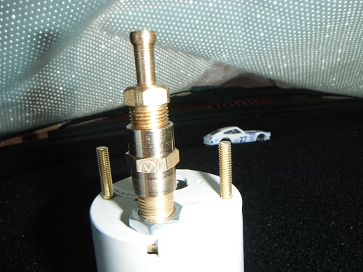

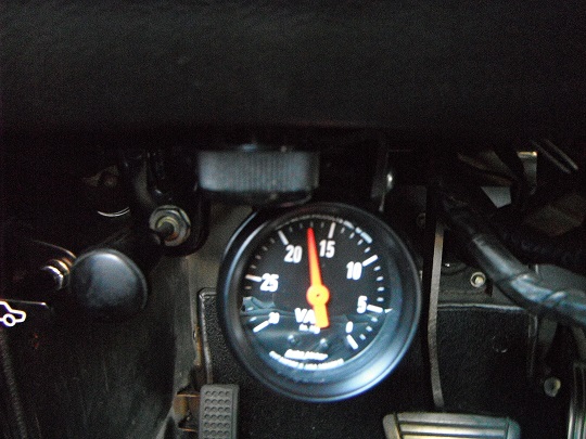

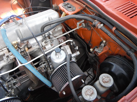

May 14, 201510 yr Author comment_469766 Here's a few shots. Used 7/32" vac line, found some smooth hose barbs to fit. Used a little Permatex "aviation" on everything. Put some wirecare braid sleeve on it for looks. Didn't bother hooking up the light. Took a drive to check it out, car ran really crappy, my first thought was the gauge messed it up somehow. Had the symptoms of fouled plugs, though, so pulled the plugs and sure enough the back three were fouled. Cleaned them off and set the back carb a little leaner, took another drive and it ran well. The vacuum gauge works fine, but I'd be afraid to put an automotive mechanical fuel pressure gauge in the cockpit (industrial gauges are all metal, made in USA or Germany, repairable, with tempered glass faceplates good for 200 psi, bourdon tubes good for 3 times max pressure on gauge, etc.). Maybe there are better automotive gauges I don't know about. Vacuum really drops out on acceleration, guess the SU pistons are dropping as well. Learning experience. Link to comment https://www.classiczcars.com/forums/topic/51435-what-hose-for-vacuum-gauge/#findComment-469766 Share on other sites More sharing options...
