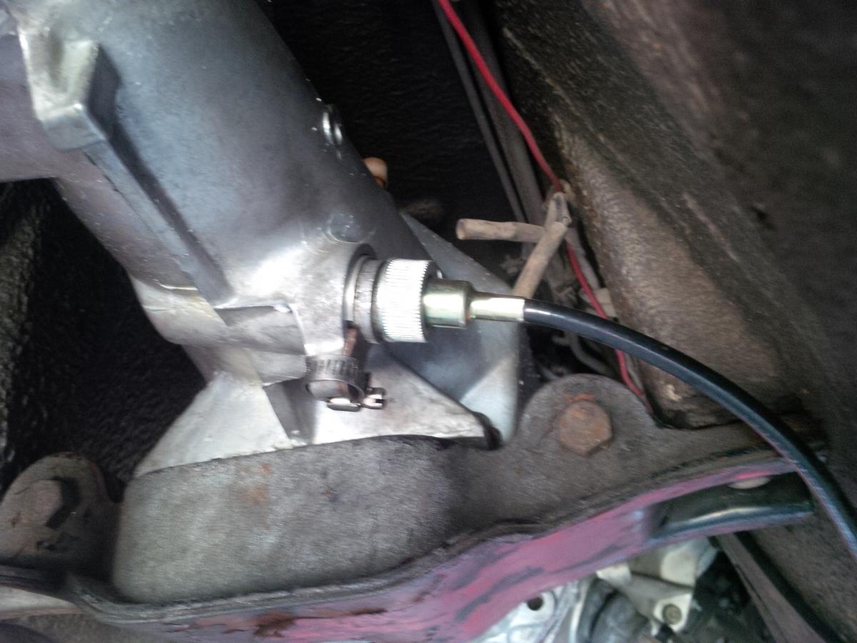

This is a picture i took underneath my car when the alignment of the tie rods was carried out! As mentioned before my 240z has a 280z transmission. I replaced the speedometer cable but still have a bouncing speedometer from 0 to 40mph! Is there something i am missing here? This cable is Brand new from Black Dragon. Once it reaches 40mph it dials the speed steady.

I'd pull the cable and lube it well with graphite cable lube. Do it soon before you do damage to the cable and housing.
