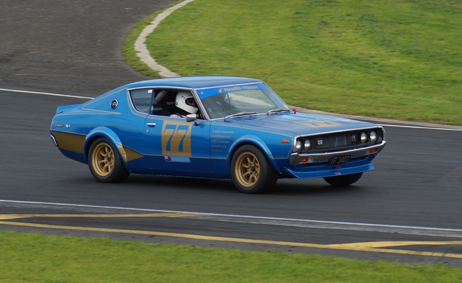

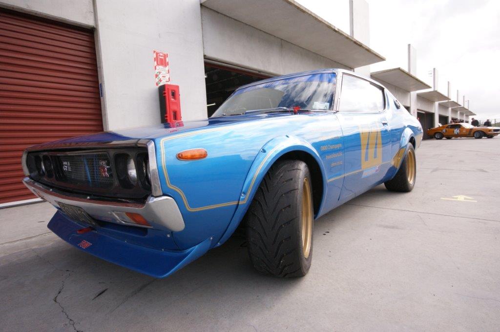

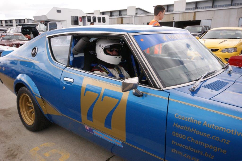

She ran pretty well, weather was a bit sh%$. We did have a bit of shuddering under braking which I think is a alignment issue and it was losing a bit of fuel pressure at the end of the straight, which we think is due to the standard lines leading from the tank to the fuel pump. So will fix those.
Videos are not far away
Here's some pics to tide you over
There was a lot of positive attention and I got interviewed by the TV station and the car was videoed but don't think it made it to broadcast.
My laps results are here Event results - details - MYLAPS Sports Timing look under HMC and Pre 78 Saloons - car 77

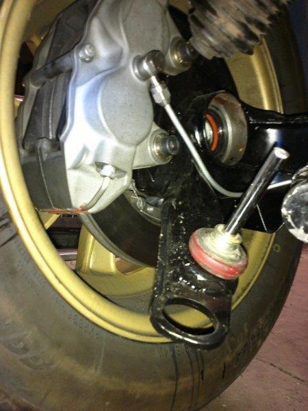

Upgraded the rear brakes with discs as well but managed to snap an axle launching off the start line.  Lucky we had gone to disc as it held the wheel on, snapped a shock but no major damage.
Also upgraded the LSD with a Quaife version. and repainted suspension new bearings/crosses etc
