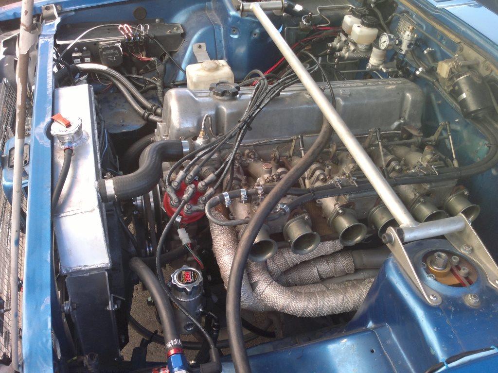

You are correct that is the same car. L6 2.8 engine with diesel crank stroked to 3.0l, custom extractors and triple dellorto carbs. New side exhaust is planned, currently just a single.

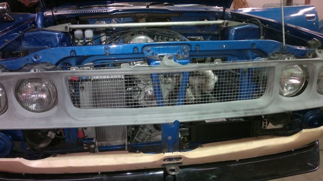

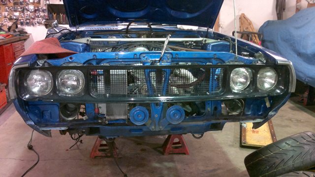

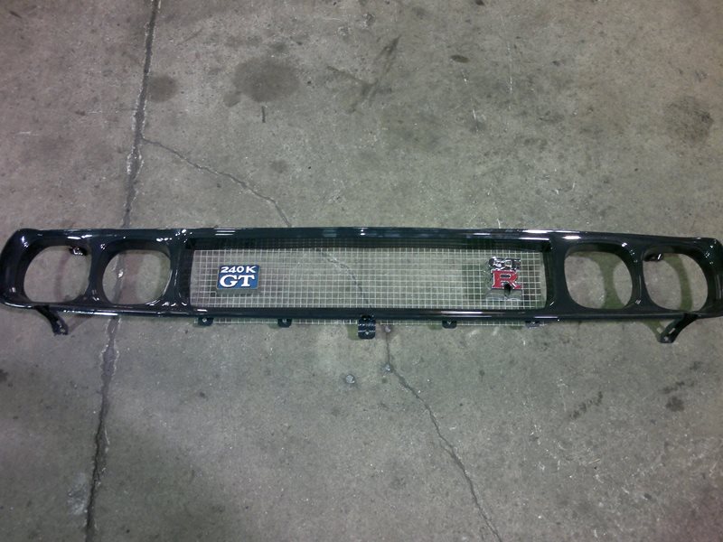

Got the flares and grill from restored via Ottomoto, unfortunately nothing fitted that well. Chad spent hours modifying the grill and we modified the flares a bit but might need to revisit one of the rears.
The grill is not fitted at the time I took this photo as we have only just finalised the power steering conversion.

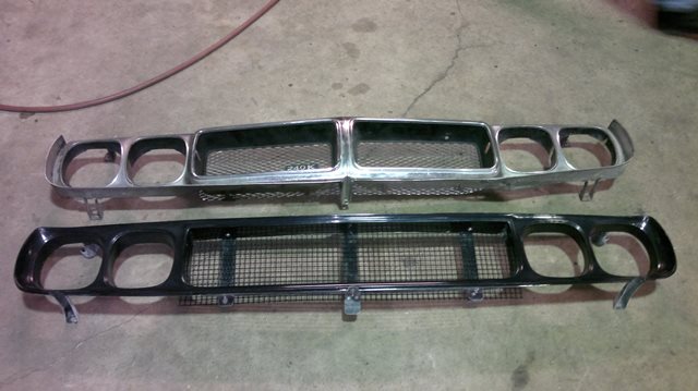

How it arrived compared to stock
How it fitted (or did not fit)
After adding an extra 20mm in the middle and replacing the mesh with something lighter and better.
Close up - also removed the three bars that held the mesh, I know this is how they came, but prefer the cleaner look.

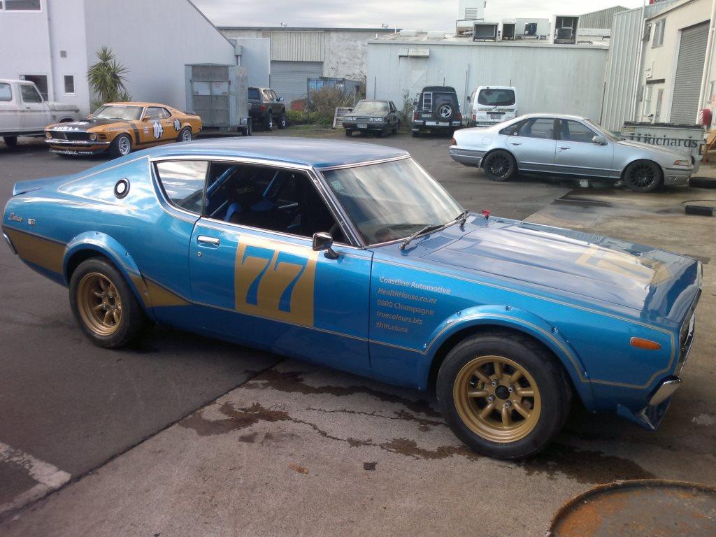

Painted grey metallic (re chromed bumper still needs alignment and GTR badge needs to be fitted)

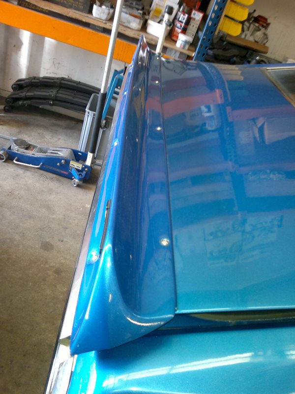

And how did you secure the rear wing?

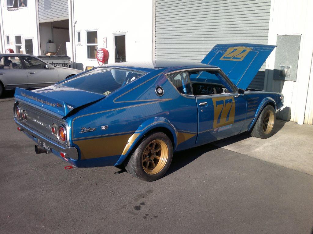

We affixed the spoiler using the same rivet bolts we used for the front spoiler and the flares. Restored provided normal rivets - but they would have looked like crap.
We also modified the front of the rear spoiler as it did not have the indents for the rivet bolts, so we used four at the back and four along the front. I think they used double sided tape at the front and rivets at the back for the street versions. But don't want it coming off at high speeds so took a bit of care.
Yeah that's why I asked. I was worried it wasn't secured enough also. I've seen some rear wings having bolt fiberglassed into the underside of the wing in the gap so to speak. I was thinking along those lines (I'll have to find a photo).

That looks like a much better designed spoiler. Probably the restored parts are my biggest regret of the whole build, normally Japanese parts fit so well, these were just crap. I am going to have to redo one of the rear flares as it is just not right.
Here's what we did with the rear spoiler

Also got the badges onto the grill, sticking with both the 240k GT and the GTR badges for the car, seems the right thing to do.

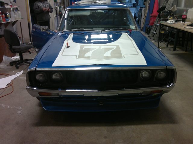

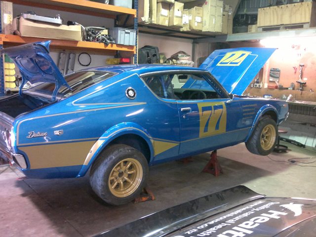

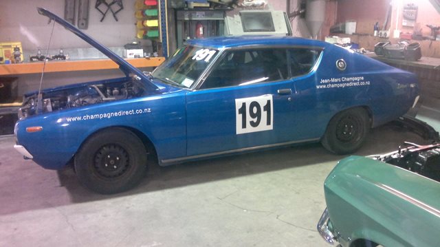

Regarding the signwriting it was really difficult. We use printed media, but had to print out in sheets otherwise would have had a lot of cuts and breaks. The signwriters did it first with tape, then with cheap media, then finally with the gold. Took probably around 20 hours of designing and mucking around.

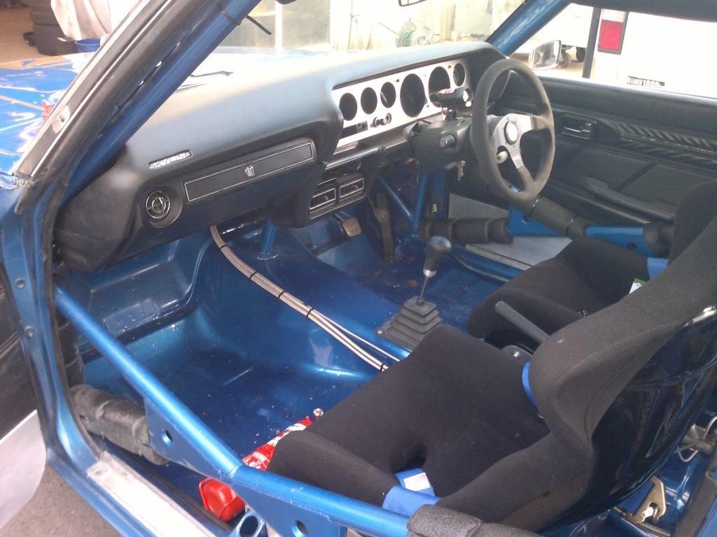

Did you use a custom loom/ wiring for the car? And did you have to cut the dash to fit the roll cage?
