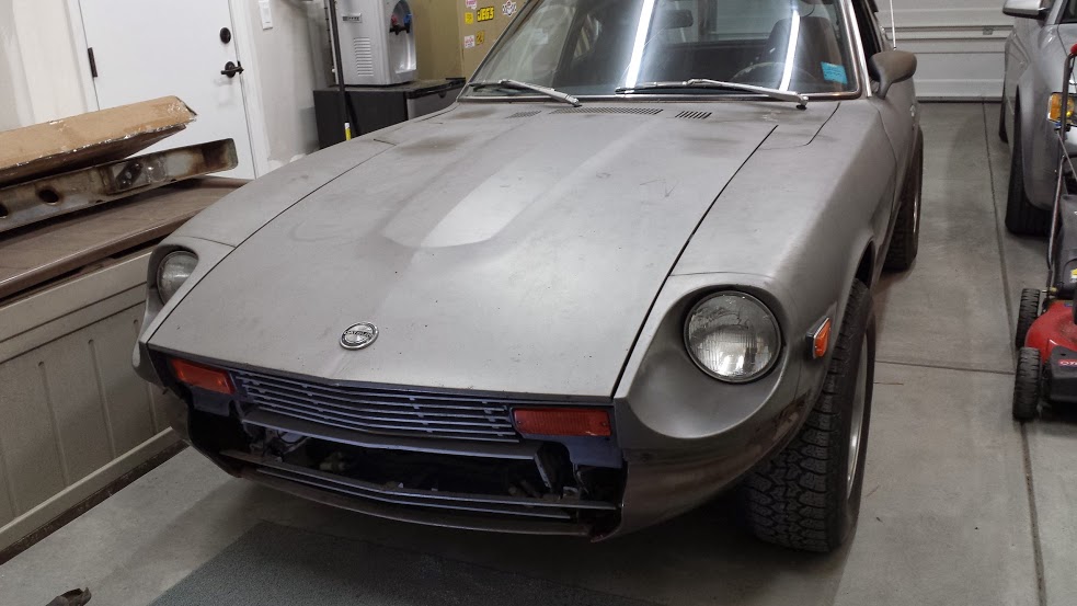

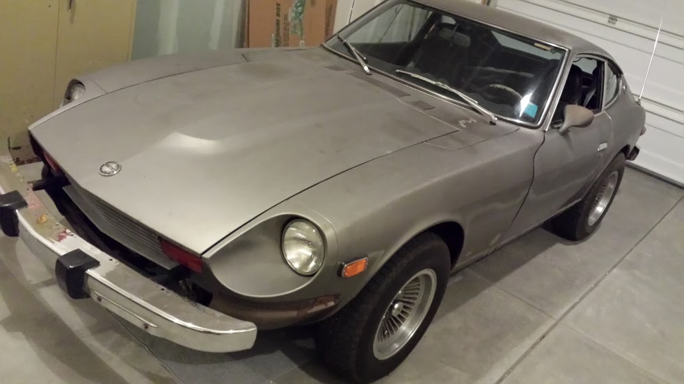

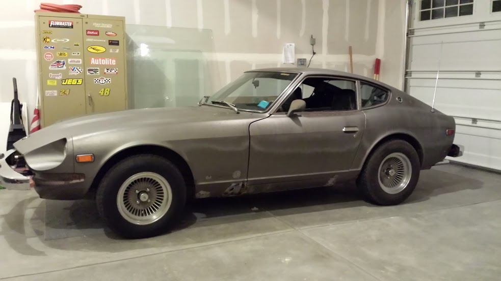

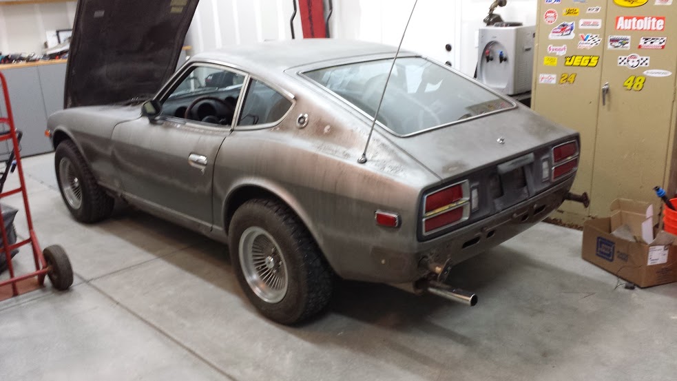

Here she is the day I brought her home.

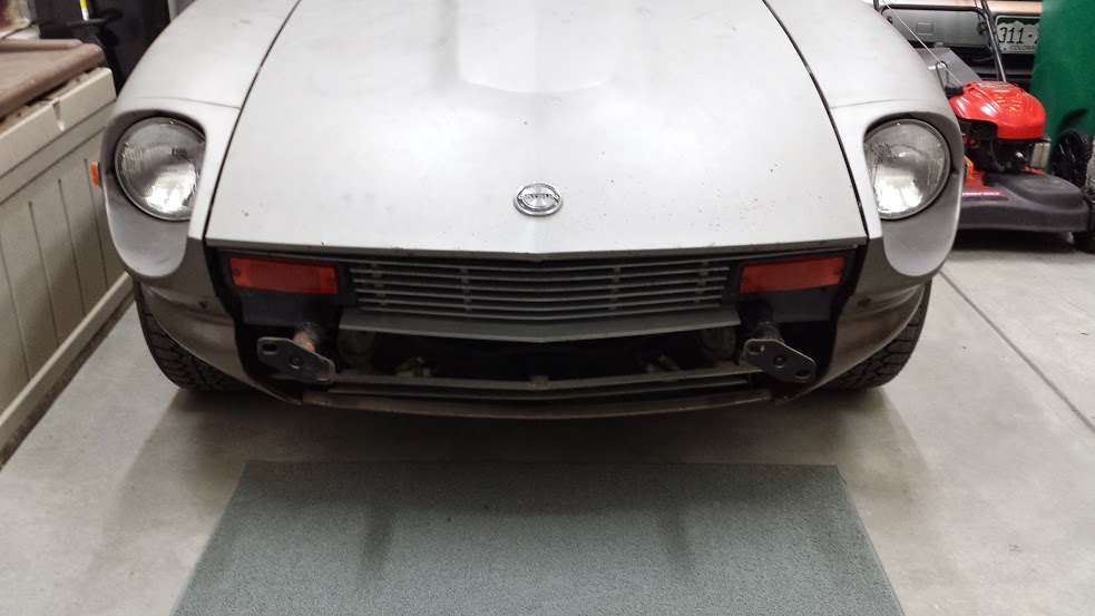

First thing I did was remove the front bumper
And the brackets

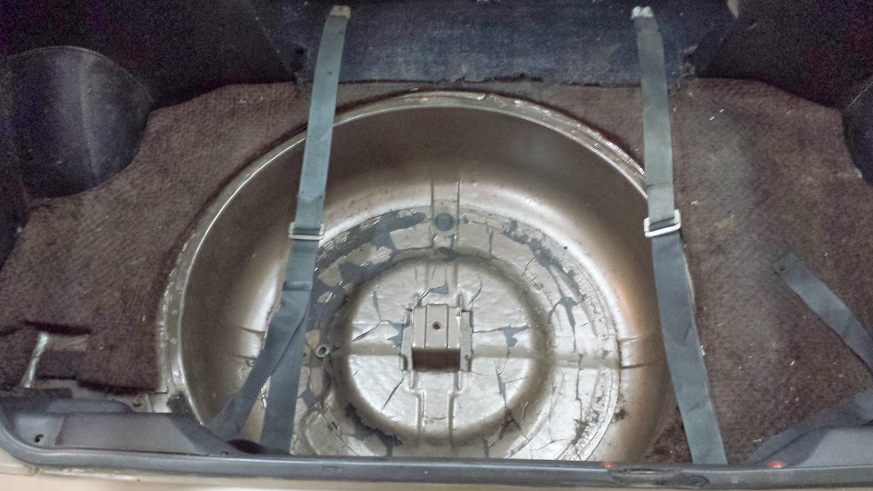

Spare tire area looked good so thats a good sign.

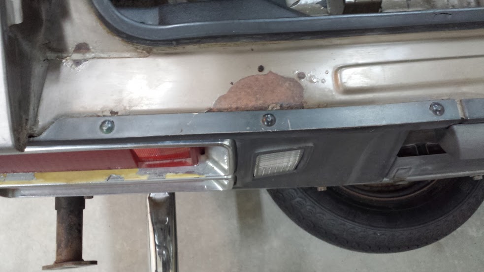

Some rust on the rear hatch.

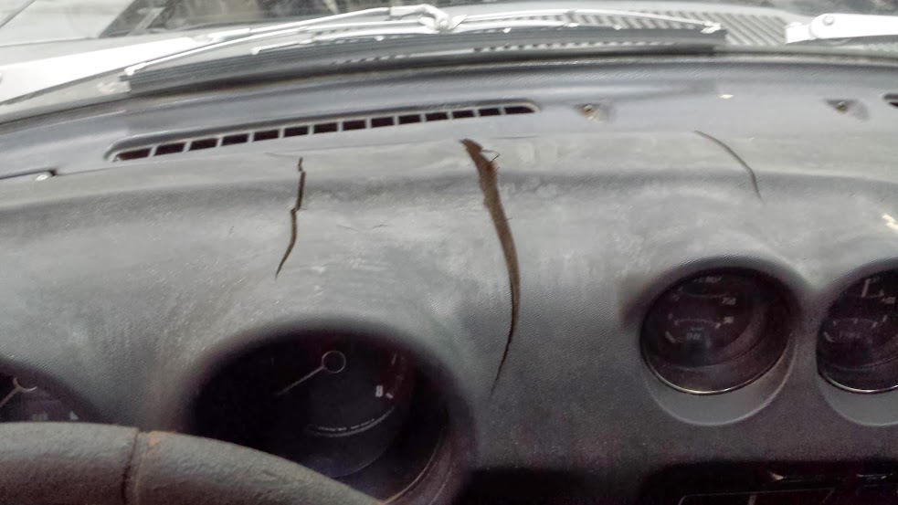

Dash has the normal Z cracks.

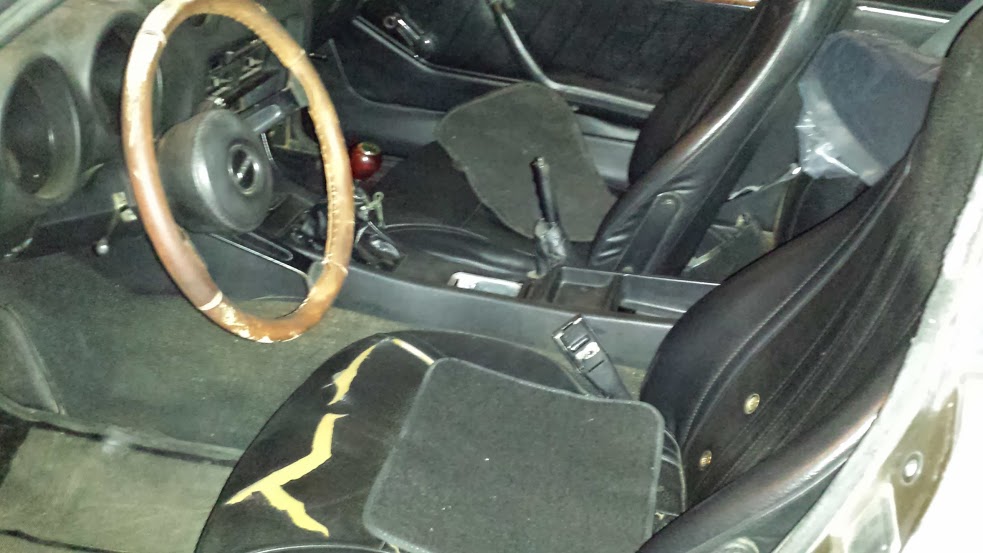

Interior is rough but complete.

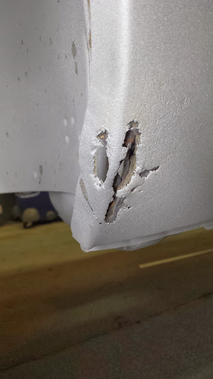

Fenders need to be replaced

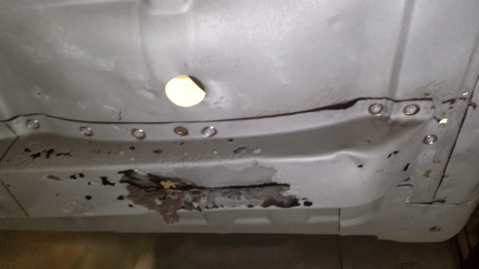

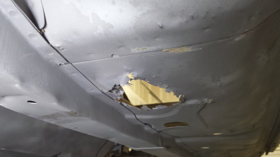

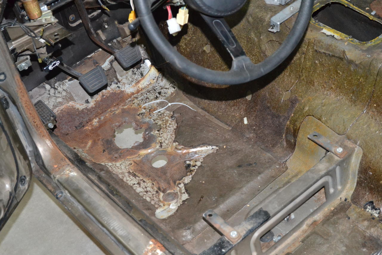

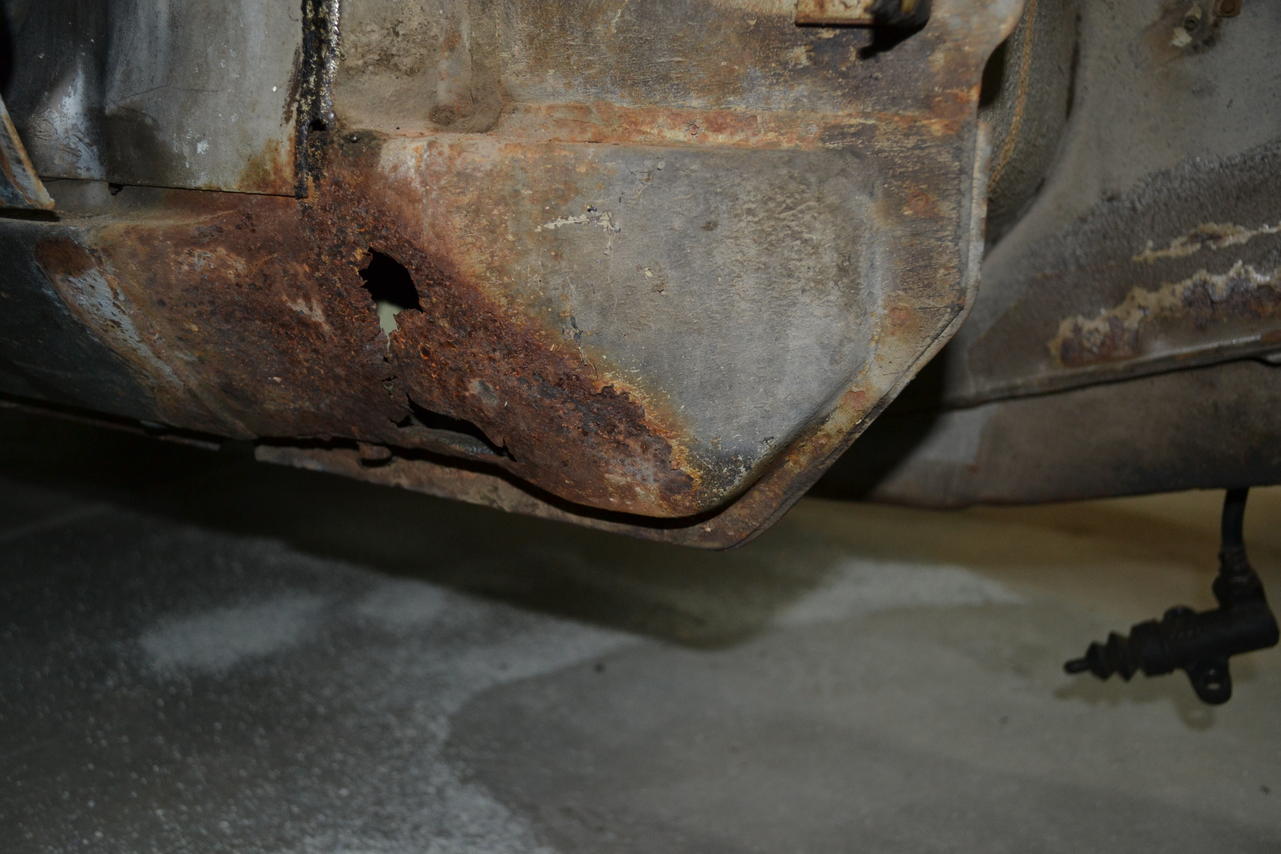

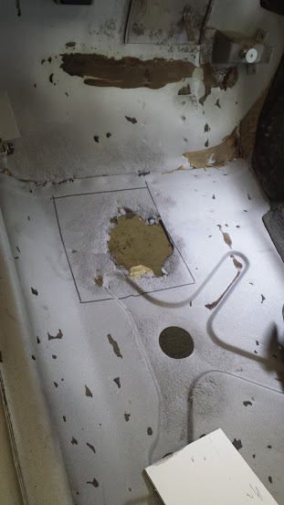

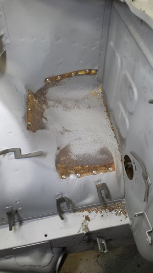

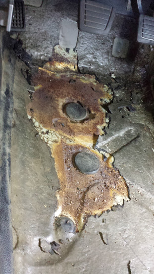

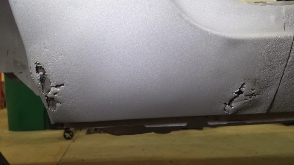

Drivers floor pan is pretty bad.

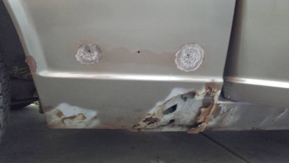

Some more rust

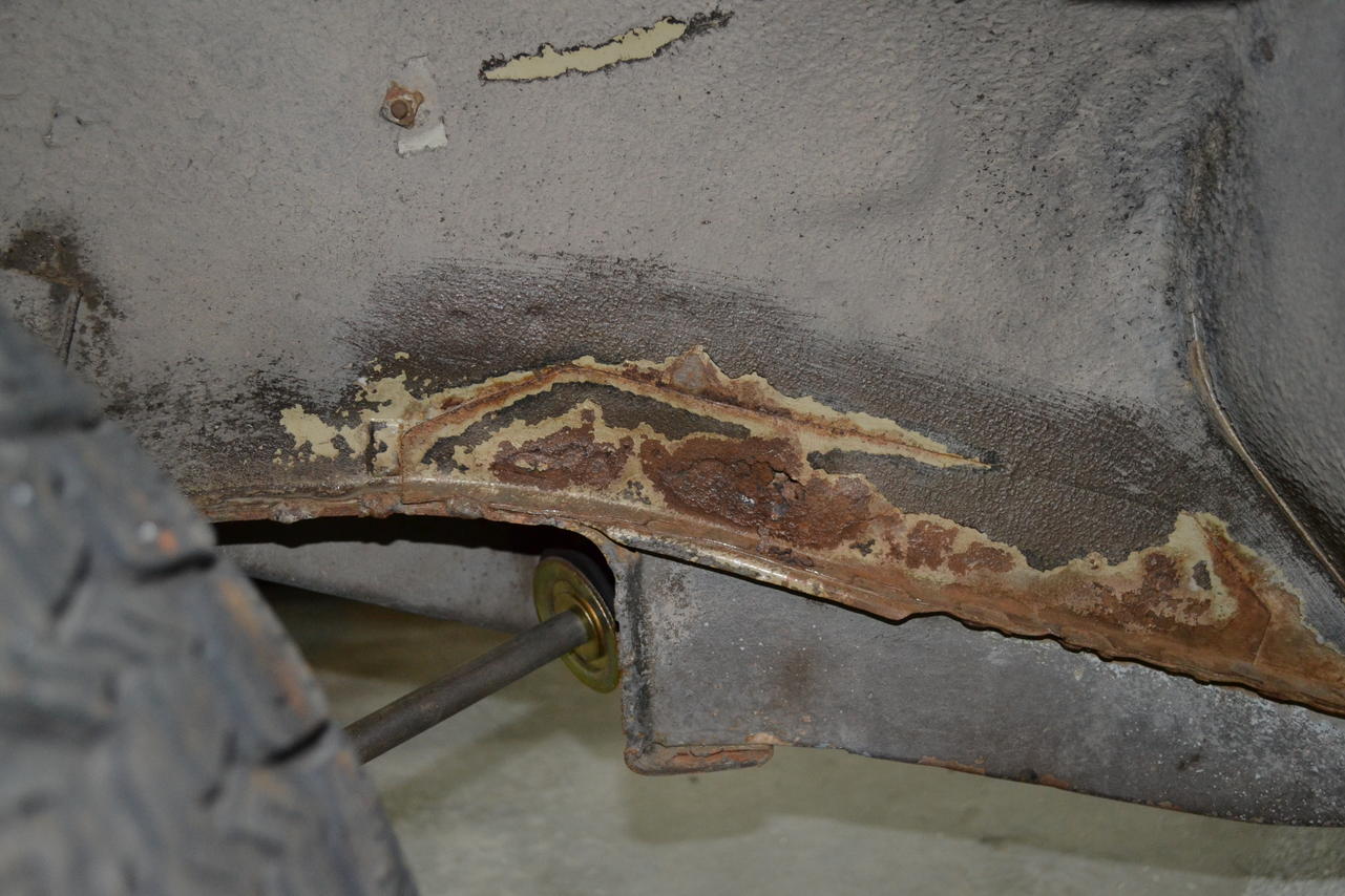

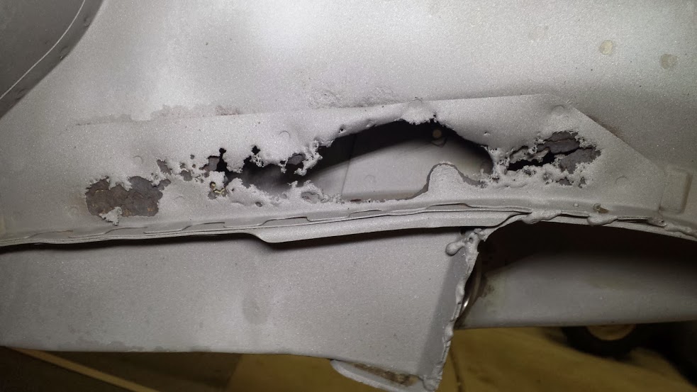

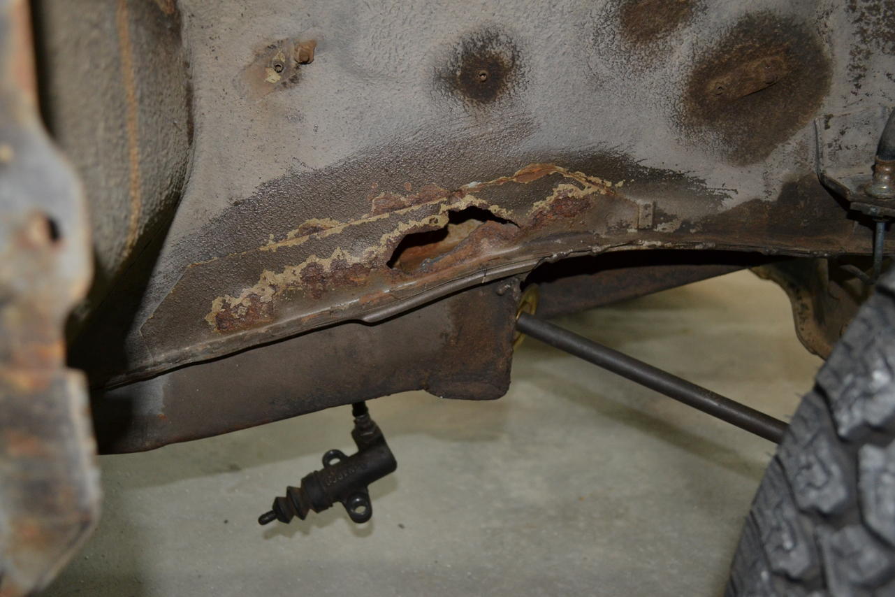

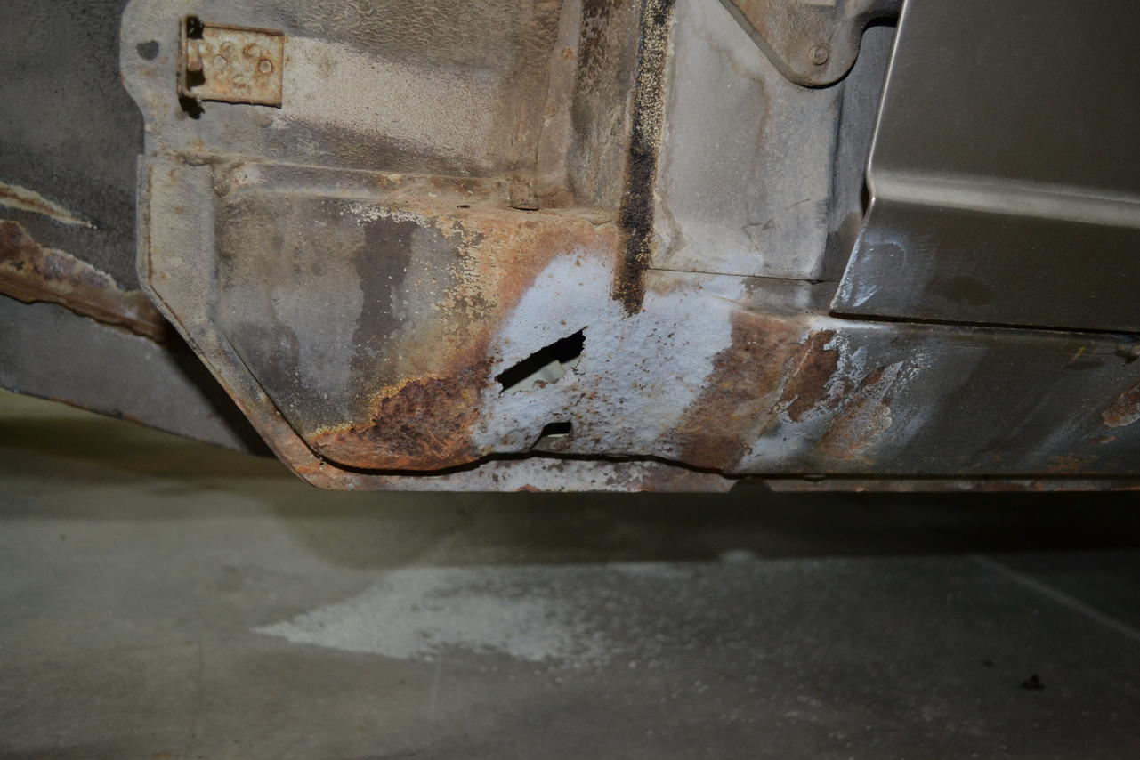

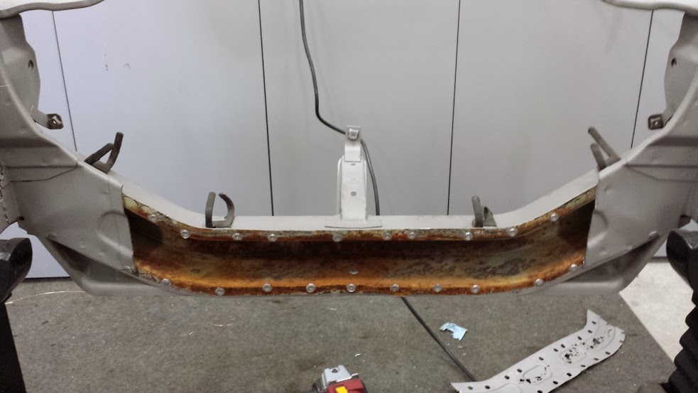

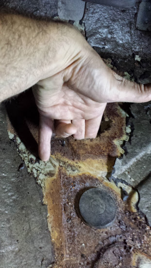

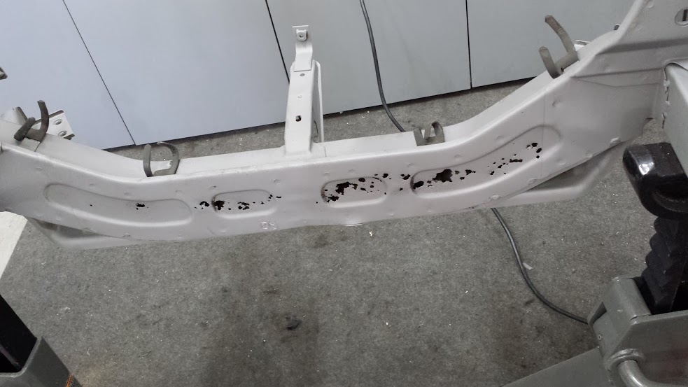

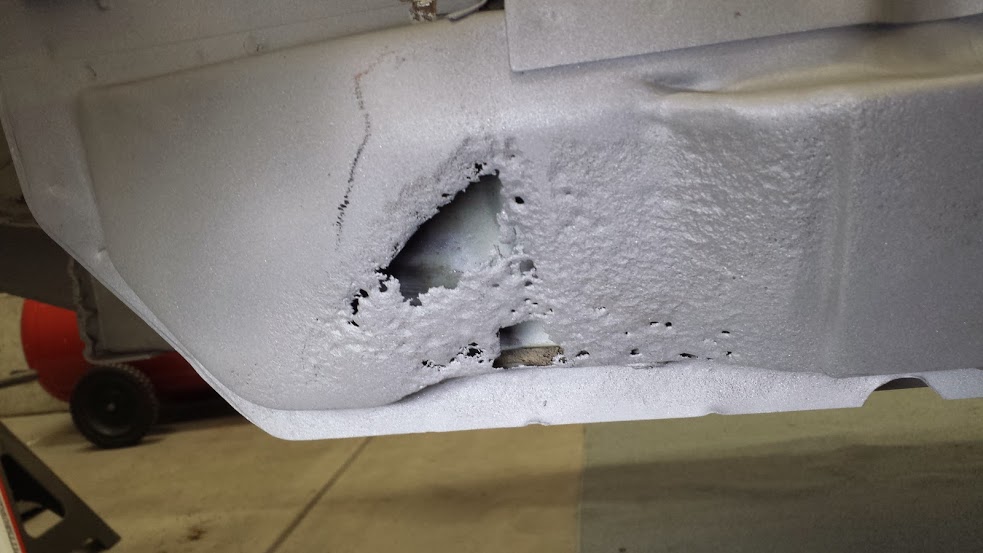

The drivers frame rail is rusted, both frame rails in the fender wells are rusted, the battery tray is pretty bad, and the rockers are rusted as well.

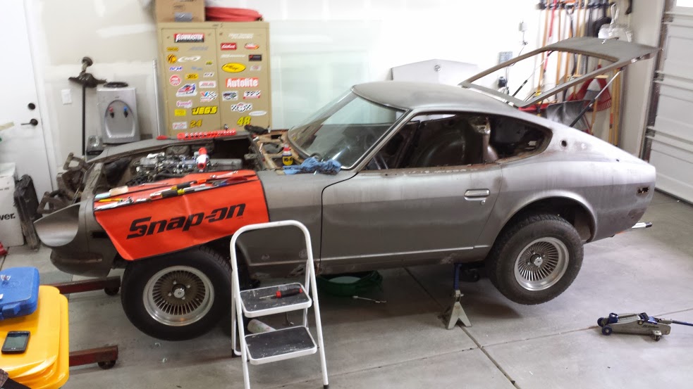

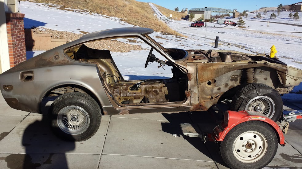

There are definitely cleaner, more rust free Z's out there but it could be worse. I decided to move forward with the project and began to do a complete tear down for a full restoration.

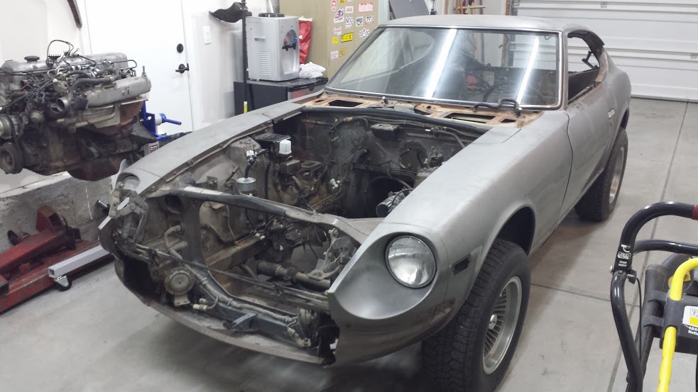

Most of the interior is removed.

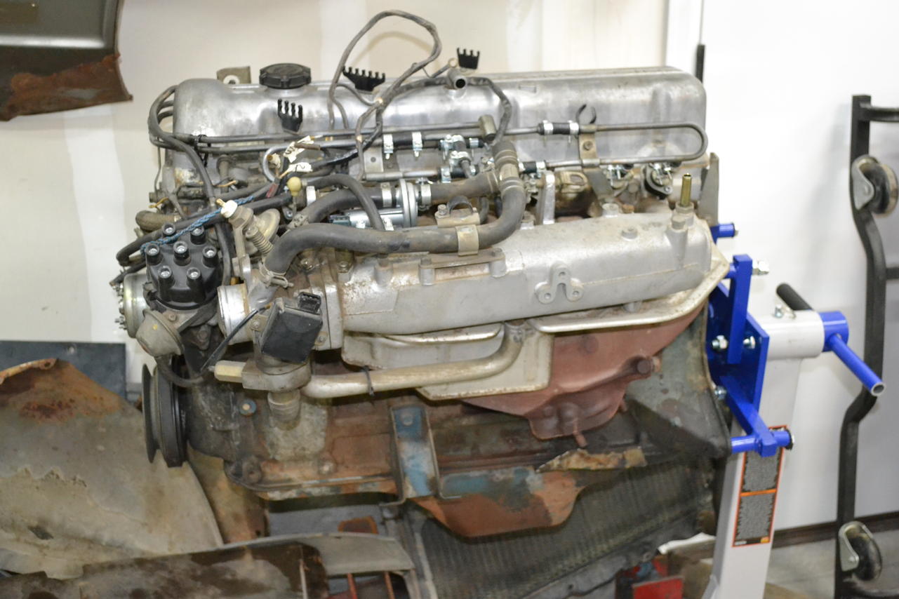

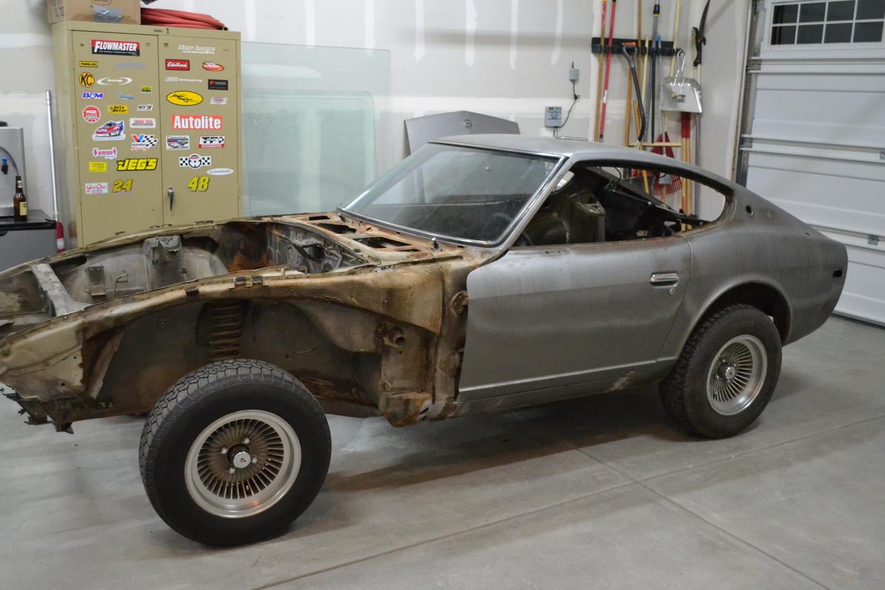

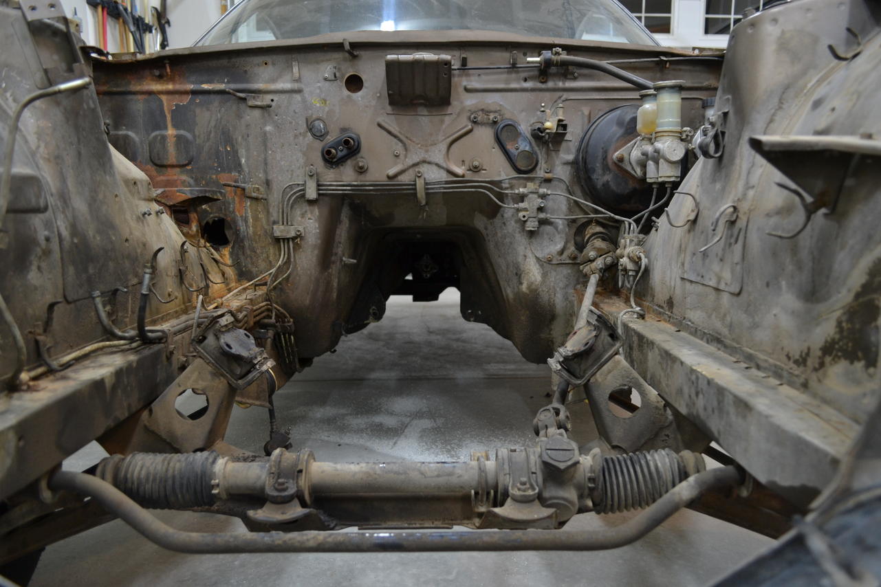

Now its time to get the motor out

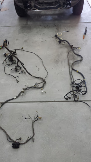

Removed the wiring harnesses

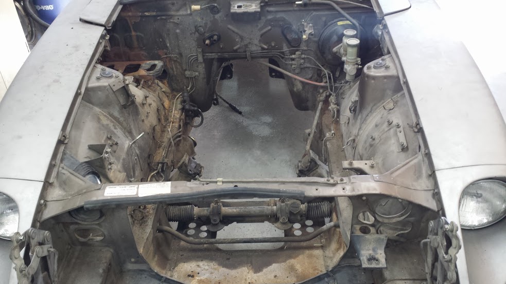

Removed glass and front body panels.

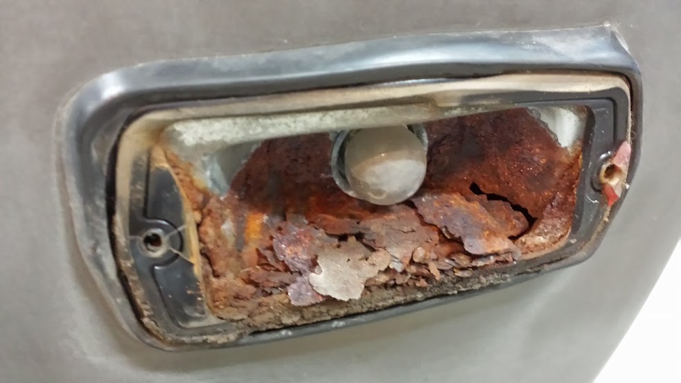

Some rust porn for you weirdos LOL

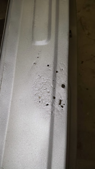

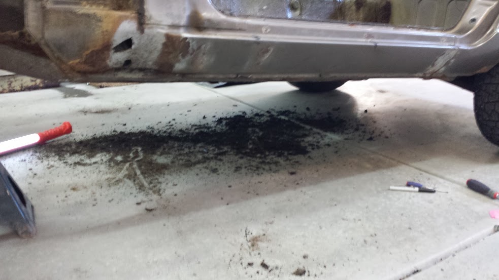

I scraped as much of the undercoating off as I could. This was fun....

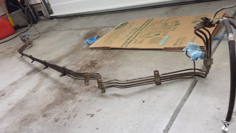

Removed the fuel/brake lines.

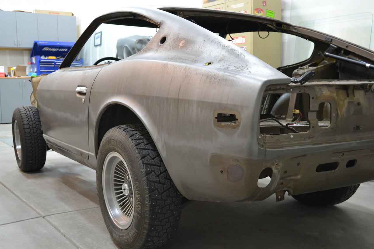

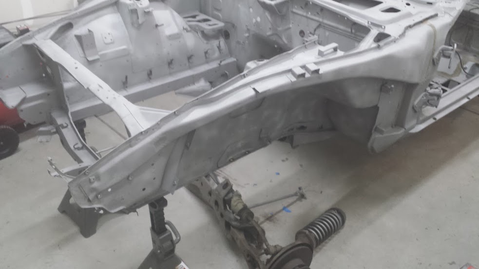

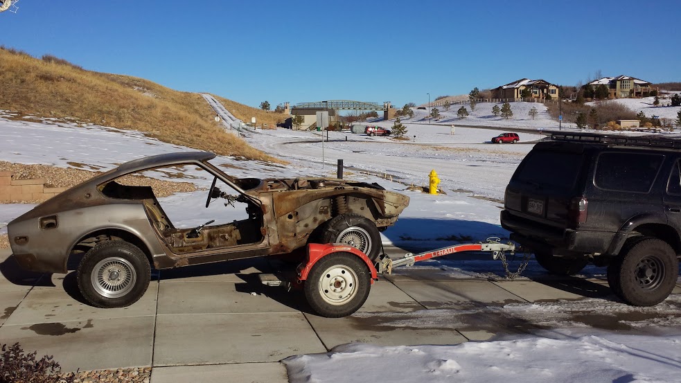

Now shes ready to go to the media blaster.
She looked pretty pathetic when I left her there so I took a quick pic.

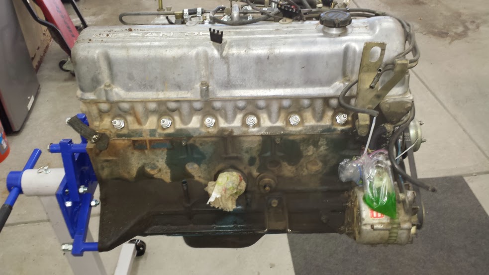

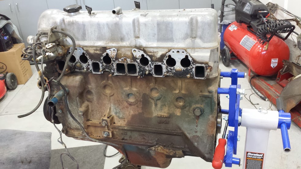

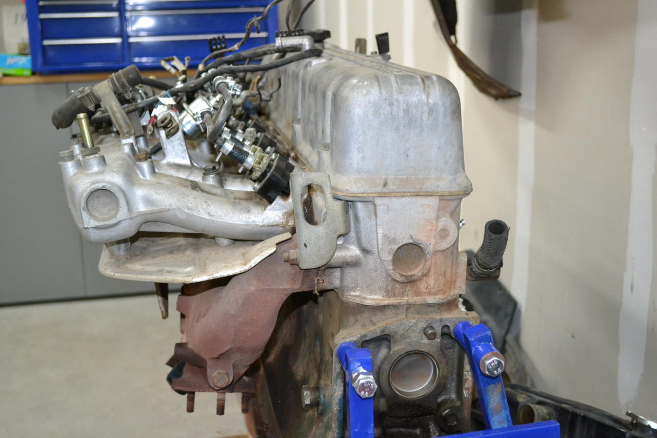

So with the car gone for awhile I turned my attention to stripping down the motor. I will be shipping it out to Rebello for a high compression 3.0 stroker set up.
All parts were labeled and sorted with ziploc bags.

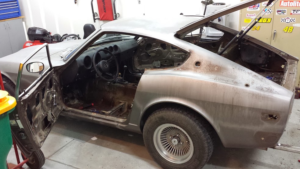

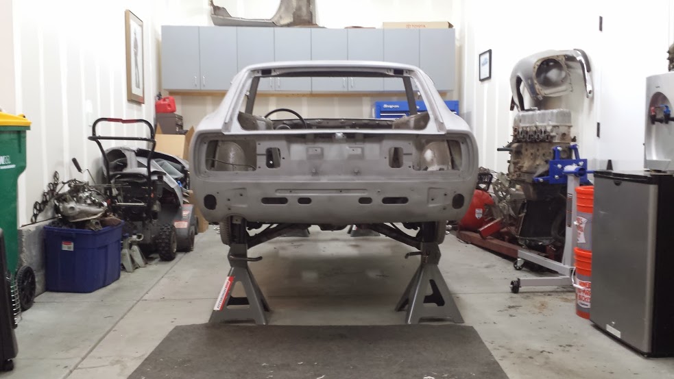

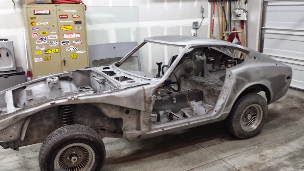

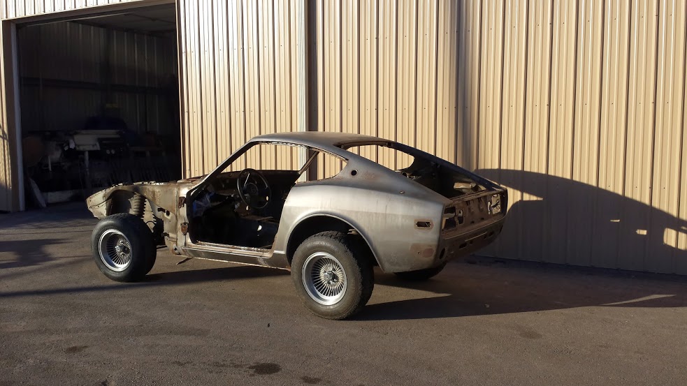

I got the car back after a week. They did a really thorough job. It was nice to finally work on it without getting dirty and greasy.

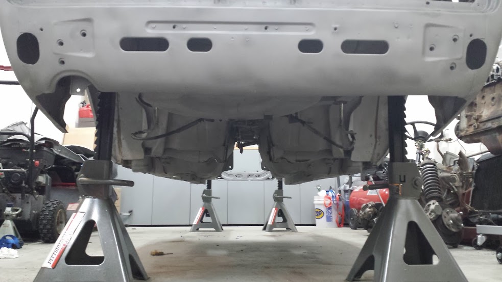

Then I worked on removing the suspension.

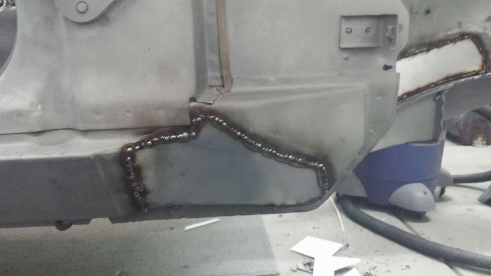

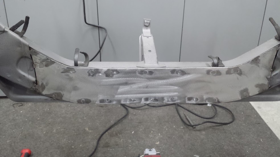

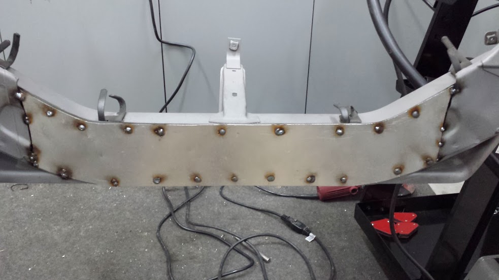

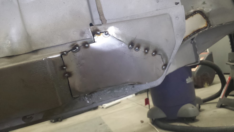

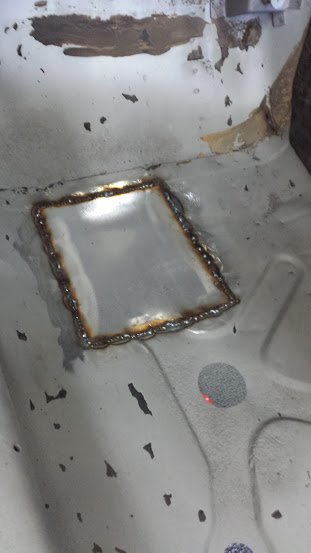

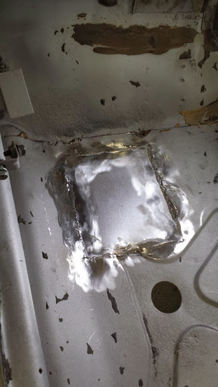

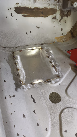

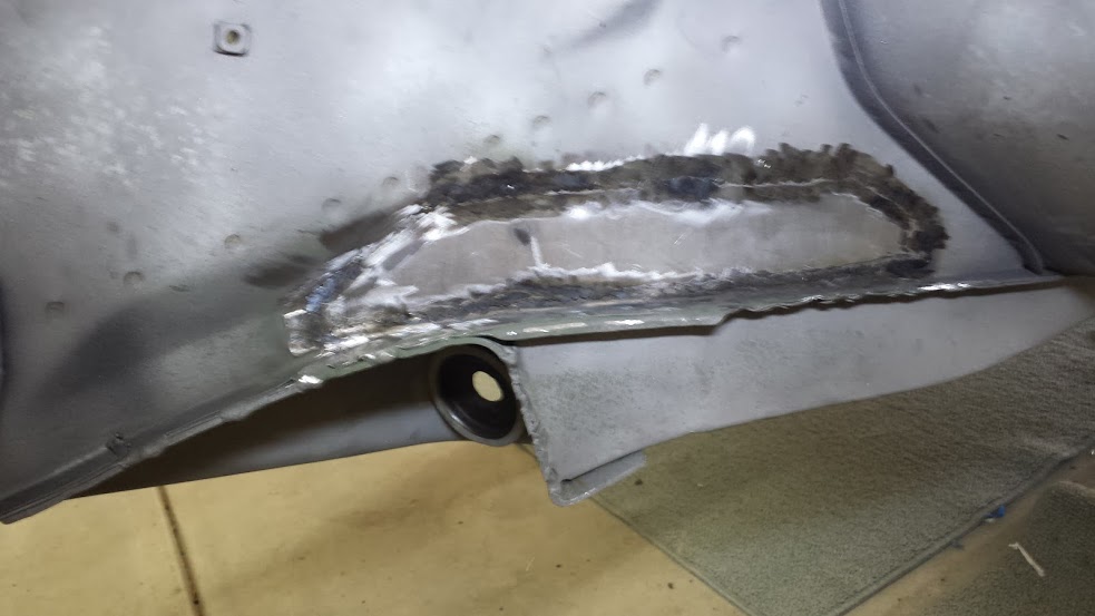

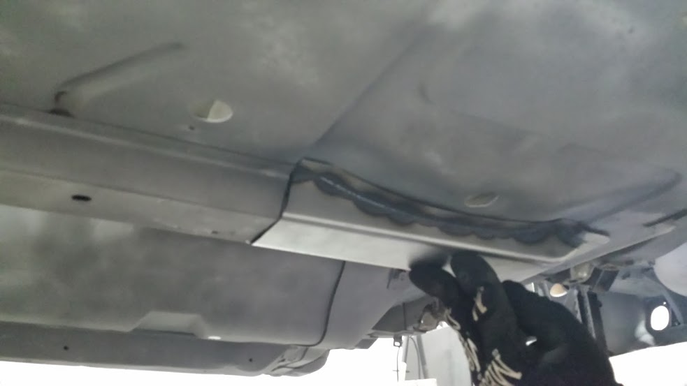

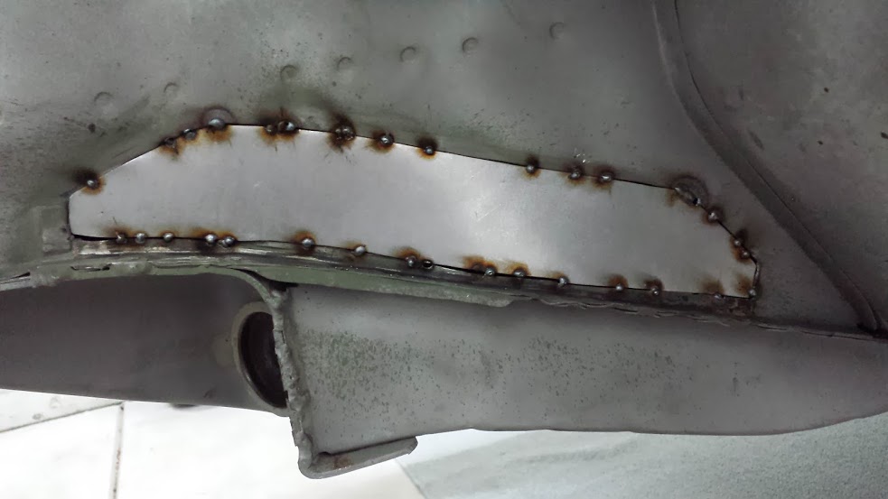

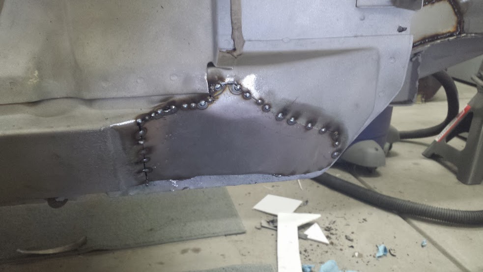

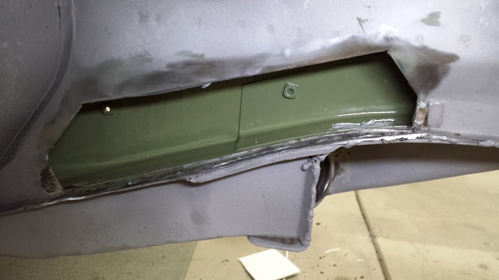

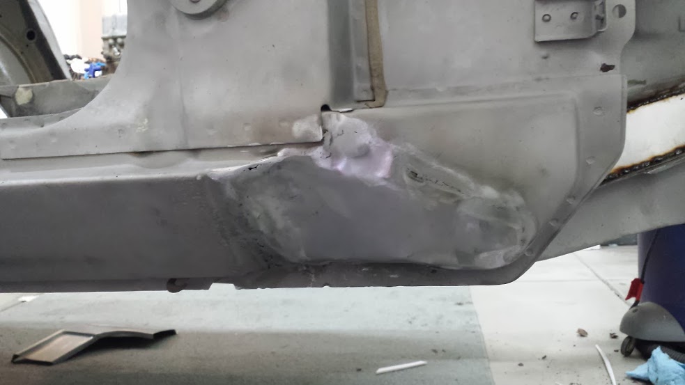

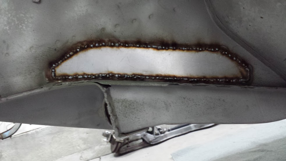

Next I started working on the metal work. Now I haven't welded anything since shop class in high school but I was eager to learn so I went out and bought a welder and got to work!
Heres some welding shots

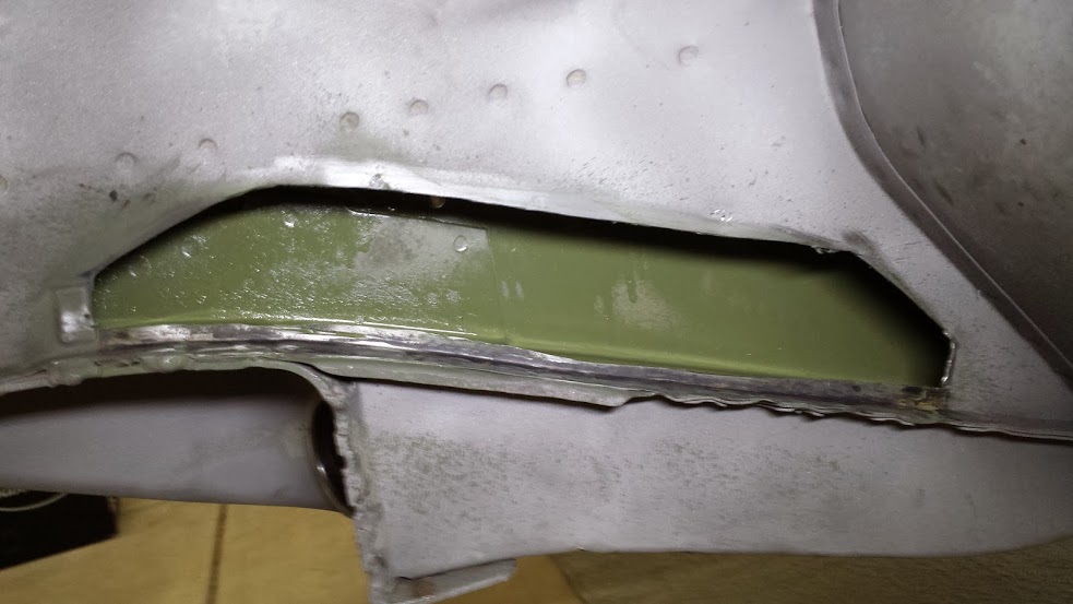

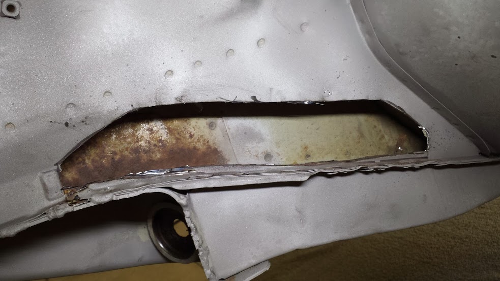

More rust repair pics

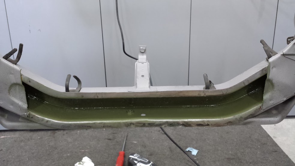

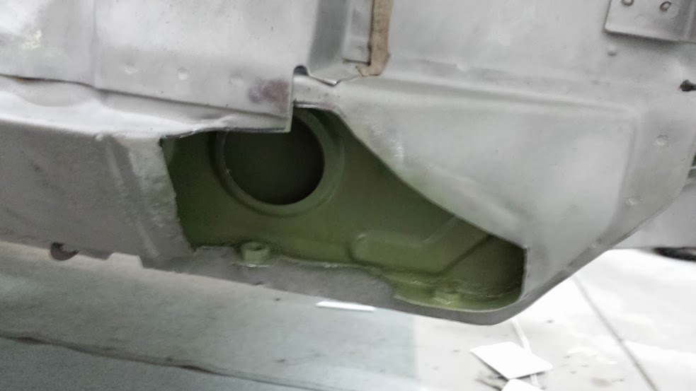

All interior frame areas were covered with Eastwood's Internal Frame Coating for rust protection

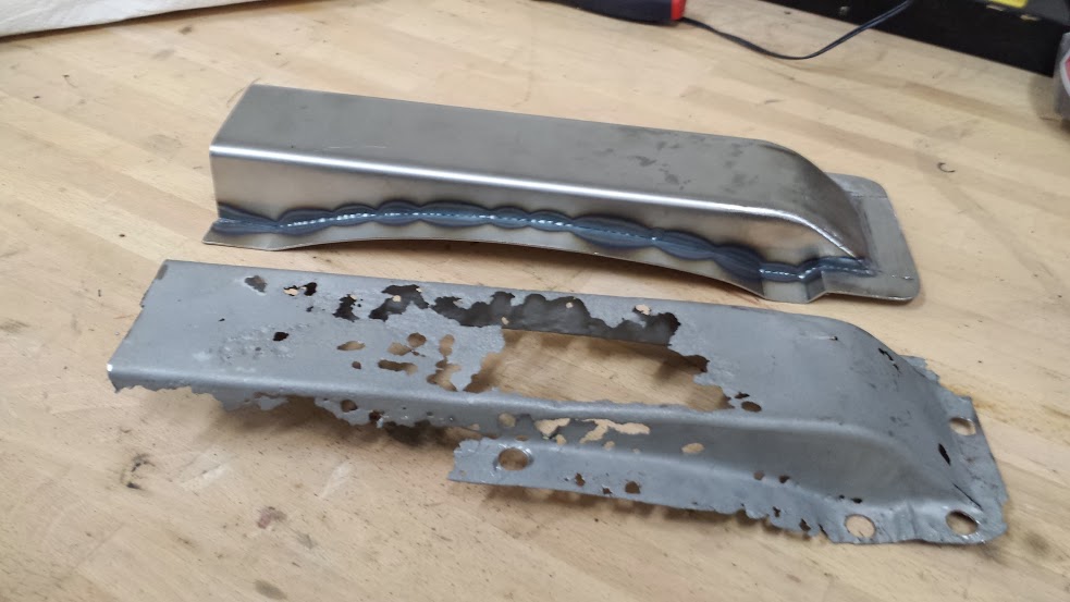

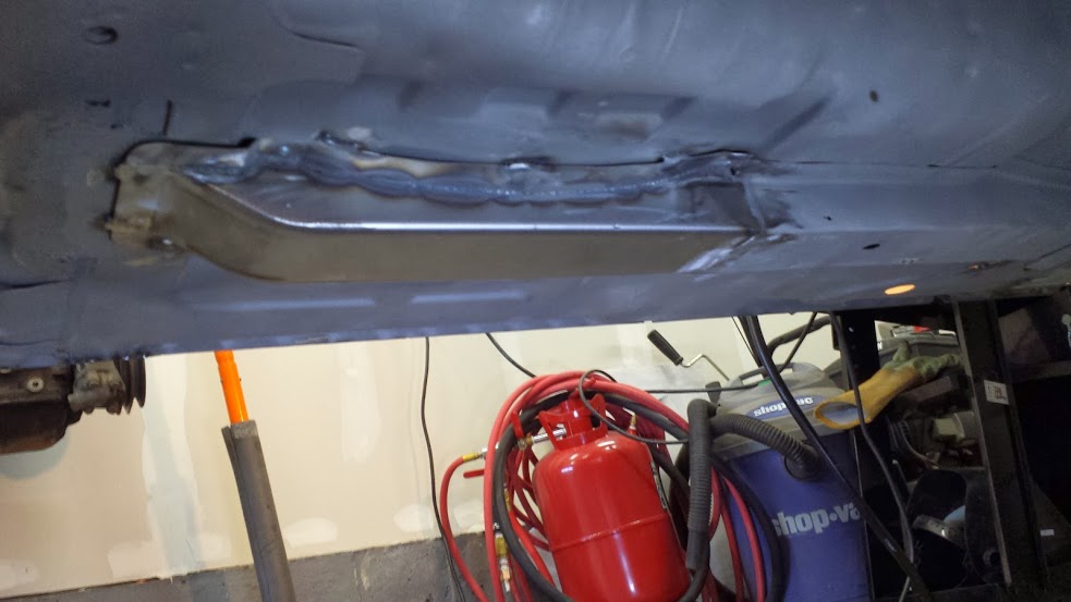

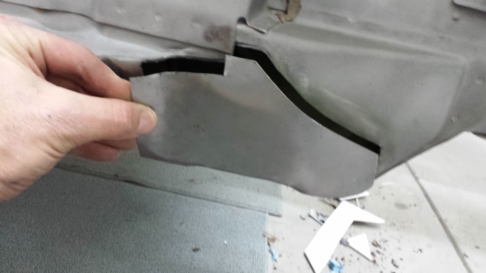

Heres the damaged frame rail.

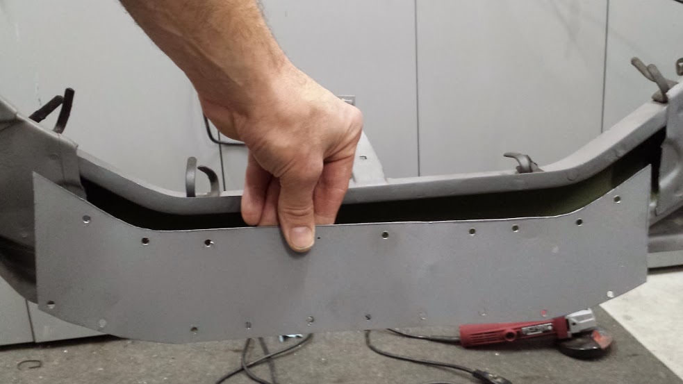

I got a new piece fabricated by a local fab shop
