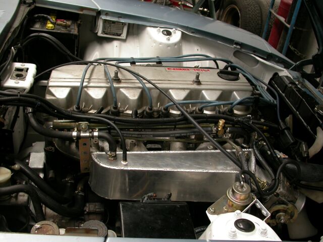

here is a picture of a RB30 260Z with a custom made intake manifold. This manifold was made by Per4manz Turbochargers here in Western Australia.
Hope this is of help to you.
