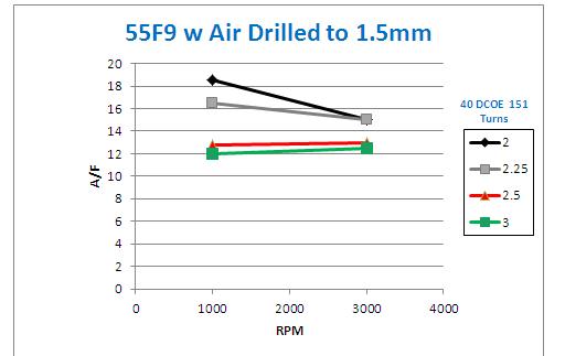

DCOE Progression and Idle enrichment relationship
observation:
2 to 3 turns on idle enrichment changes idle A/F 7 points
2 to 3 turns on idle enrichment changes cruise (3000rpm) A/F 3 points
A/F at cruise and idle is balanced ~ 2.5 turns but rich at ~ 12.5
A/F is richer at idle than at cruise at greater than 2.5 turns out.
My goal is get idle and cruise balanced ~ 14 to 15 A/F....waiting on 45 idle jets as next step.
