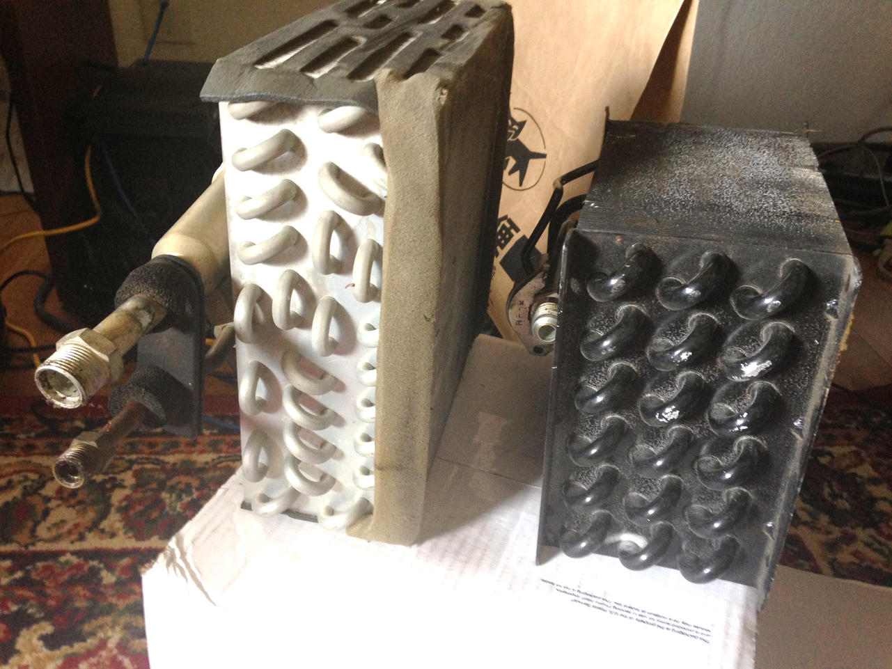

here is a side by side comparison.
i'de bet the cooling is way better
with the zx but fitting it is another
matter. plumbing should be able to
use zx copper lines. i purchased this
one off ebay for 25 bucks. they can
be had for cheap.
