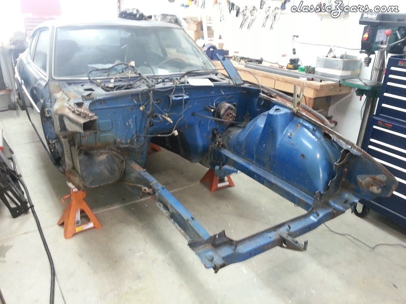

Not bad progress if I do say so myself considering she looked like this not much longer than two months ago:
