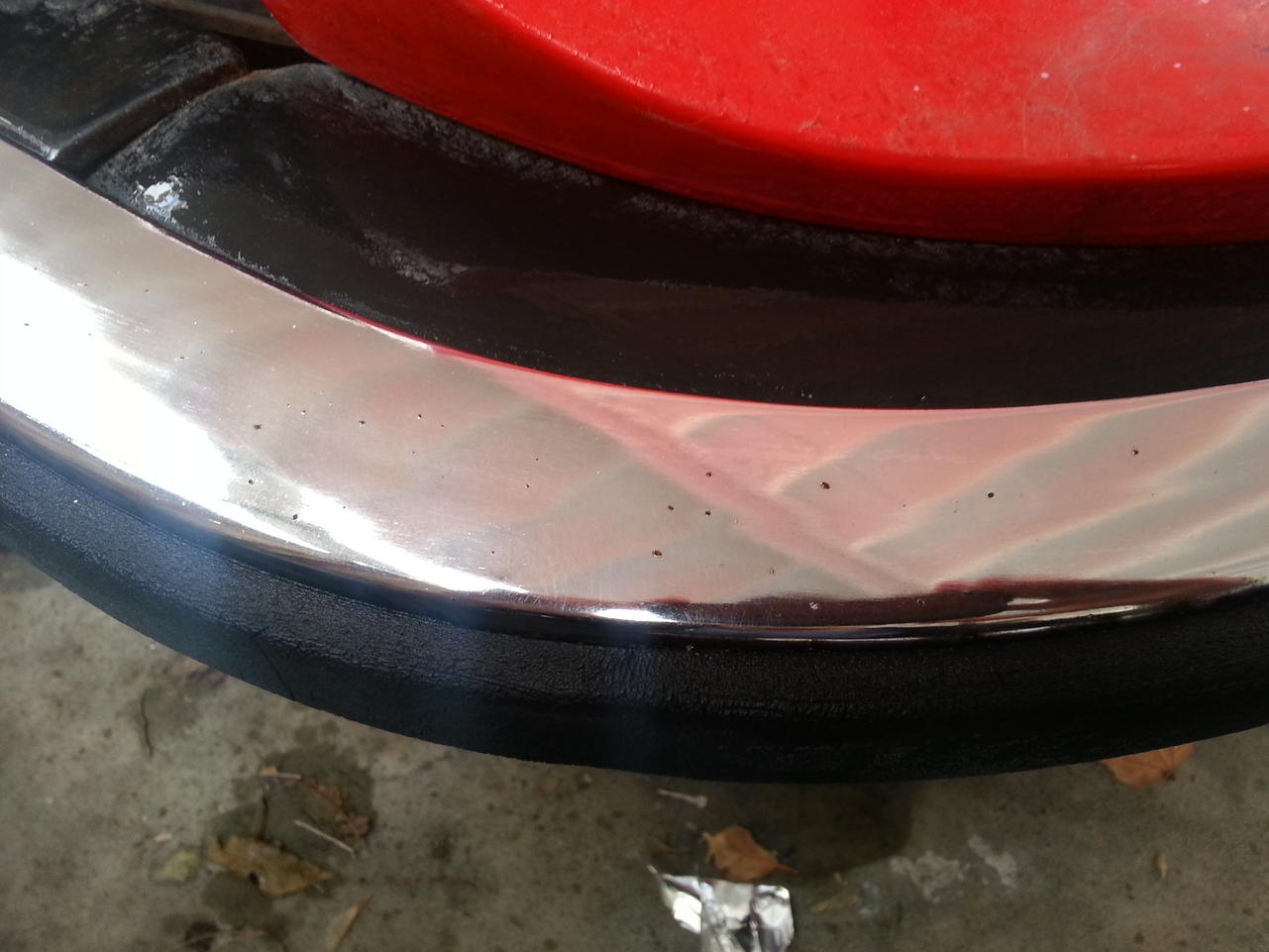

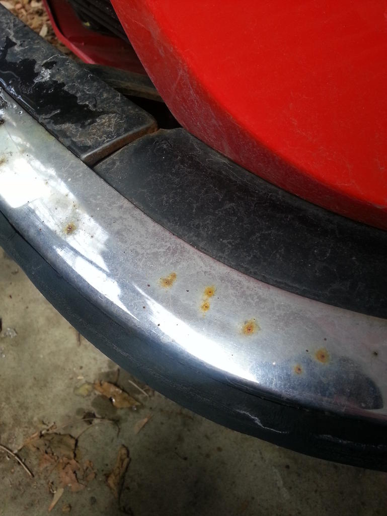

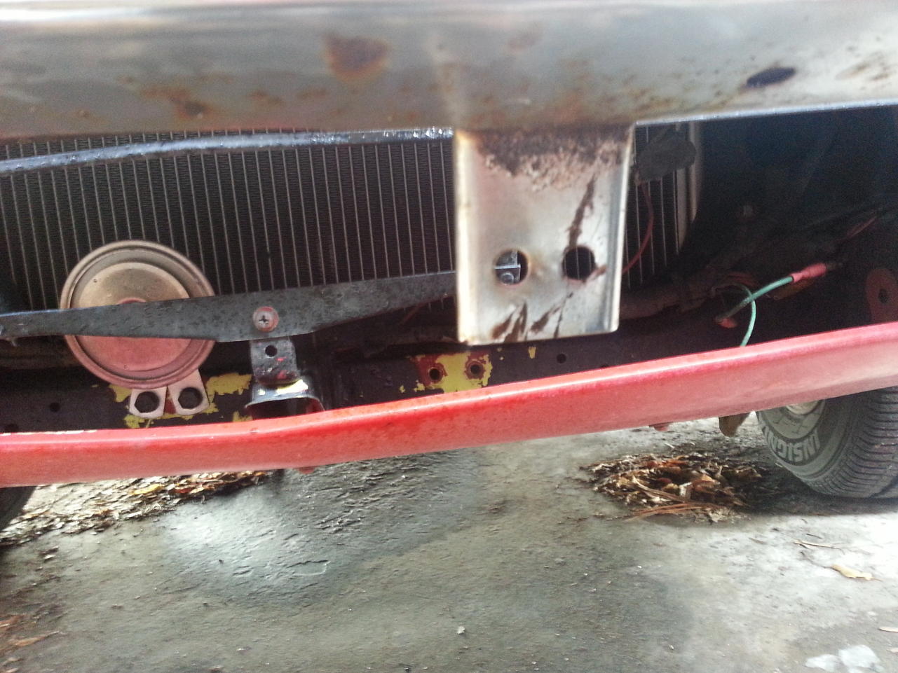

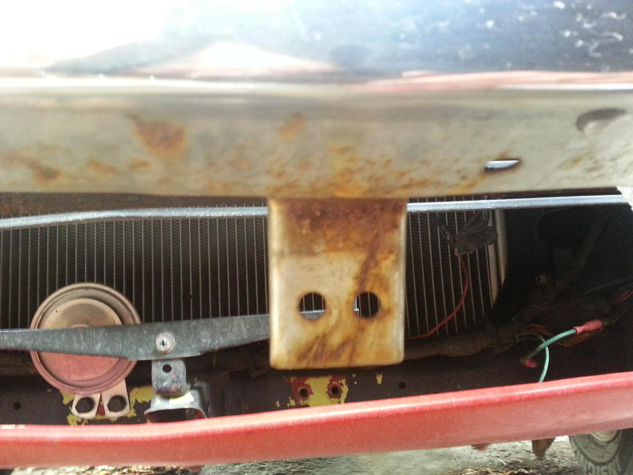

Okay folks, the results are in - and rather impressive. With just minor scrubbing, water and tin foil I was able to greatly reduce the amount of surface rust.
Its not working miracles, as you can see in the second photo, once its pitted its pitted, but I would recommend this easy method to anyone just needing routine touch ups to their chromed steel bits.

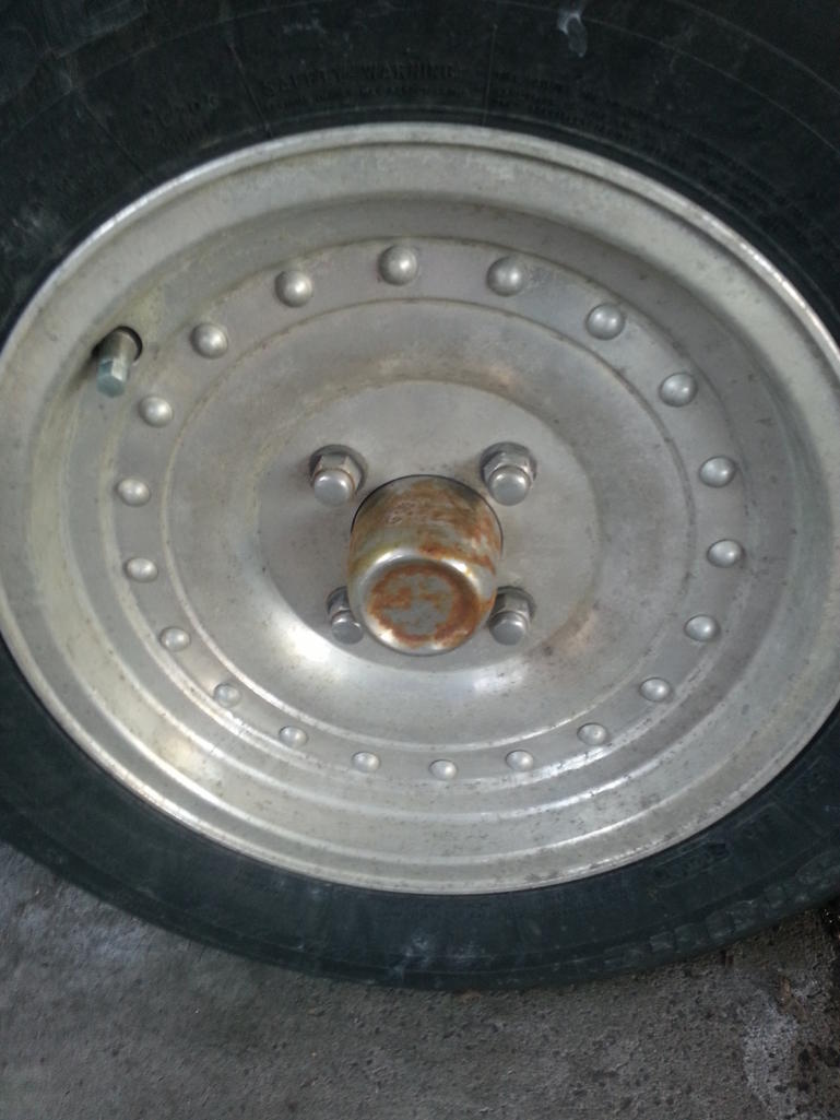

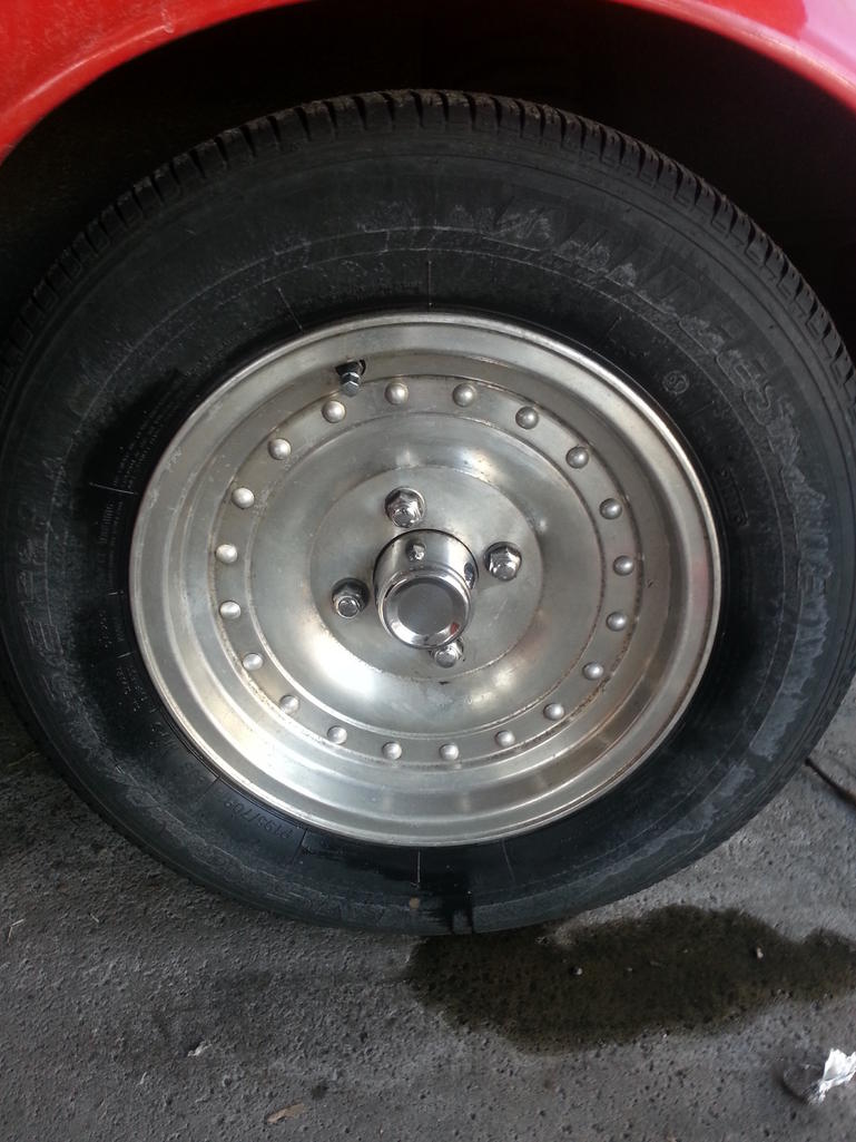

Gave it a go on the chromed bit of my wheels (just the center cap and bolts). Good results. Now I just gotta polish that aluminum!
