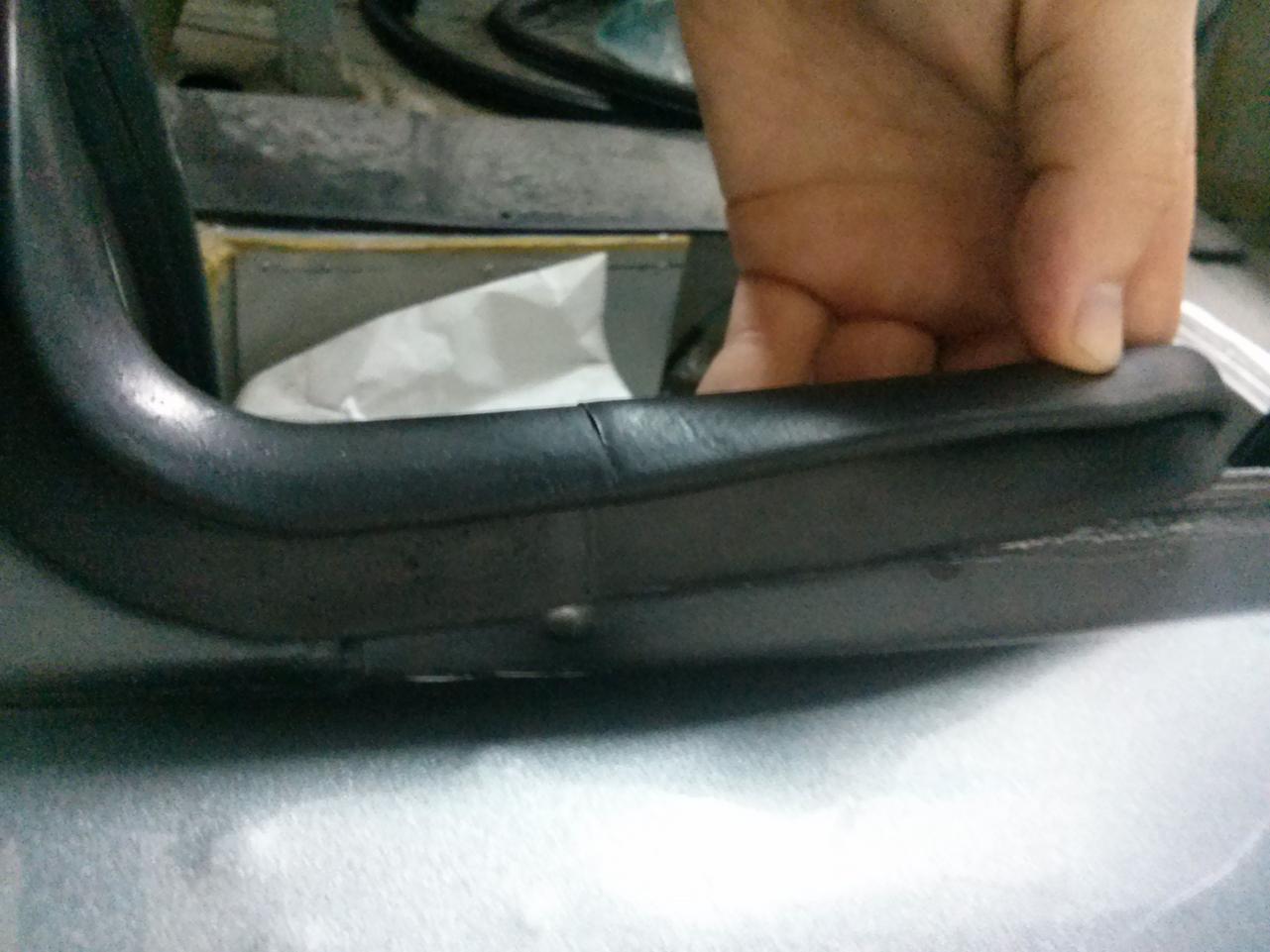

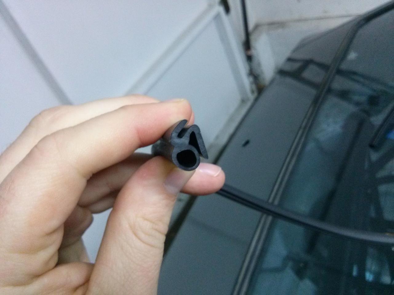

This one shows the actual top outer piece from MSA. It has a circle running around the entire thing. And it has 2 places where you COULD put the stitch welding into.

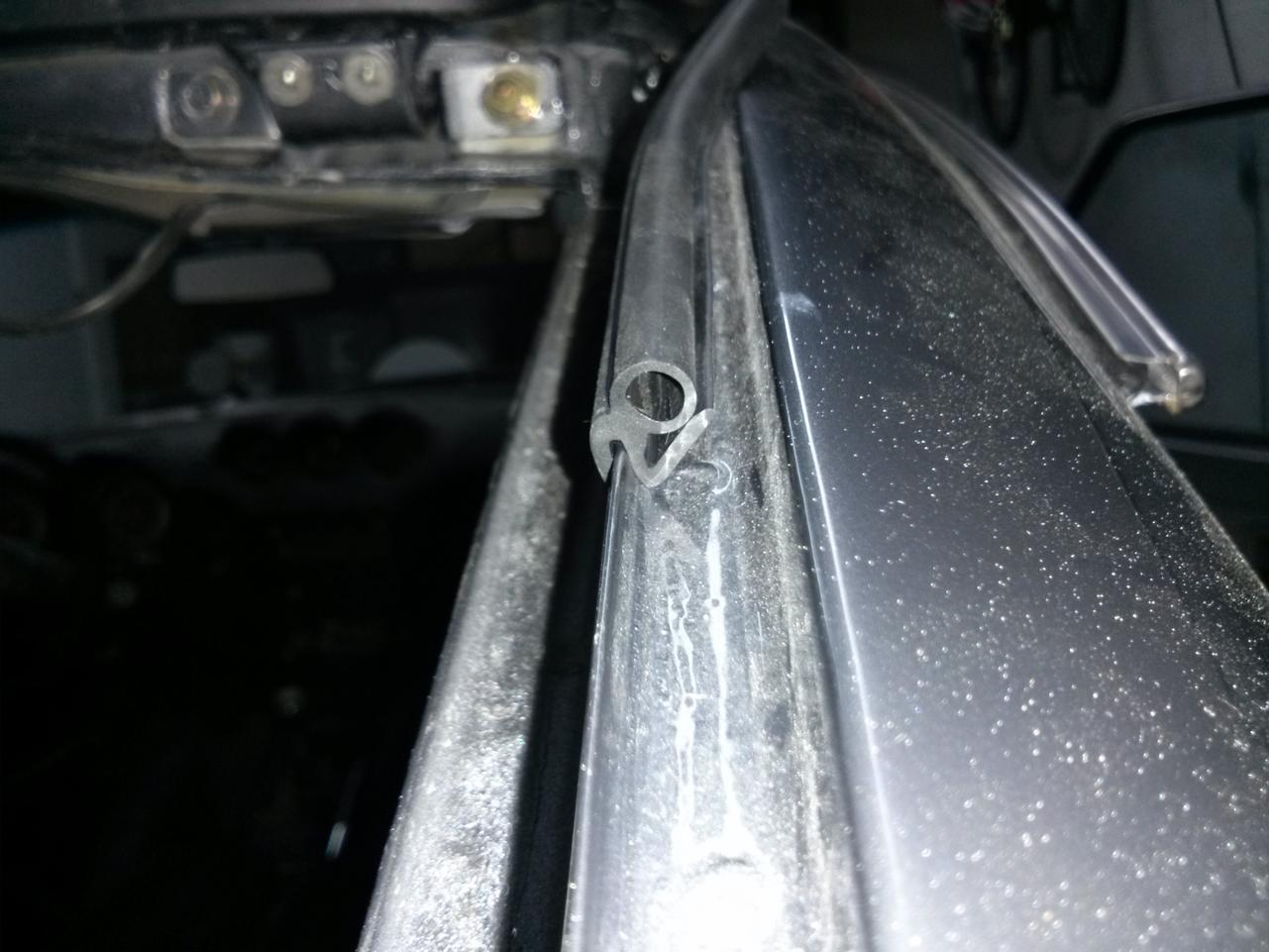

Here I show putting the skinnier but stronger/grippier part of the weatherstrip onto the stitch weld. This feels right, but I just want to be sure before I put on the cement to hold it.

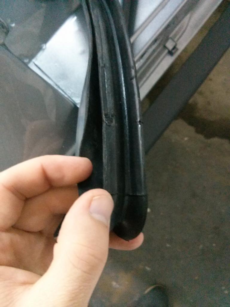

Here is the outer WS that goes on the same seam as the previous one, but it just runs from the bottom up to the previous one. I feel like the pinched part should be put on the stitch weld, and the longer part should point towards the actual fender to create a sort of 'channel' for the water to flow down.

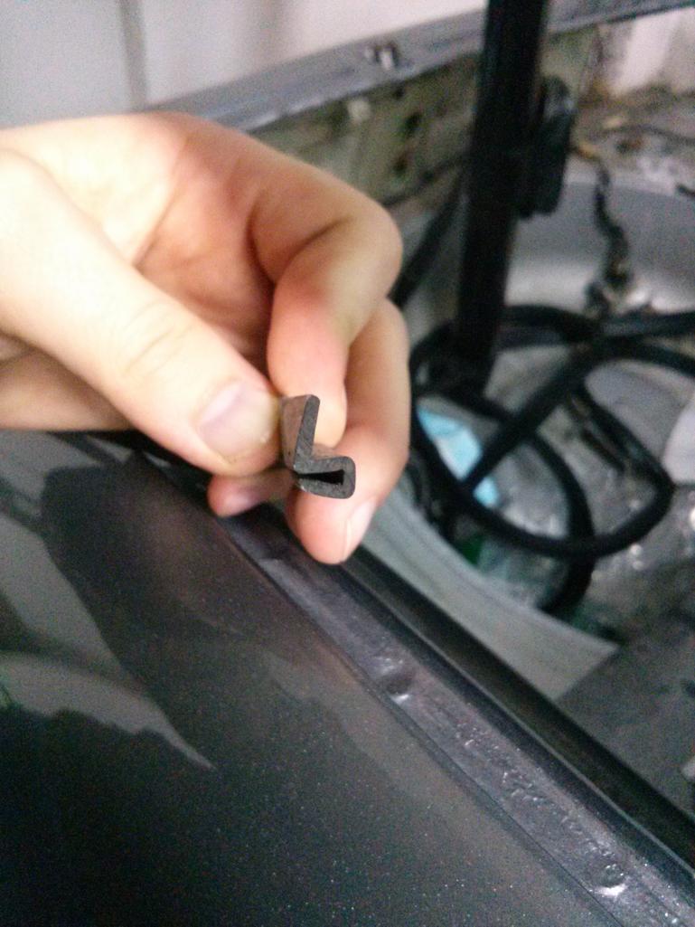

Finally you have the inner WS. This has a flap that seems to grip to the stitch weld. I just want to make sure that I have it on correct. You can see my finger moving the flap outward in this pic.
Here I've put in on with the flap on the stitch, with the rest pointing OUT towards the fender.

You are doing a good job, hope you'll have better inner W/S than i did (from MSA) it was 5" too long and it started to leak almost instantly.

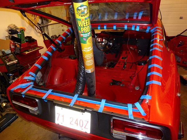

For the big 1 piece seal, I applied a first pass of sealant lightly then taped it into position.
Once it set, I ran a second pass with more sealant.

I like that idea! I'll be using it for sure!!! :-)
Do I have the correct fitment for the top outer tho? Does my picture show it the way it should be attached/setup?
