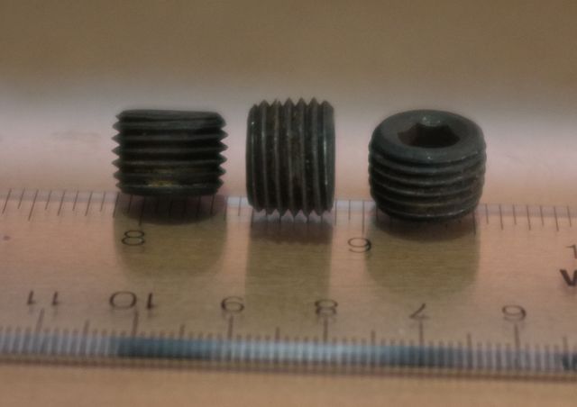

I'm pretty sure that's what I used on a '73 exhaust manifold many moons ago. Stack two plugs in each hole, only torquing down the 2nd to make them easier to remove. Here's a picture of a couple of the plugs I happened to save.
Thanks for the confirmation. I ended up going with a 1/4 inch BSPT steel pipe plug with a hex head for the exhaust manifold and brass plugs with an internal hex for the intake manifold where the coolant inlet and outlet were. Now to get the old fittings to let loose their grip!
