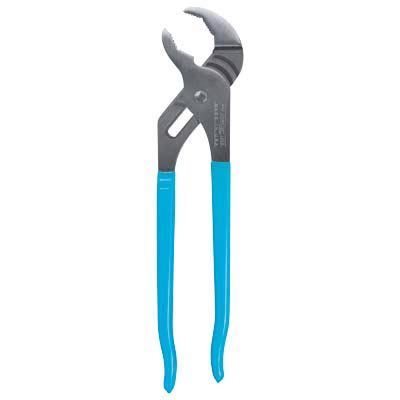

After getting the upholstery over the seat back, I used tongue and groove pliers and slip joint pliers (pictures below) to bend the hog rings to hold the upholstery in place.
