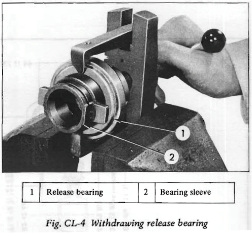

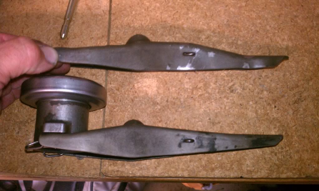

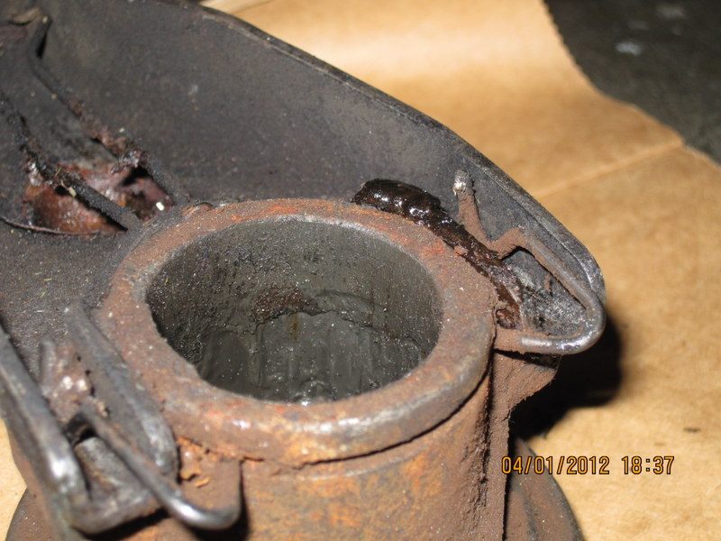

Thanks Blue. That first image is what I needed as you can't see that when it is installed. It has also confirmed what I thought about the spring in the withdrawal lever. Someone has snipped the little returns off the ends which is annoying so I hope it still retains the lever on the pivot ball. I have ordered a new one off eBay but I not looking forward to re moving the whole transmission just to stick in a clip.
I ended up assembling it all and sliding it in. Next time it will be a 1 minute job.
