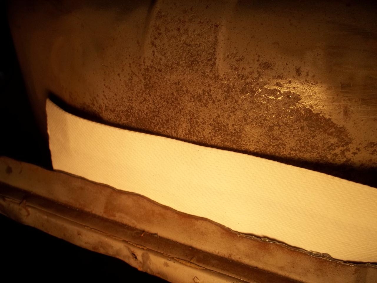

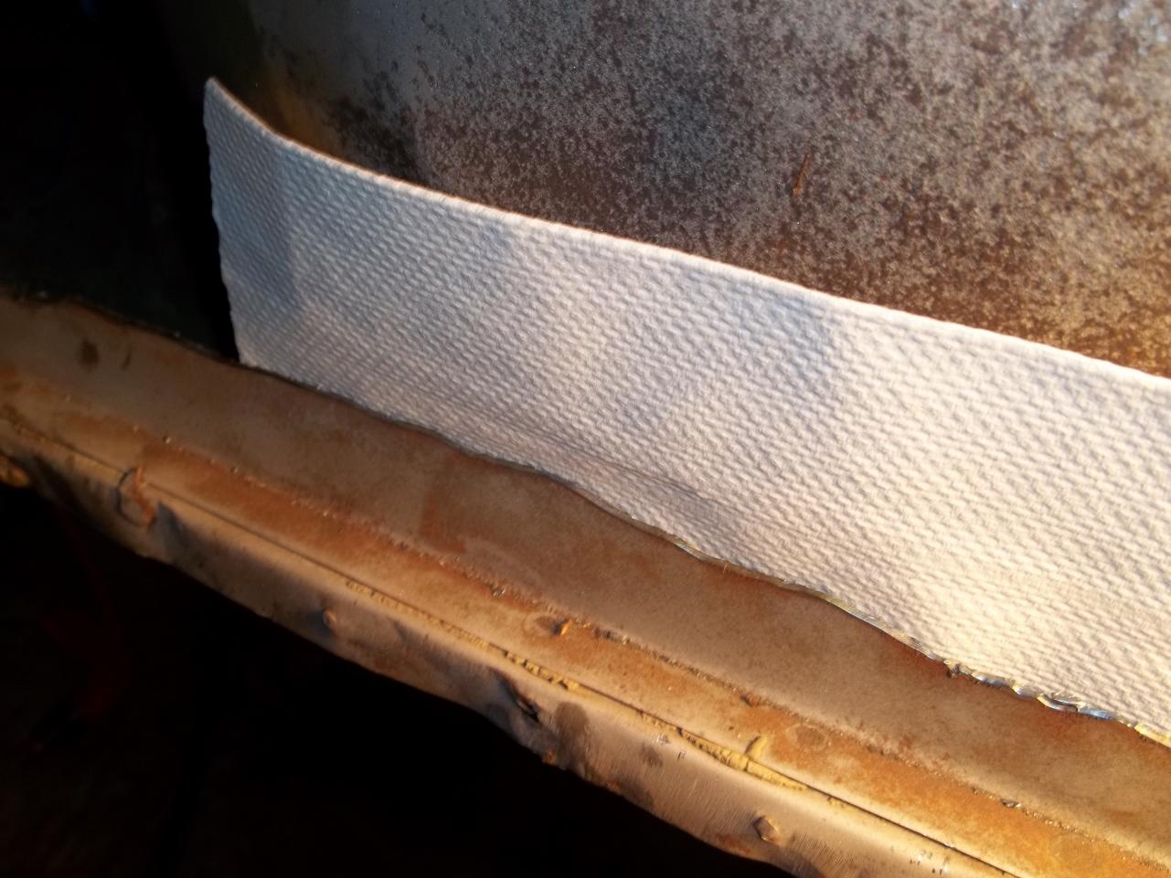

This shows a picture of my car upside down. Where the back lower panel is, on the picture it shows a paper towel in between where the spare tire well is and where the lower panel connects. The space is only big enough for the paper towel to fit in. Does anybody know how much space is between the spare tire well and the lower panel? The rear end had been pushed in from a wreck apparently. Thank you very much- TimZ
Tim, I did not get under my z and measure, but running my hand between the rear panel and the spare tire well, their is approx. two inches of space. Richard.
