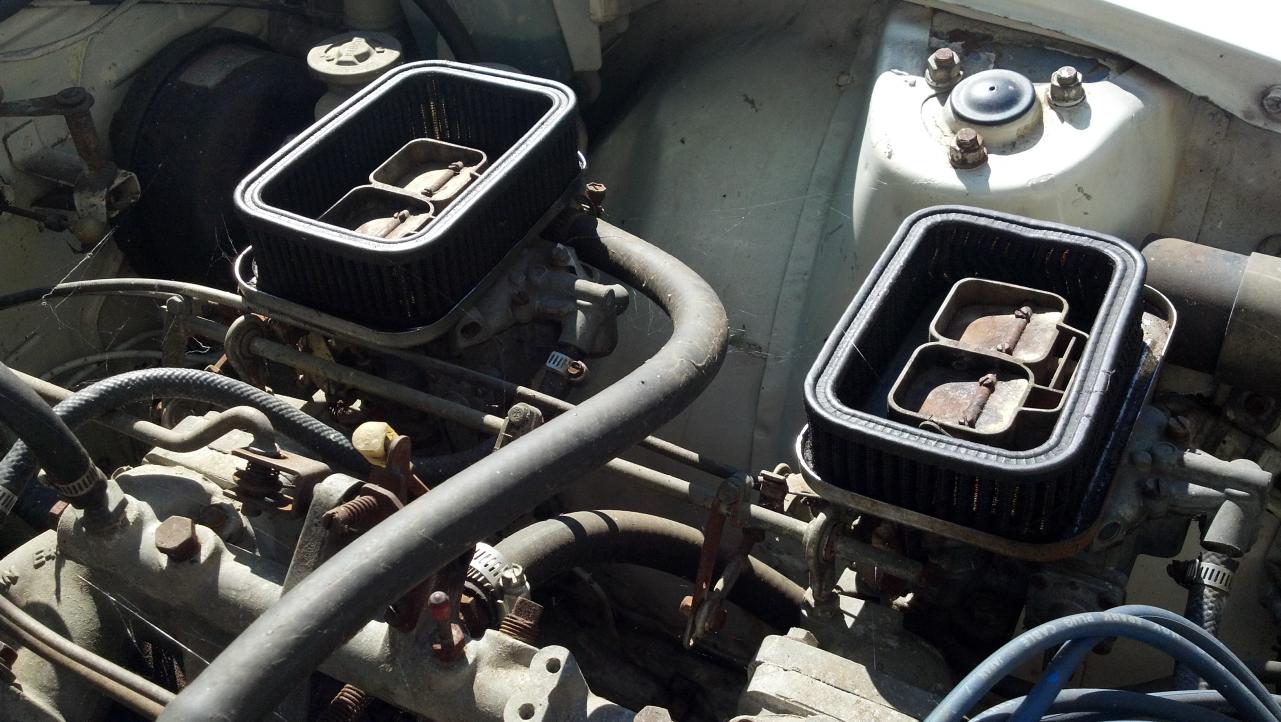

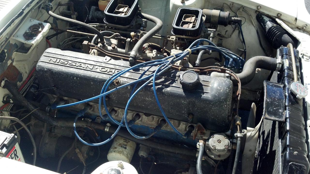

Posted June 15, 201213 yr comment_393124 Good Morning All, Picked up another 240z which came installed with Weber DGV's. I'll be having a motor built this Fall for it, which I'll pair with a set of triples, but for now I'd like to get the car back to running as-is. The car has not run since 2000. Aside from all the 'basic' tune-up stuff already done, I'm unacquainted with the DGV's. I've done quite a bit of reading on here, but my question is a bit more basic: I didn't get a chance to look into this too much last weekend - it's tomorrow's project. When I move the throttle linkage at the firewall, the butterflies on top of the carbs don't budge. Do these require engine vacuum or something to move? The motor is un-molested, and nothing appears to be missing or stuck. Thanks in advance, Bill Link to comment https://www.classiczcars.com/forums/topic/43540-basic-weber-dgv-question/ Share on other sites More sharing options...

June 15, 201213 yr comment_393135 Those are chokes for cold starting. They won't move until the engine is warm Link to comment https://www.classiczcars.com/forums/topic/43540-basic-weber-dgv-question/#findComment-393135 Share on other sites More sharing options...
June 17, 201213 yr Author comment_393291 Thank you both. Up and running. Link to comment https://www.classiczcars.com/forums/topic/43540-basic-weber-dgv-question/#findComment-393291 Share on other sites More sharing options...
