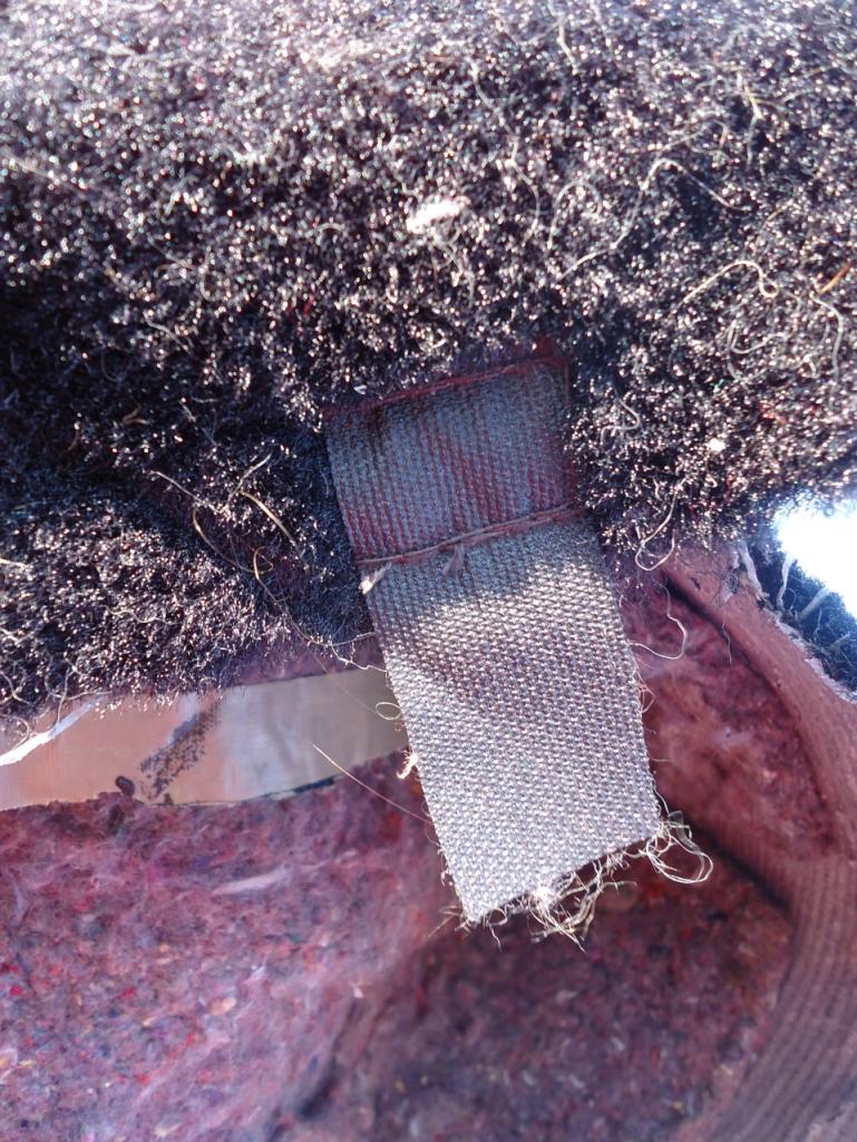

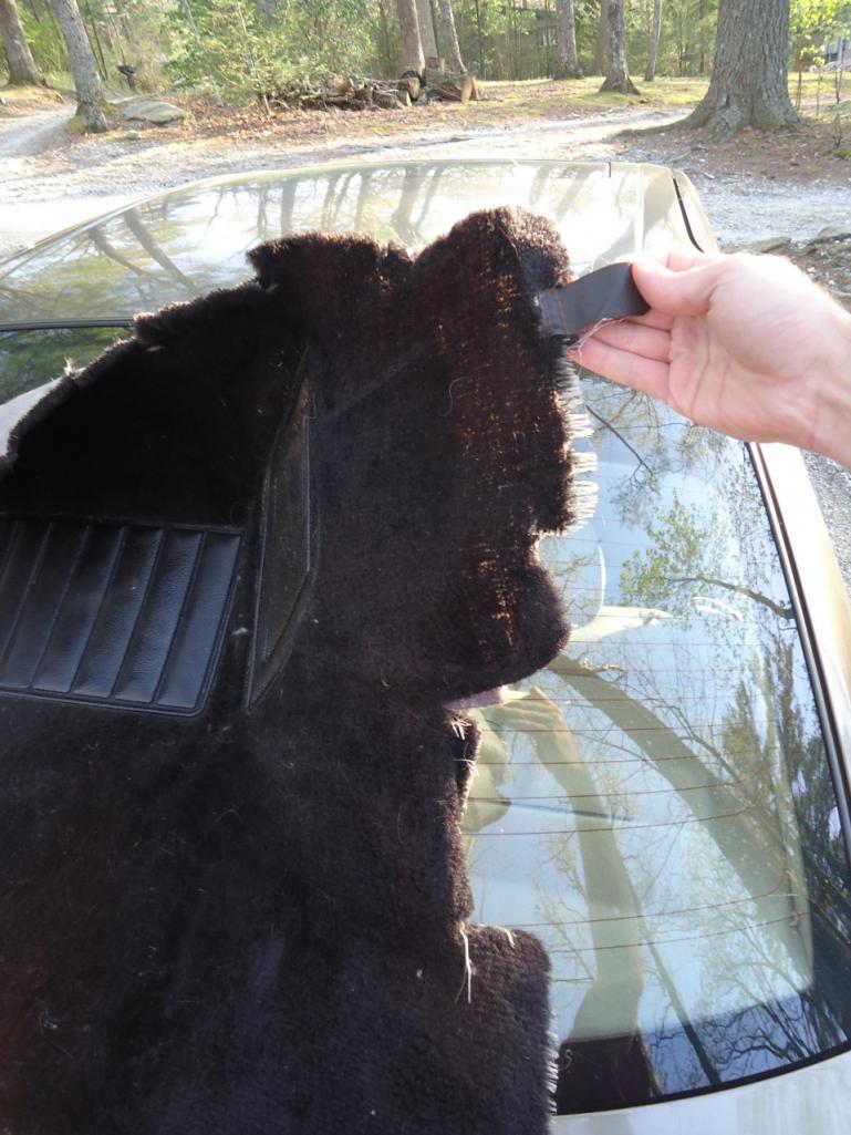

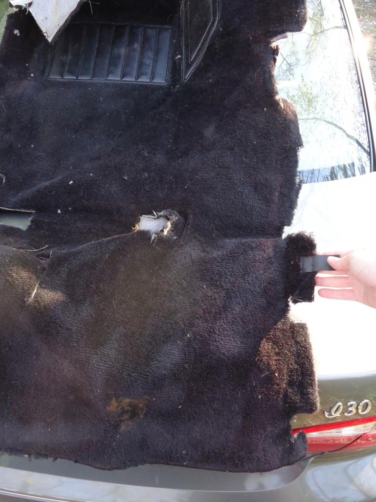

Just so happened that I had the drivers side carpet loose, so here are a few pics to show the velcro.

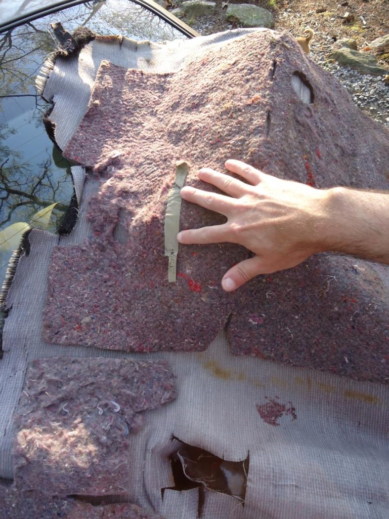

It appears to me that this was indeed original, as it's stitched quite well. There are two velcro tabs-the forward part straps across the area underneath the center console (holding radio), the rearward tab goes under the center armrest. Also, there were several strips of heavy duty tape holding the carpet to the floors-some of those strips, upon removal of the carpet, stayed with the carpet/padding (shown in photo), others were more attached to the car and chose to stay there (with some of the padding attached). No pics of that, as I cleaned that up some time back (when I recolored the carpets).
Driver side velcro has the hook component, passenger side has the loop/fuzzy part.
Passenger side has longer straps of velcro to go across the tran tunnel, as what you can see in these pics clearly won't bridge the gap.
