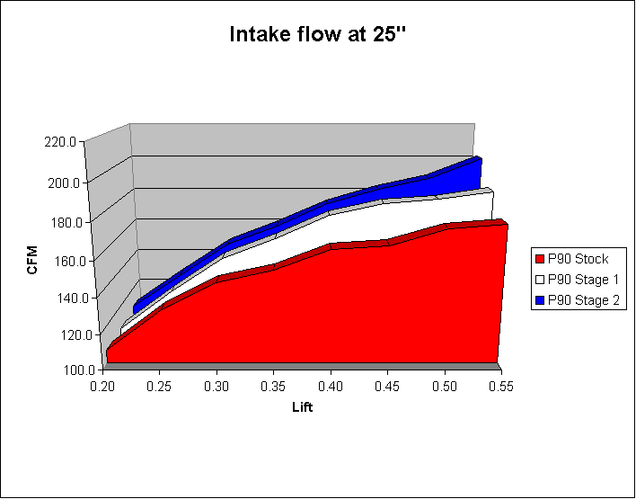

Any update? And what was the head flowing before the port work?
P90 head from BMC can flow 220cfm @ 0.55" at 25" of water:
