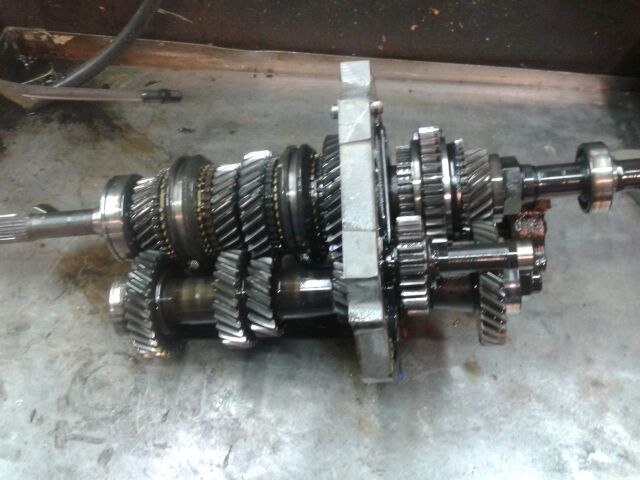

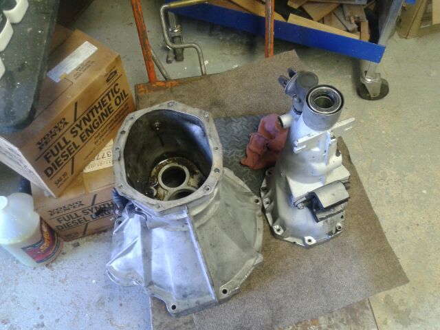

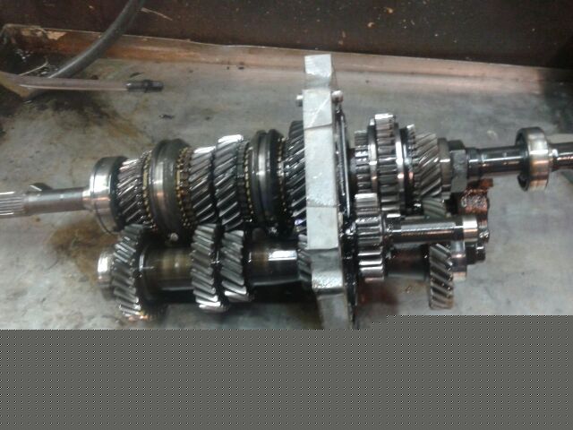

Got my buddy to pop my trans open and inspect it. I don't really know anything about the internals of a transmission. Going to replace some bushings and seals in it. It's going to be nice to have a 5spd in this.

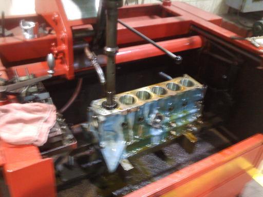

Tear down on the engine continues...

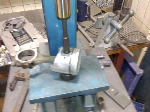

Pushing the pin out of the rods.

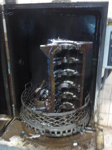

Hot washing the block. It was filled with old crusty oil, apparently the previous owner didn't believe in changing the oil.

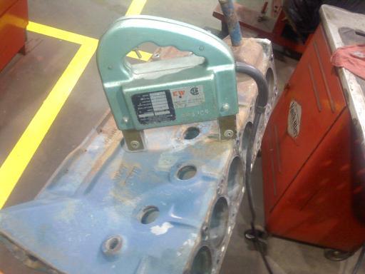

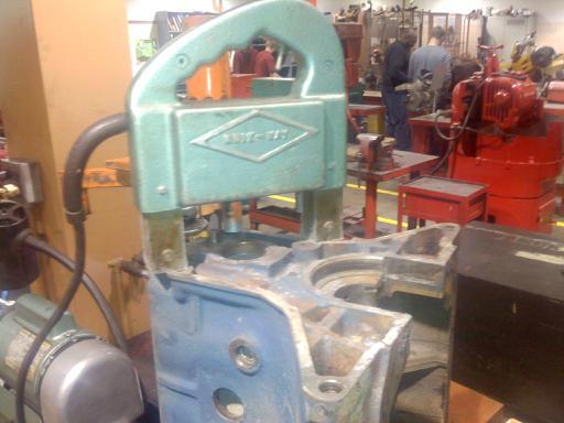

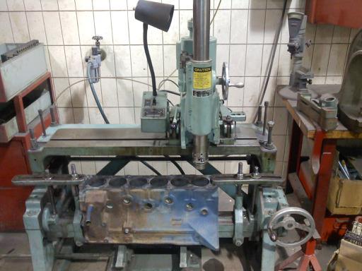

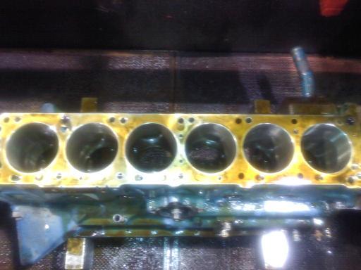

Also magnafluxed the block to look for any cracks, no cracks found.

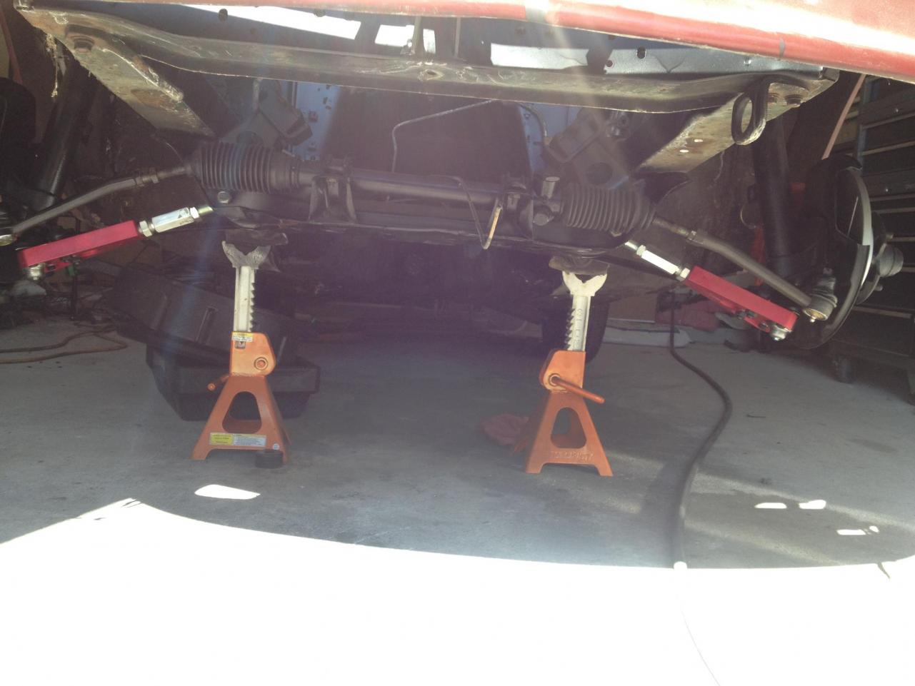

New (to me) Rack and pinion, adjustable control arms, Eibach lowering springs, slotted rotors, and 4 piston calipers. Still need to put the MSA sway bar on.

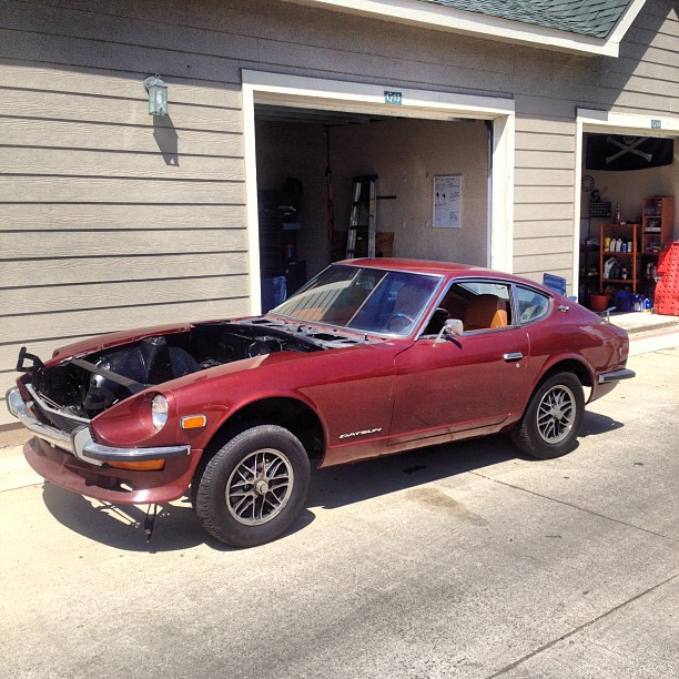

Rolled the car out, (can't remember the last time it's been on all 4 wheels), and gave her a bath to get all that garage dust off.
