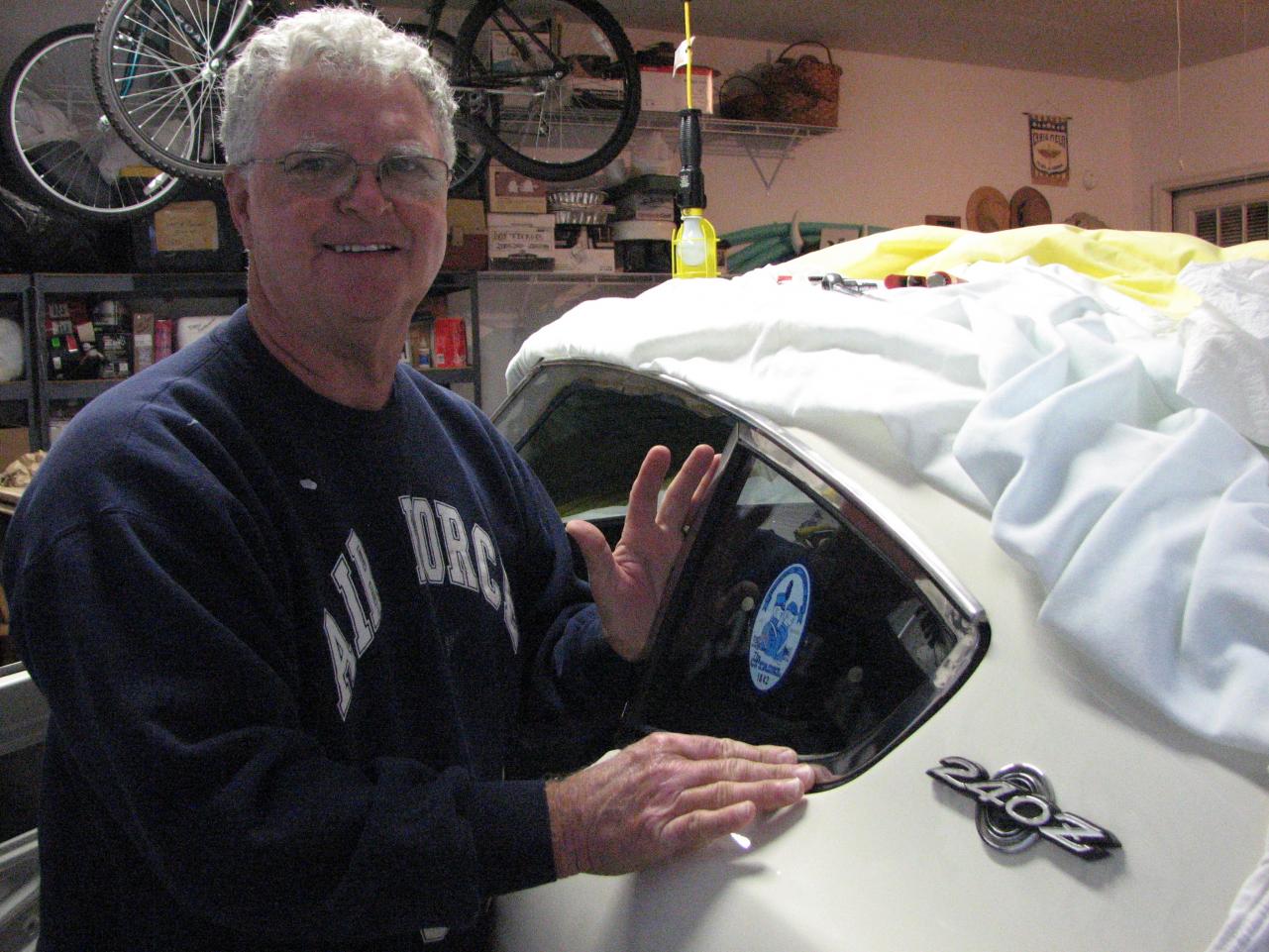

WDILL Posted December 18, 2011 Share #1 Posted December 18, 2011 Finally got the quarter windows in. What a pain with new rubber. Ordered brake lines from Black Dragon and completing fuel tank installation with new vent line from tank to filler neck. Diff, drive shaft and half shafts will be next. Link to comment Share on other sites More sharing options...
esmit208 Posted December 18, 2011 Share #2 Posted December 18, 2011 Keep going WDILL! You are almost there. Link to comment Share on other sites More sharing options...
240260280z Posted December 18, 2011 Share #3 Posted December 18, 2011 I found the quarters to be a 2 person job. 1 to push in and one to fix those wee screws. Some soapy water on the opening helps a lot.Sorry this info is late, but the next poor bloke doing the job may read this. Nice car! Link to comment Share on other sites More sharing options...
WDILL Posted December 19, 2011 Author Share #4 Posted December 19, 2011 I found your suggestions on prior post on the site and my wife volunteered to start the screws while I forced the window in place. Now I need to paint between the window and trim before I put the trim in. Link to comment Share on other sites More sharing options...
