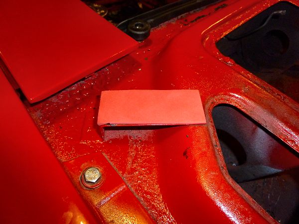

Sheet of red closed cell craft rubber 8 1/2" X 11" cut and glued to the bracket where the cowl sits... no rattle.
You can buy black sheets and do the rectangles where the hood sits in the inspection lids.
