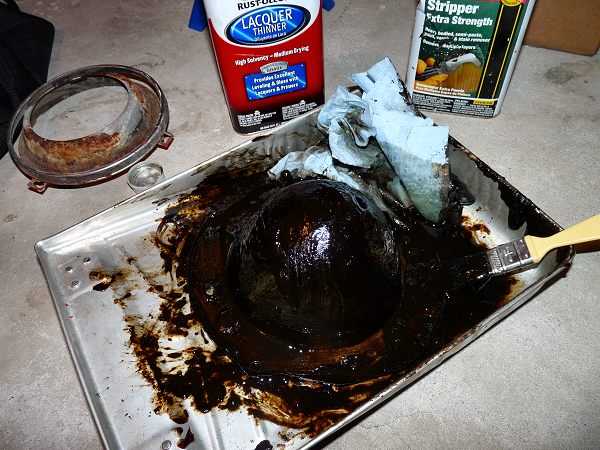

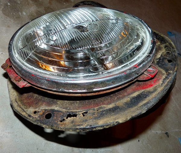

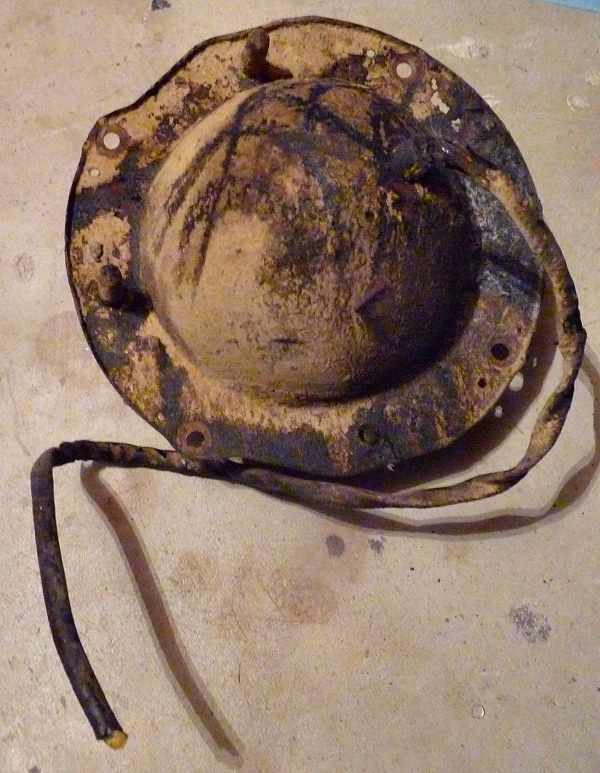

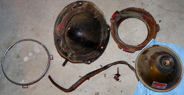

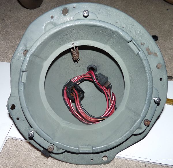

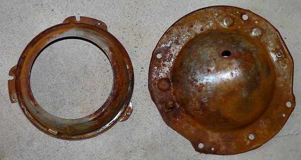

40 year old Ziebart is a @#$%
Wash with lacquer thinner, wipe out paint tray, redo.... many times.
Finally.... rusty metal

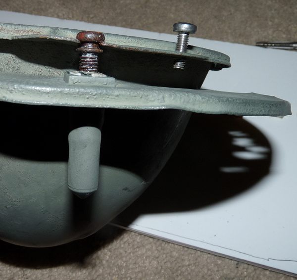

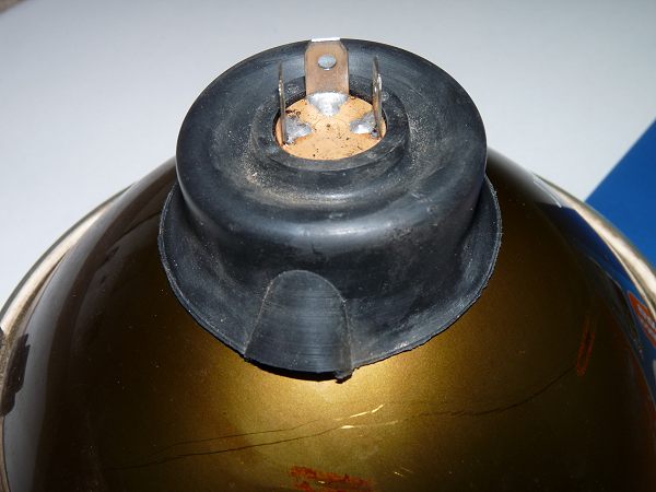

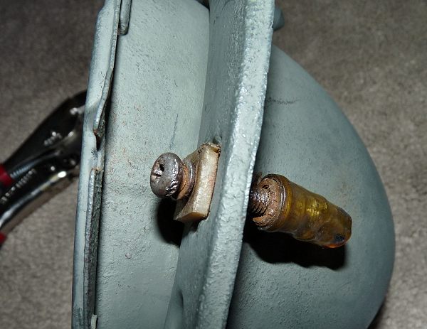

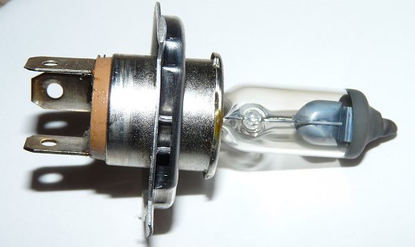

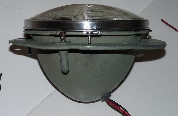

detail of plastic threaded insert. It has a clear rubber boot to keep the water out.
boot in place

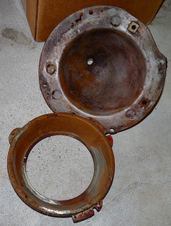

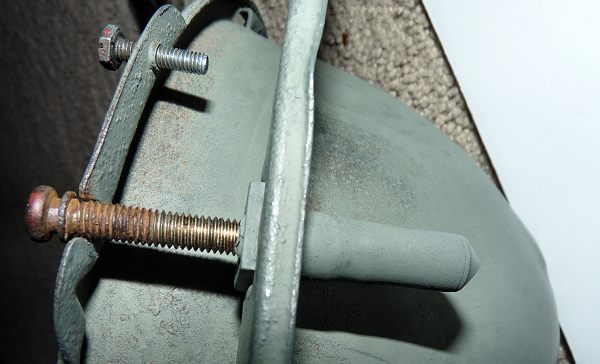

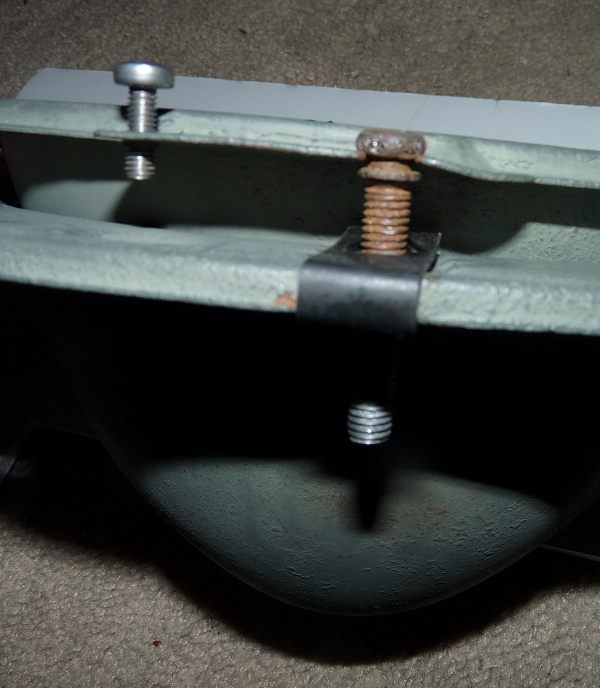

Substitute for a failed nylon adjuster nut

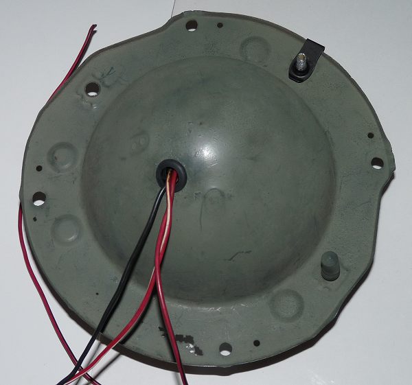

Here is the working one(covered in etching primer):
As the screw turns the light casing moves. Lithium grease helps lube the plastic. I never chased the threads yet.

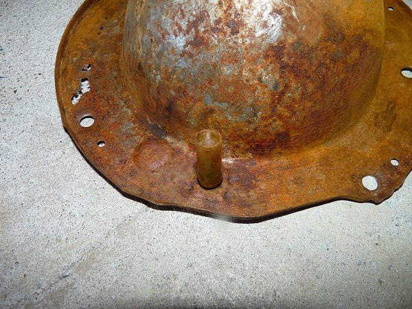

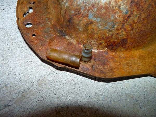

Here is the broken one
Details of the broken fastener

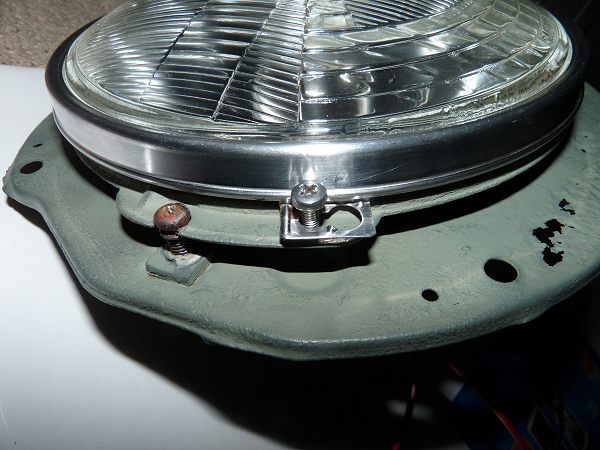

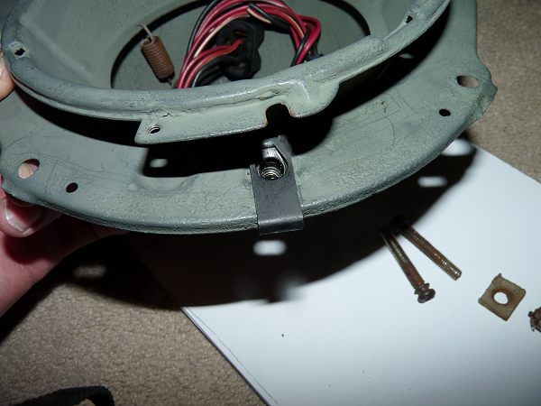

Solution: Ace Hardware SAE nutsert and am M6 1.0mm tap.
Taps easy... the one in foreground is tapped and is now metric
Fits nicely

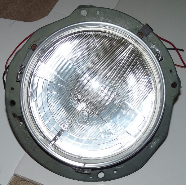

Done!
