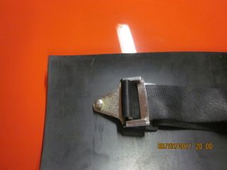

Steve,
Looks like this:
Chris
I went to a local car upholsters' shop and asked if they did seat belts. They did, and had black webbing in stock. Quoted a price of $15.00 and that it would be done by day's end, a little over two hours at this point. I returned around twenty minutes before closing, and they had it done. In fact, they had two done as the person who worked on it inadvertently had cut off the "good" side that I had left as a model. Their bad, my gain, as I got both for $15.00. I have the non-retractable type and reused the original hardware and can't believe how much more snug the shoulder belt feels. As far as I know, its never been in a major accident, so the stretching or slack in the old shoulder belts must have been simply due to a million little tugs over their lifetime. I think I'll have them do the lap belts next Monday. If you have an older Z (or any car, for that matter), have the belts replaced, I think you'll find it worth the money, even if you don't get quite the 'deal' I did.
