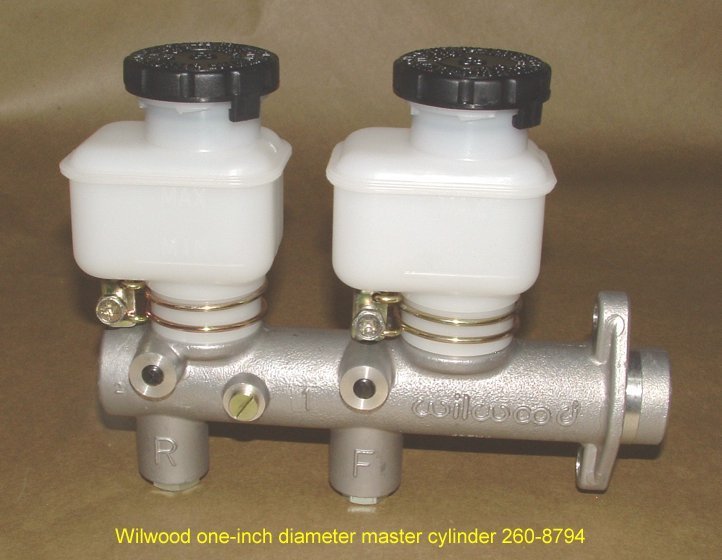

I am betting there are a lot of crossover parts from many Japanese manufacturer's suppliers. Take, for instance the direct bolt on of Sumitomo 4 piston brake calipers for a Toyota that can replace the Sumitomo 2 piston calipers on a 2X0z.
I recently swapped 280zx rod and clevis to that on a 2007 Rav4.
Just did some digging:
46010-45P00 Manufacture date 9/91 – 9/93 (1" NA TT Tokico)
46010-45P00 Manufacture date 2/91 – 9/91 (1" NA & TT Tokico)
46010-45P20 Manufacture date 9/91 – 9/93 (1" NA & TT Nabco)
46010-45P20 Manufacture date 9/93 – Up (1" NA & TT Nabco)
Looks like some of these have 3 side fittings (the third is for ABS system). Some mods are required to make it work.
Edited by Blue

It’s the Wilwood one-inch master cylinder. Wilwood part number 260-8794.
The Wilwood master requires modification before you can use it on a S30, but the Ebay ad states that the one they are selling has been modified.
