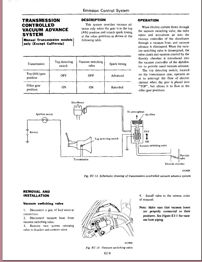

May 26, 201114 yr comment_356922 I'm trying to find info on what that vacuum switch solenoid does, when i get the car started ill check out what it does with a multi meter Here is a picture from the FSM. You can see that the wire to the transmission switch is powered when the key is On. Apparently the trans switch is normally closed, so the solenoid is powered in gears 1-3, blocking the vacuum passage to the distributor. In 4th gear, the switch opens, power is cut to the solenoid, and vacuum is applied to the vac advance. If the solenoid doesn't have power, you will have full time vacuum to the distributor advance. So if you don't have the wire to the solenoid, you really don't need to do anything except watch out for the other loose wire end from the trans, which will have power. Or take everything off and connect the vacuum hose directly to the vacuum advance (with one loose wire still to worry about). Edited May 26, 201114 yr by Zed Head Link to comment https://www.classiczcars.com/forums/topic/39650-requesting-dizzy-wiring-photos-been-searching-multiple-forums-for-hours/?&page=2#findComment-356922 Share on other sites More sharing options...
