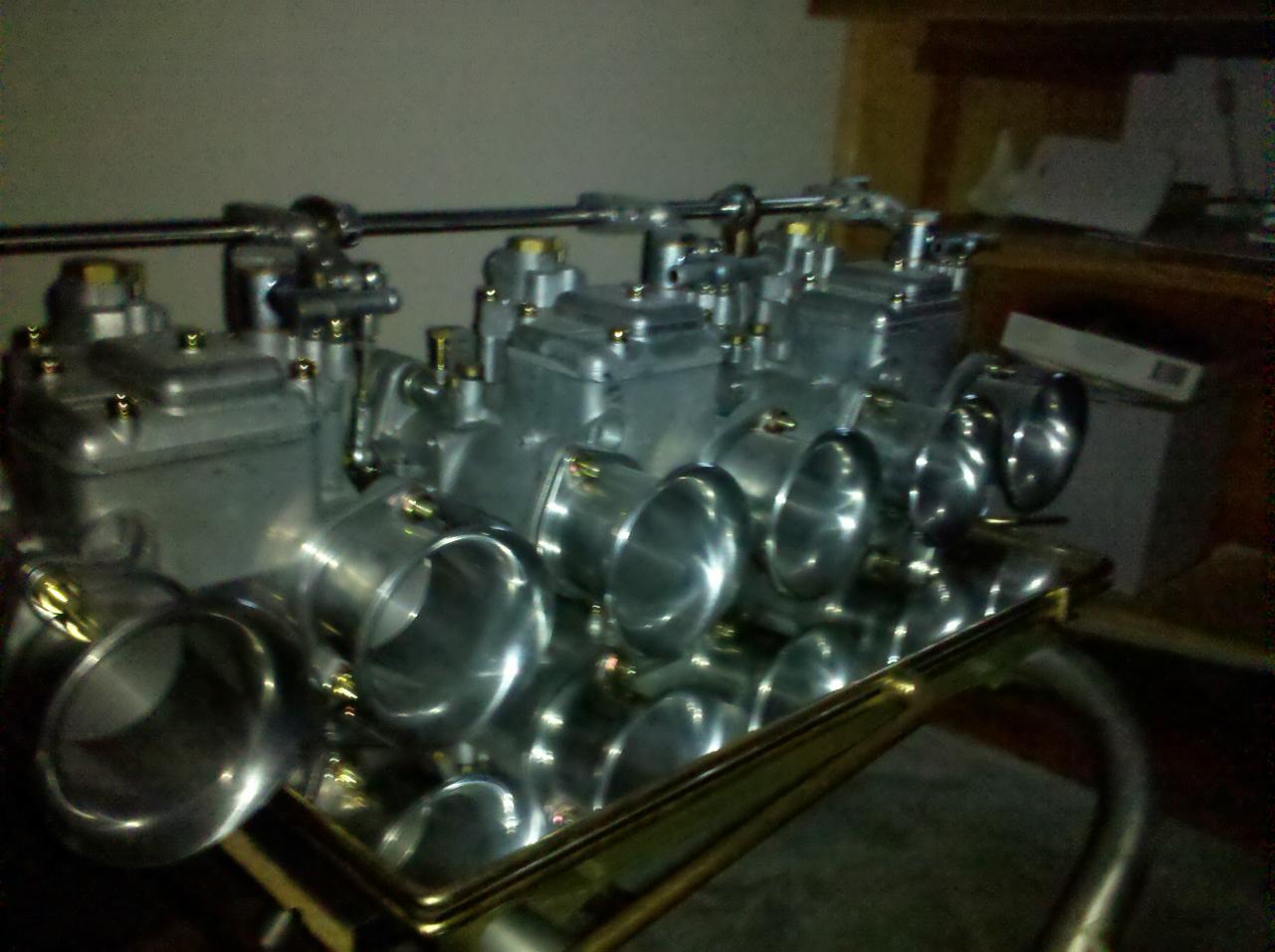

I have considerable experiance tuning holley carbs on v8's. What manifold do you consider the best for spirited driving on the street and the odd track day, the clifford or the arizona. my engine is an l28 with e31 head with large valves and ported with 9.5 compression stage II cam, header and hei ignition. My current set up is 4 screw round tops. When they are rich enough to run at speed they are to rich at idle. I am looking at different options such as 4bbl conversion or a su tbi conversion that Tony has told me about. The weather is getting nice around here so i gotta make a decision soon. Any advice would be great

Bob,get the roundtops running correctly-they are superior to any "down draft" set-up.Or the FI depending on your cam.
