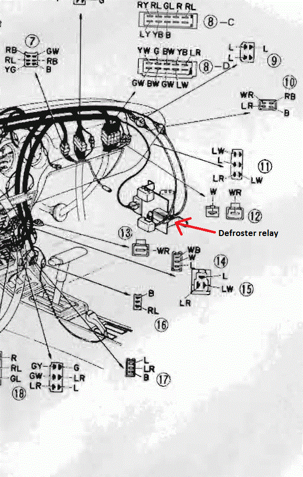

There appears to be a relay in the actual wiring that does not appear in any of my wiring diagrams. A very nice 14v appears at the hot side wire to the grid when I turn the switch, but it then cuts off and goes to zero. I can hear the relay, but can't tell which one is clicking by touch. If I power cycle the switch power returns again at the grid for a moment.
So, I suspect the relay has intermittent contact. Its kind of a PITA to get the relay board out as it partly blocked by the A/C added in, in front of it. Anyone know which relay is the culprit?

My 1973 FSM shows a Rear Window Defroster Relay in the Body Electrical (BE) Section, pages BE-5 and BE-6, for Manual and Automatic Transmission, respectively.
You could bring the car over to my house tomorrow or next weekend. and we could dig it out.
Look at page BE-3. The connector is the one on the far right of the dash. There is an arrow going to #10. If you trace that wire, you'll see it go to the relay on the right side of the board.

Thanks to both of you. I see whats going on now. I have also found that the fuse is an inline behind/under the radio, so I think first thing is to dig it out and clean and retension those connections.
