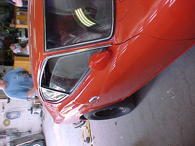

about this swap I believe this is possible if you are attempting 2 seater to 2 seater I just trashed my two 06/73 doors and fitted a pair of 4/77 doors, yes the lock mechs had minor updates and changes to attach hardware, the lock barrels were different. I removed all the mechanicals cleaned and lubricated and then selected the best set of hardware out of both door sets and matched it up , I selected both of the older latch assemblies, and had zero problem the door operation after completion of the work. I recommend get the best doors you can buy then make it happen when you are ready. I paid $500.00 (AUS) per door for the two I got, and the shop spent a further four days on each shell, now they are perfect.
